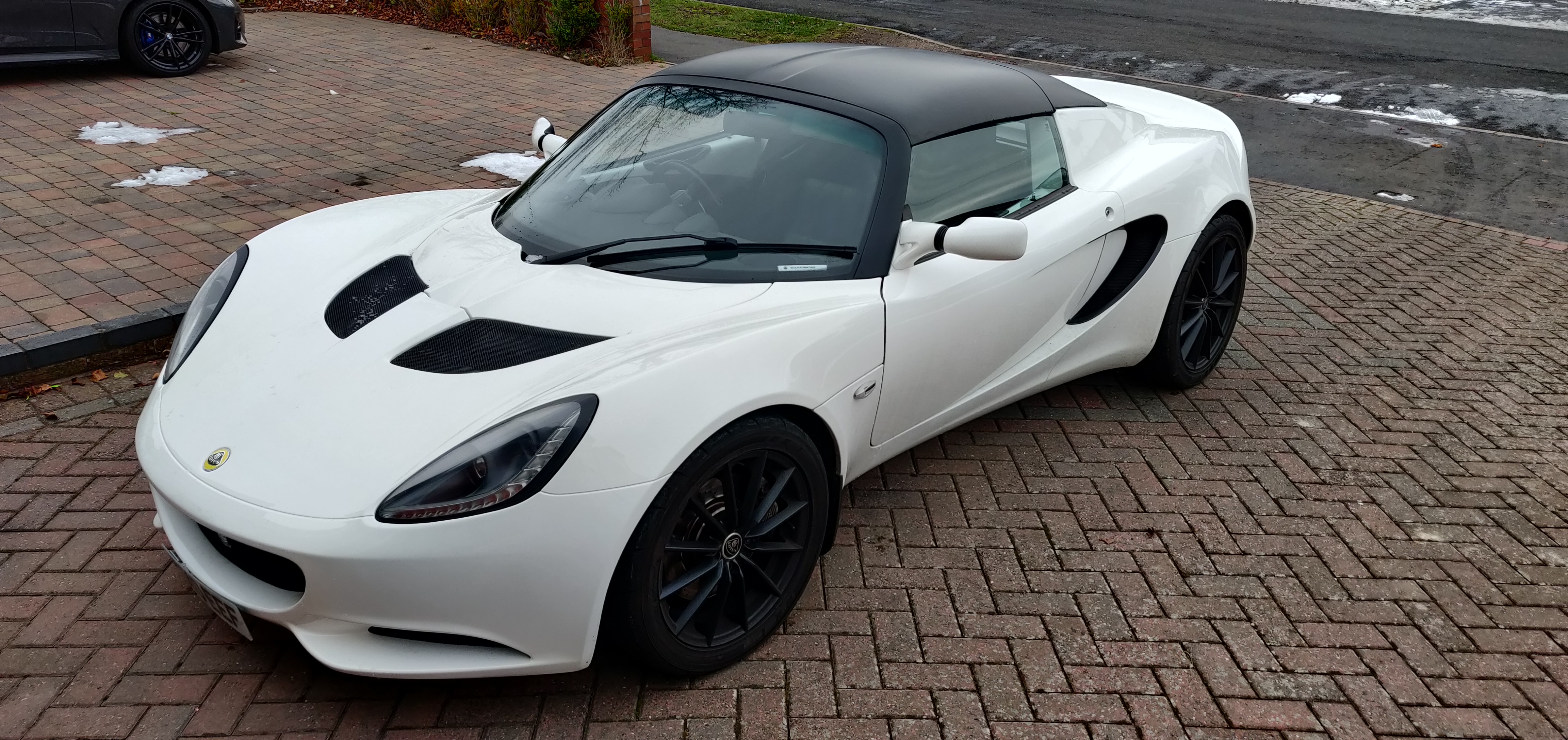

So ive had my elise (1.6) since Aug and been enjoying it alot! As time has gone on ive noticed some bits id like to sort some aesthetic and some mechanical. Im located south Birmingham (Halesowen) so some recommendations of good people in the area would be ideal!
1. The front cover panel (just below window wiper). Should this be screwed down into place? As it looks like it should but the screw is missing. Along with a washer and nut holding the metal L bracket underneath 😅
2. There is no paint protection on the front clam at all and this is something i think i needed. But for paint work thats 11 years old its not too bad but theres a hand full of small dings in the paint that need sorting before any protective film can go on and the existing films need replacing. (wing mirrors and rear sil area).
3. This might be tied to point 2 but rims and brake calipers would be good painted too! The rims already matt black but after the last wash some paint flaked from the back of a few spokes so in time it will just get worse!
4. As its the 1.6 version i been looking at slight performance gains and an easy one looks like the exhaust upgrade. I think it has a larini back box (only) already as its loud! But dont have the paperwork to support it. Its not stock i know that! Is it worth pursuing the exhaust upgrade or even a remap or both. Dont mind spending abit of money on the car as its my daily at the moment and think its too loud for track anyway.
5. Sound system is definitely dire. Thinking of a new head unit and upgrading the speakers. If anyone has any tips they would be most welcome. I dont want a sub or amp. Space is limited already 😂 and i do try to listen to music where i can. Im just greedy with the sound of the car and music. Cake and eat it as they say 🤣
6. LED headlights. Stock a weak in the dark. Anyone know who can do an LED upgrade. I dont have a garage or anything as such to take the clam off and mess with the headlights. 😔
Sorry its a long post! Any help guidance would be most appreciated!!
