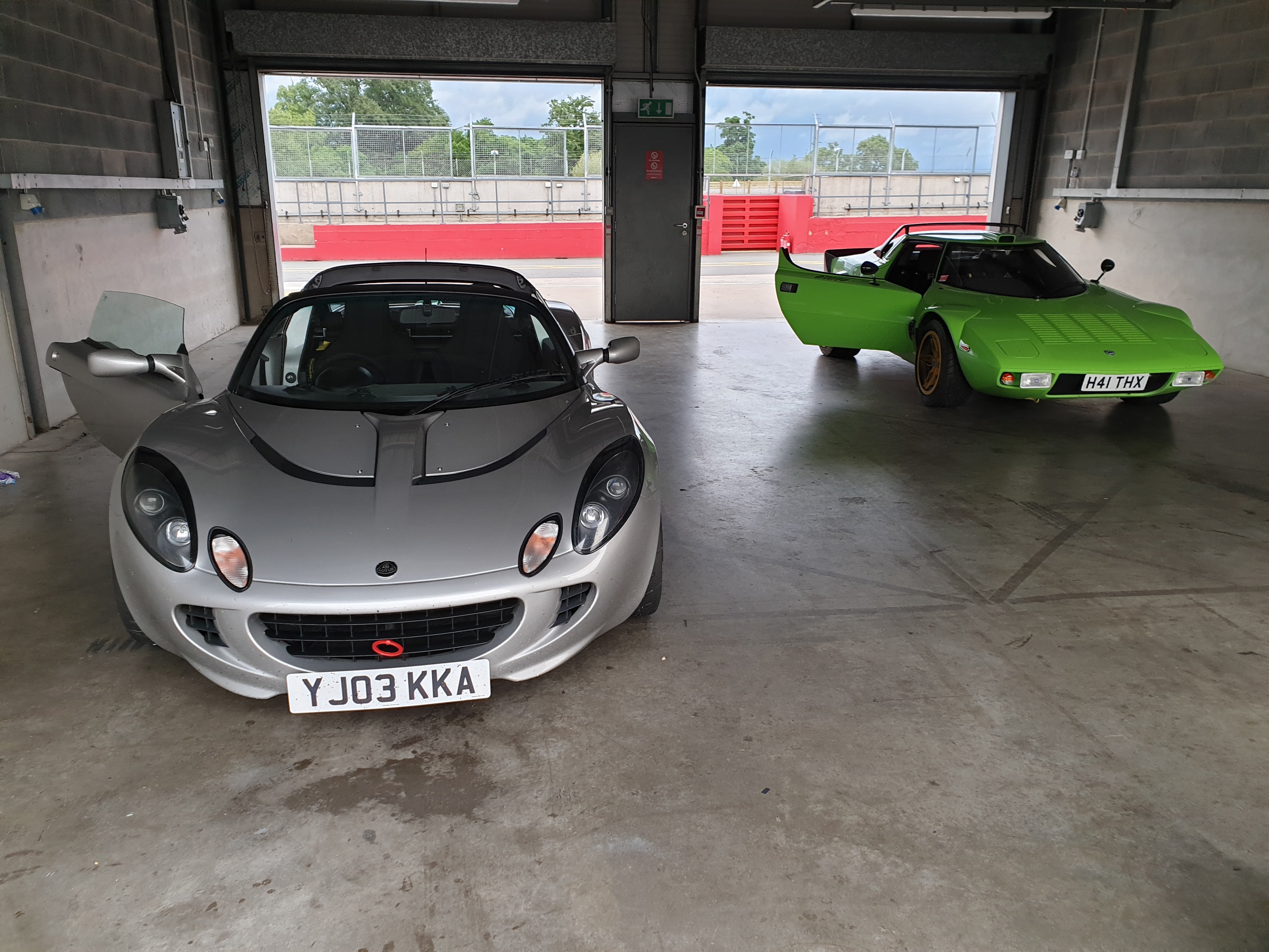

Posted
Nice! Looks like mine.....but that one's finished......
Any idea who it belonged to?
