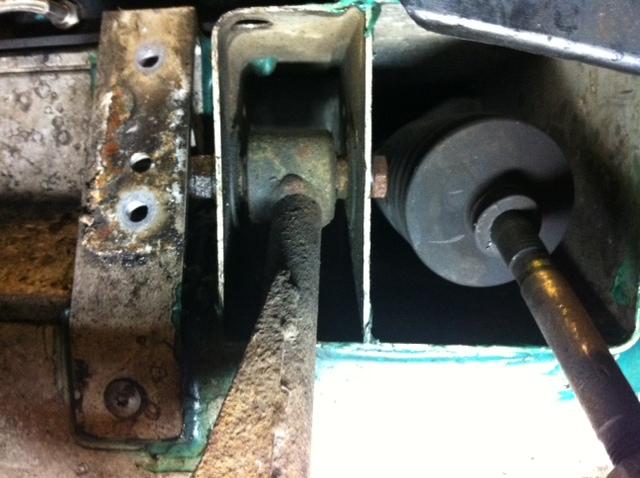

I have managed to remove all the wishbone bolts, apart from one. This is the upper inner bolt that runs through the steering rack channel. The problem is, the bolt head is in the channel and to remove it, it seems that I would have to remove the steering rack? That cannot be right? Is my bolt facing the wrong way?

Picture to demonstrate issue 2...
Been back to the garage and just figured out issue 2. I needed a break I think and warmed up the brain.
On full lock, I can just about clear the bolt! I think. I will see what I get back on the tools.
