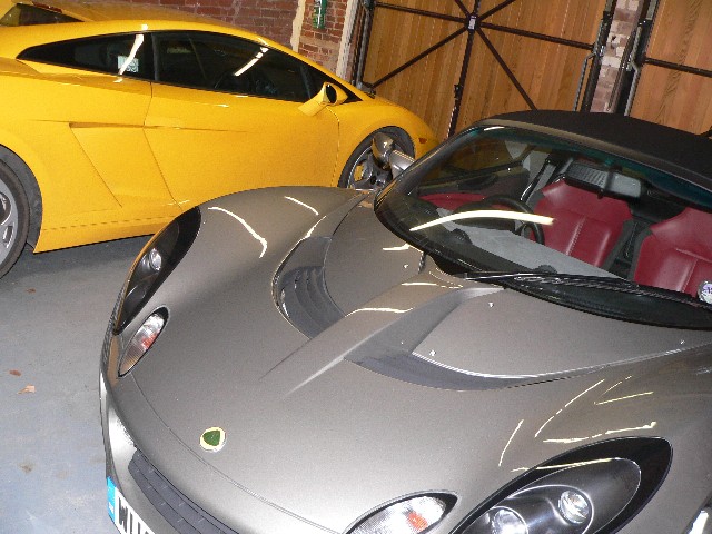

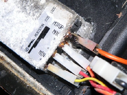

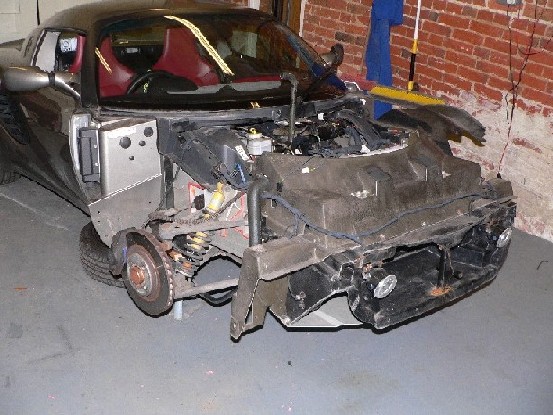

What you need to do is take your nice car which looks like this.....Take about 4 hours, some spanners, allen keys and a few grazed knuckes and reduce it to this........wrestle the fan out of it and you'll find the resistor pack underneath soaking in water looking burned out and a bit like this......... Then simply re-build it!
It's actualy not that hard, just a bit daunting lifting the clam off, needs 2 people for sure!
