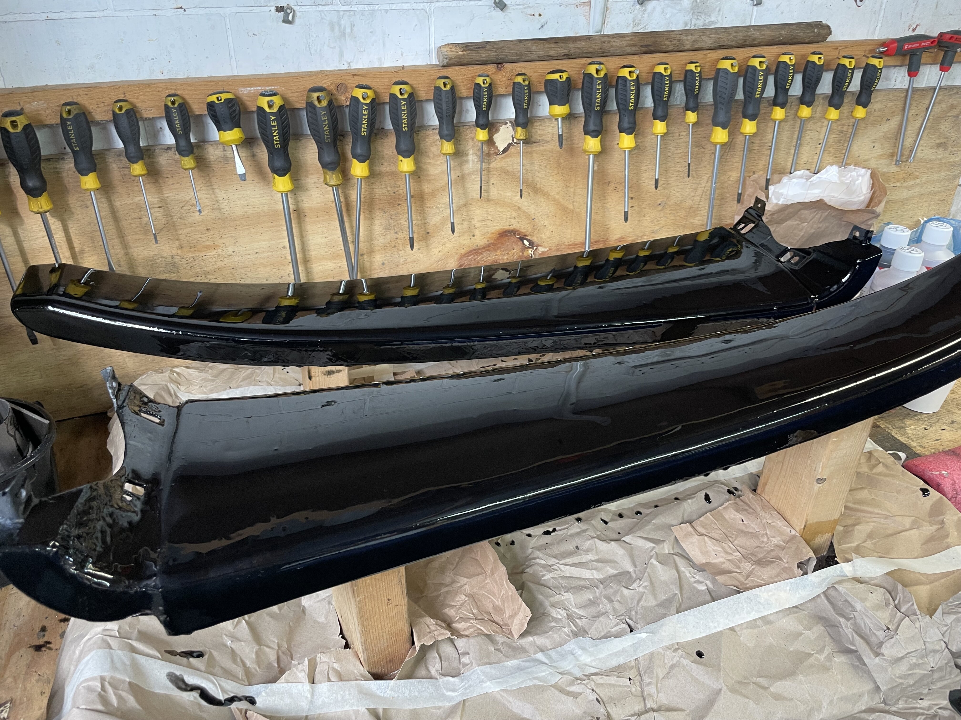

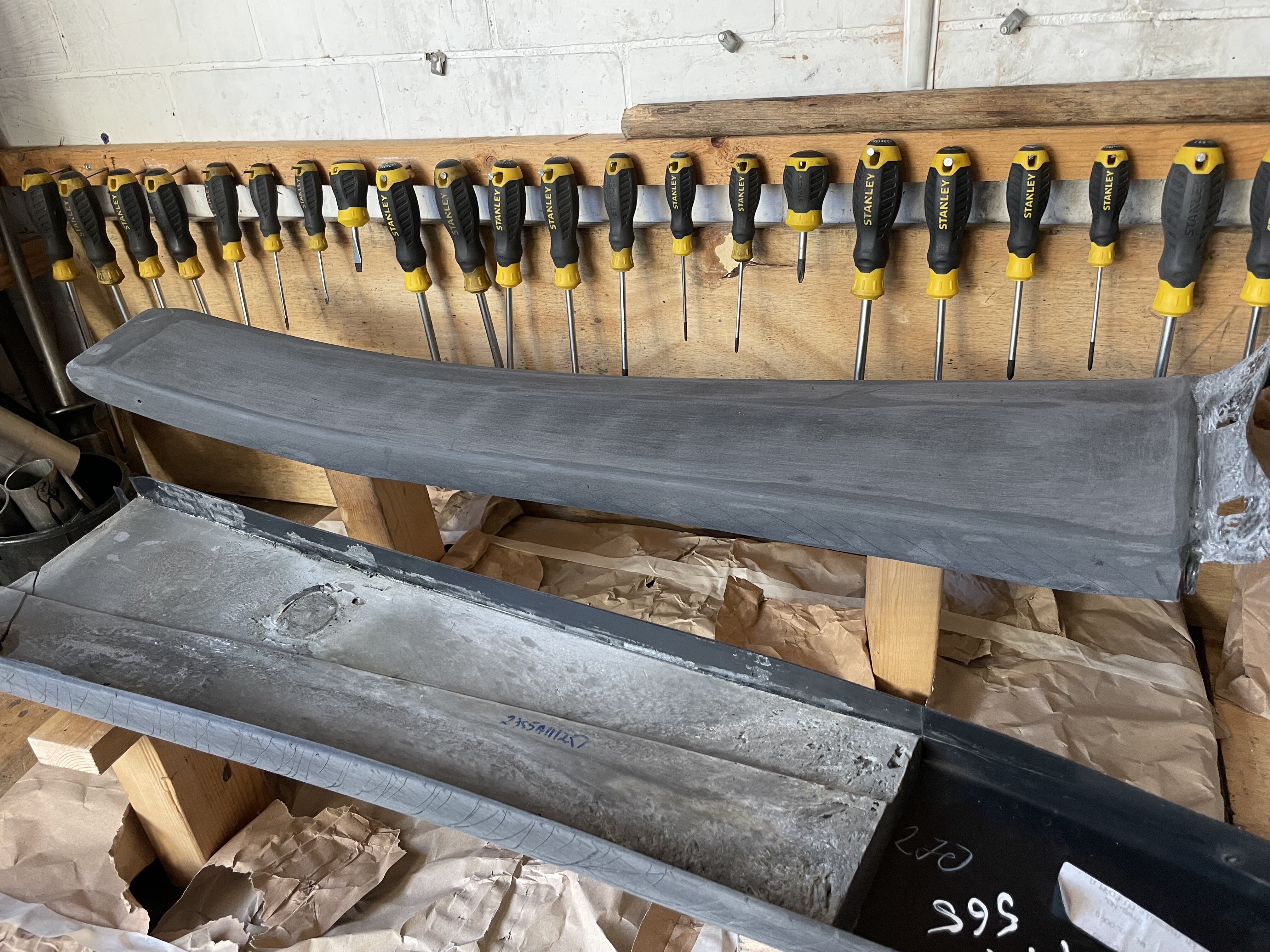

Andy wright Posted Tuesday at 17:07 Author Posted Tuesday at 17:07 As it turns out, fell at the first hurdle as my spare set are both for the passenger side. So, out with the angle grinder and flap wheel. Twenty minutes later hours of carefully applied carbon fibre and resin are no longer attached to the sill cover( in fact, once I had completely ground back the edges to bare plastic, the whole top section lifted as one strip with the aid of a broad chisel. ) . Anyway, both covers now sanded with 40 and then 80 grit and now more or less ready for the black epoxy resin coat and the carbon fibre matting . Quote

Andy wright Posted Wednesday at 09:15 Author Posted Wednesday at 09:15 Got the mirrors . No gear surround as the shifter is exposed. Carbon door cards but managed to sell the leather and Alcantara ones for the same price so that purchase was carbon neutral ( whoops, I meant cash neutral) . Round two of the door sill covers is progressing much better. I have used/ am using a product from XCR which is much less viscous than the Mouldcraft product I used last time. And with better results so far. The base coat has gone one on a treat . Quote

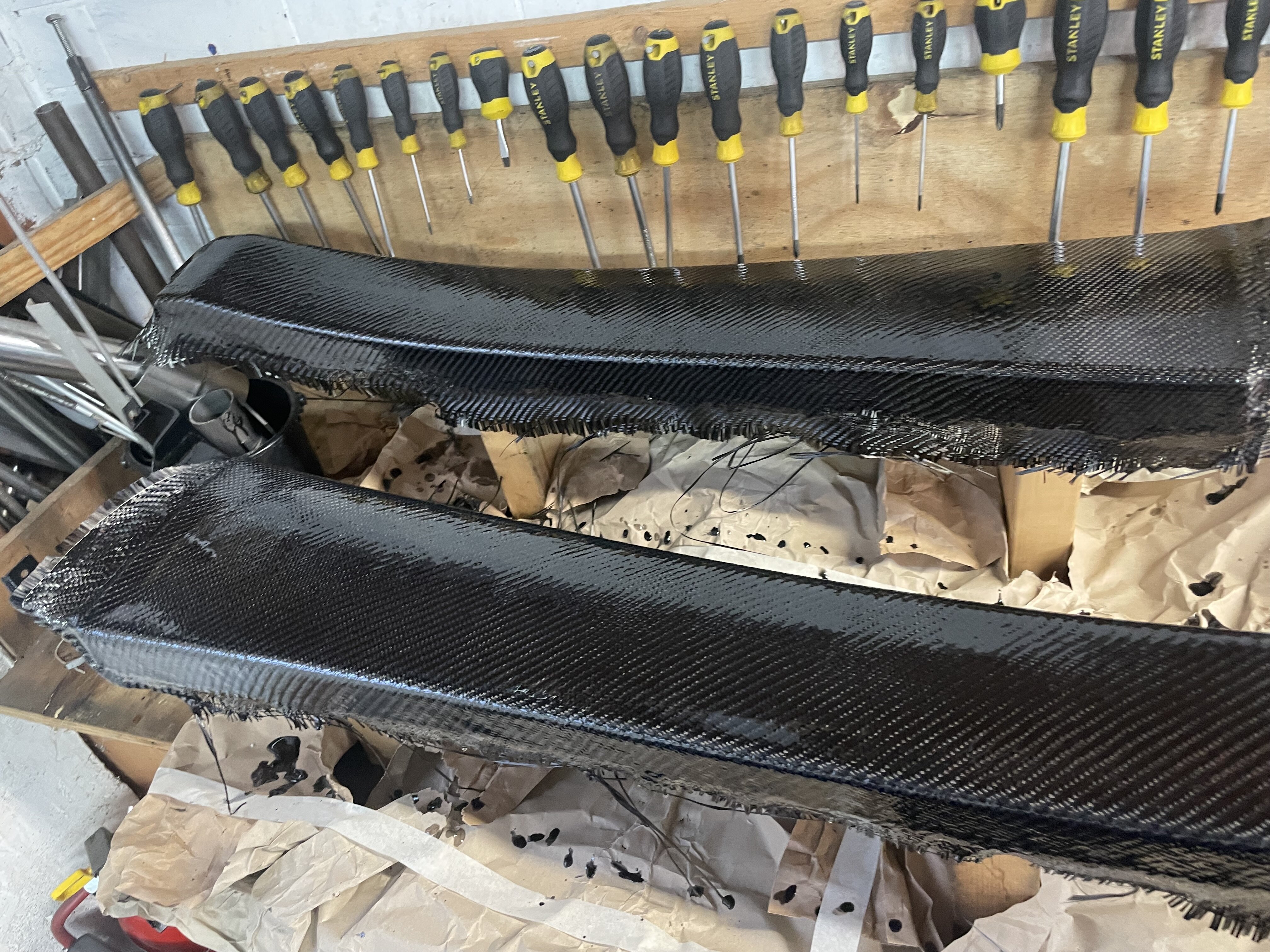

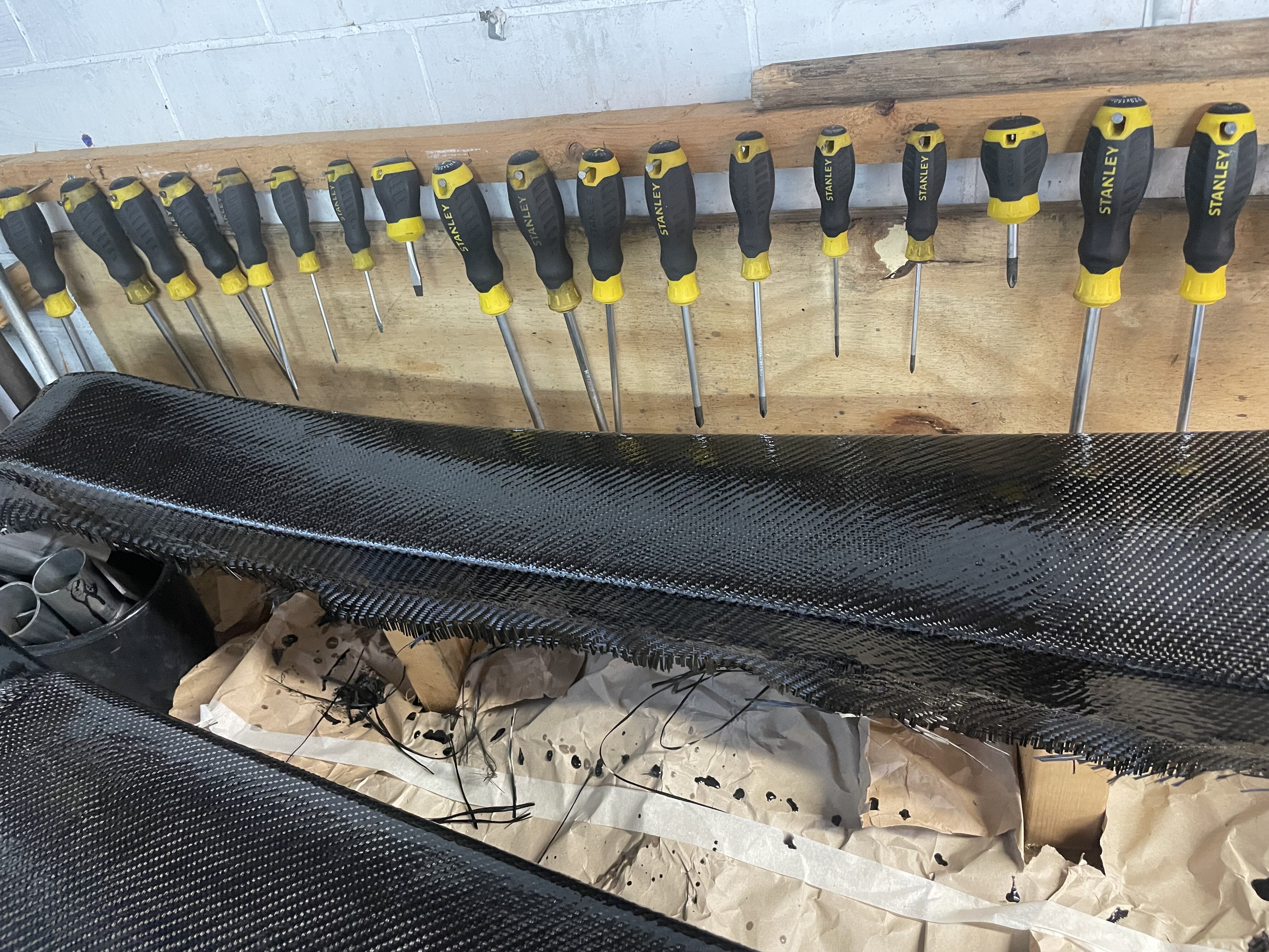

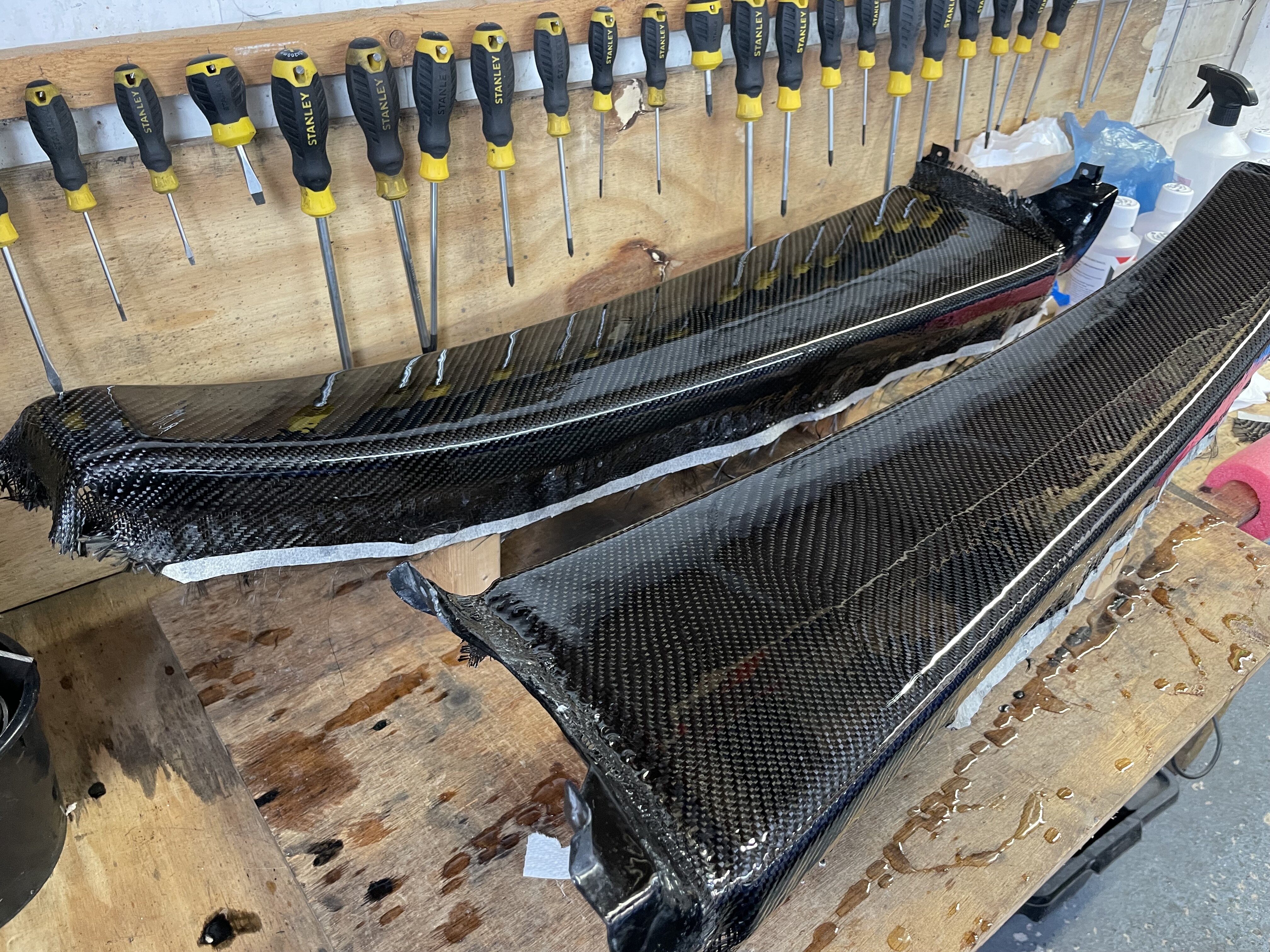

Andy wright Posted Thursday at 08:46 Author Posted Thursday at 08:46 And now with the matting firmly stuck to the base coat and two coats of resin later . More to follow Quote
MG4Lotus Posted Thursday at 14:53 Posted Thursday at 14:53 Not so sure about that finish. Maybe you should start again. 😜 Quote
Andy wright Posted Thursday at 18:26 Author Posted Thursday at 18:26 Think you are right. Bin time 😀😀😀😀 1 Quote

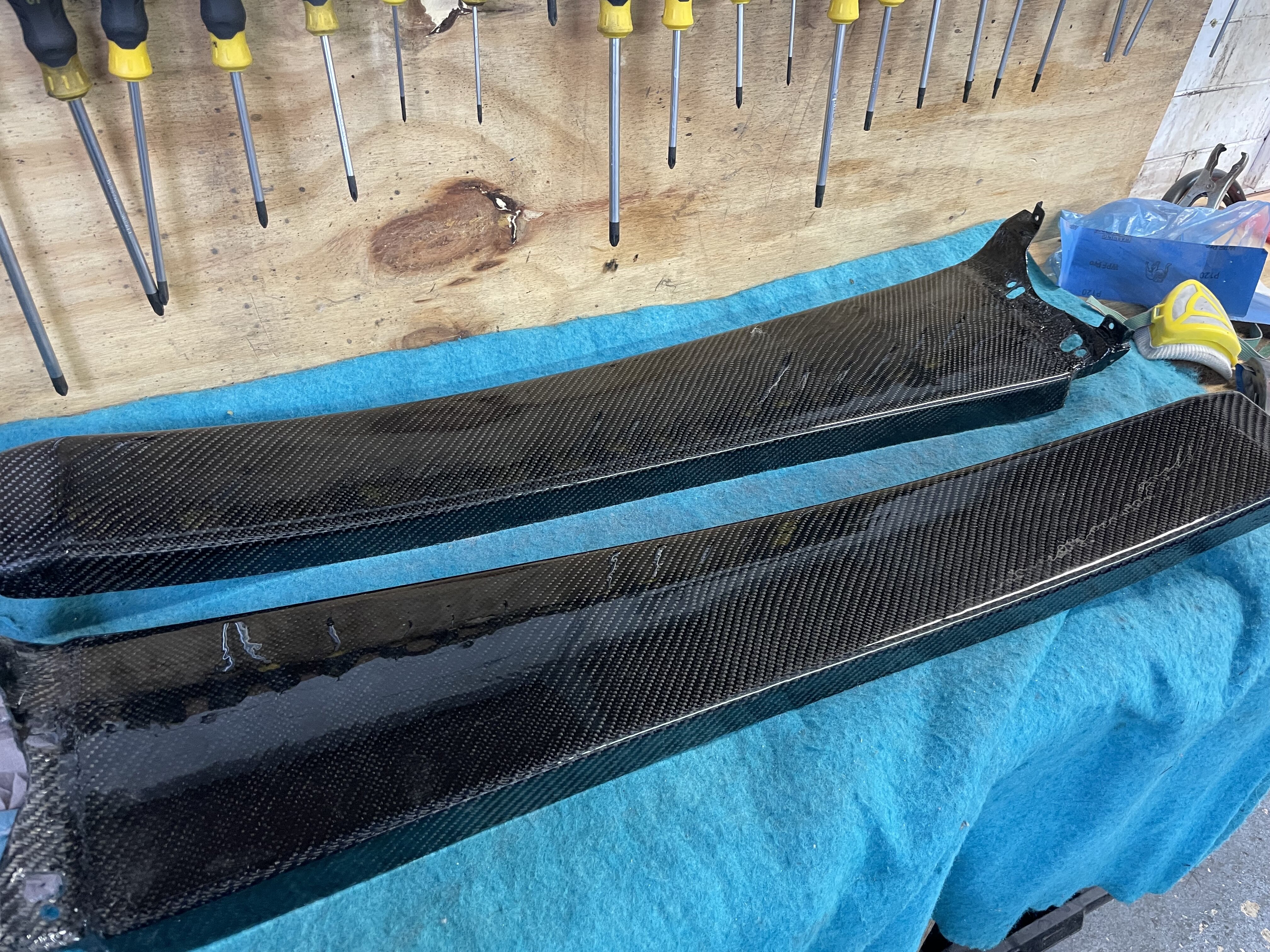

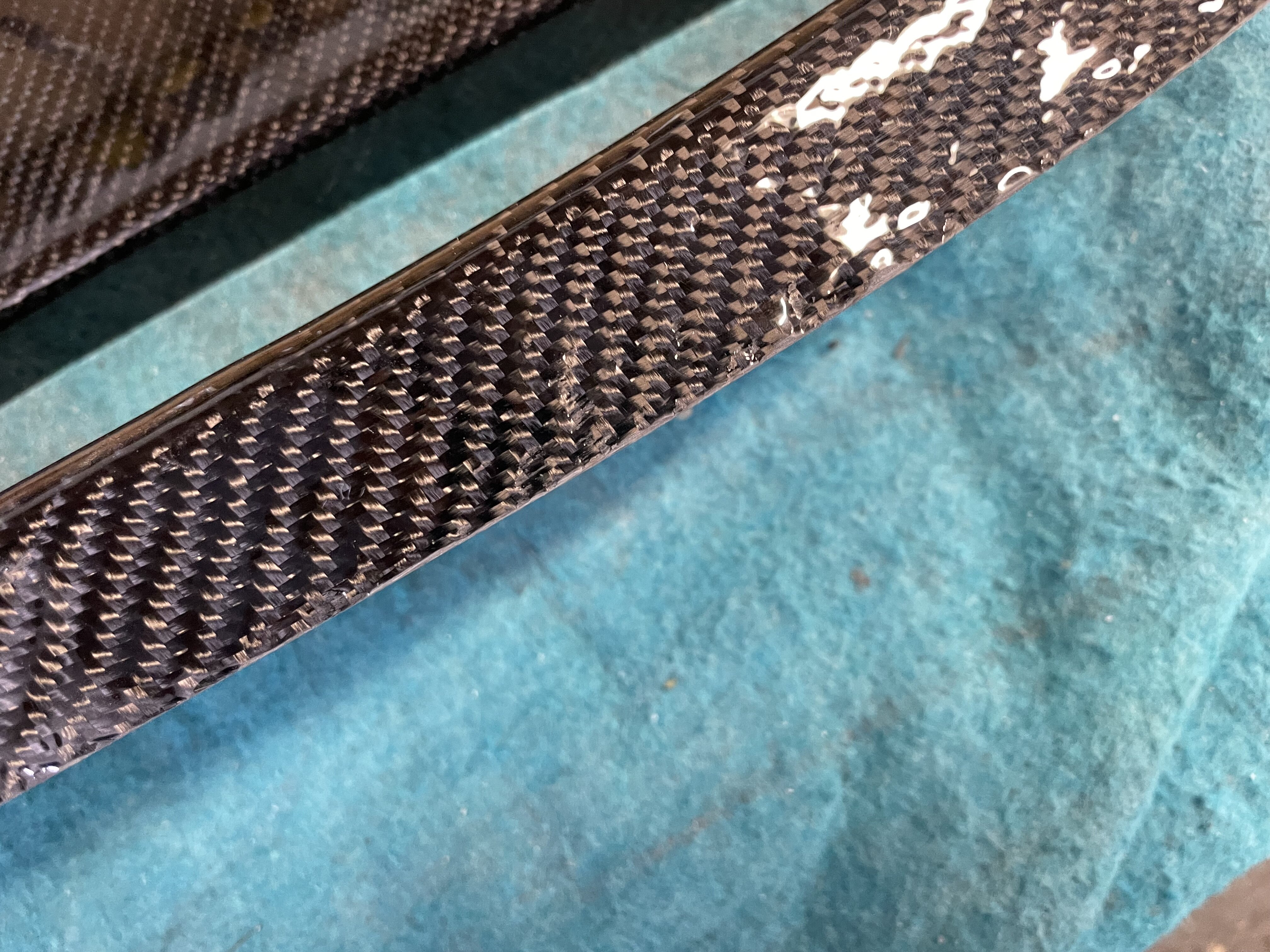

Andy wright Posted Friday at 16:52 Author Posted Friday at 16:52 And after an hour or so spent sanding down, then cleaning and applying the top resin coat, they look like this : Quote

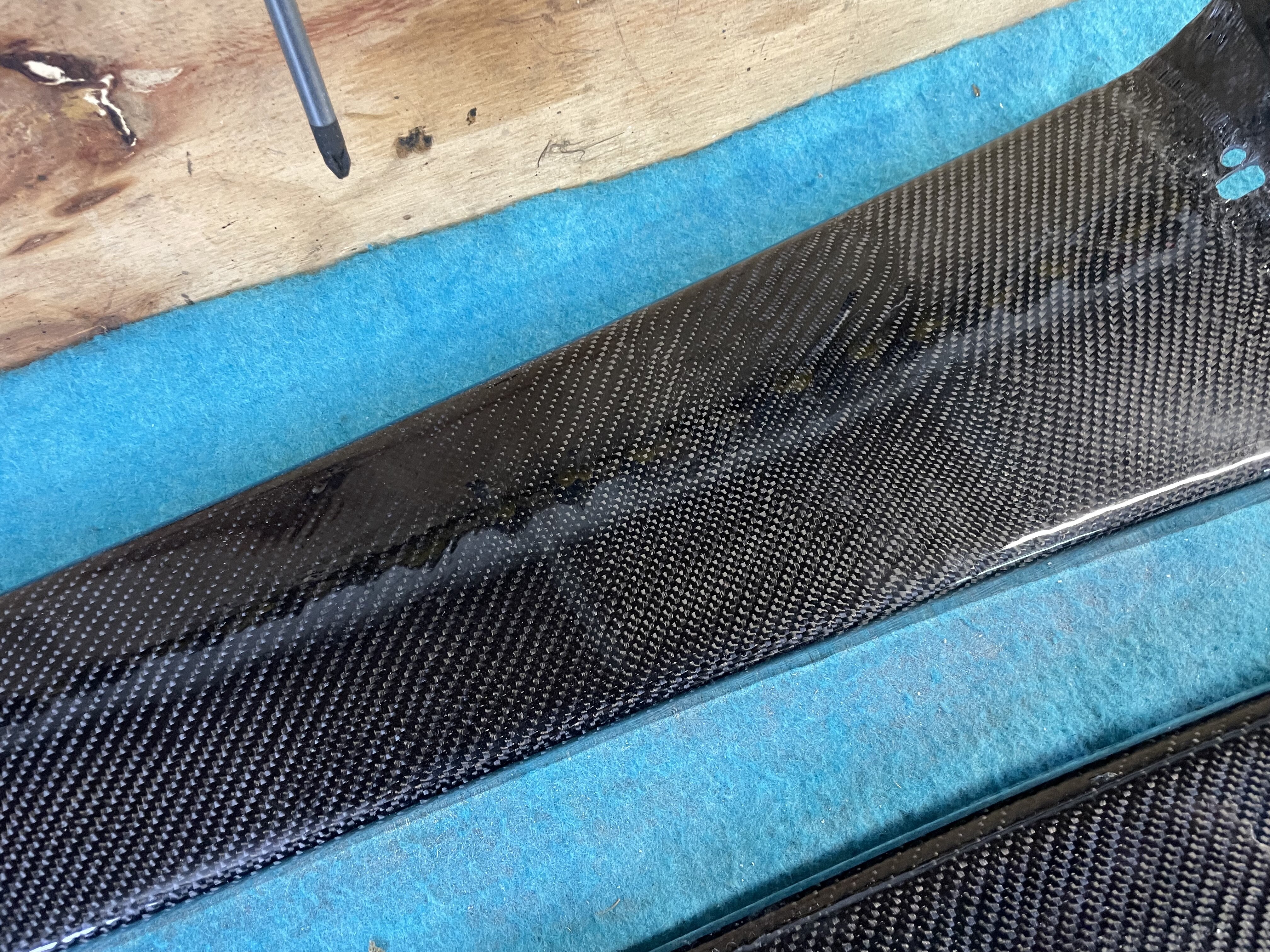

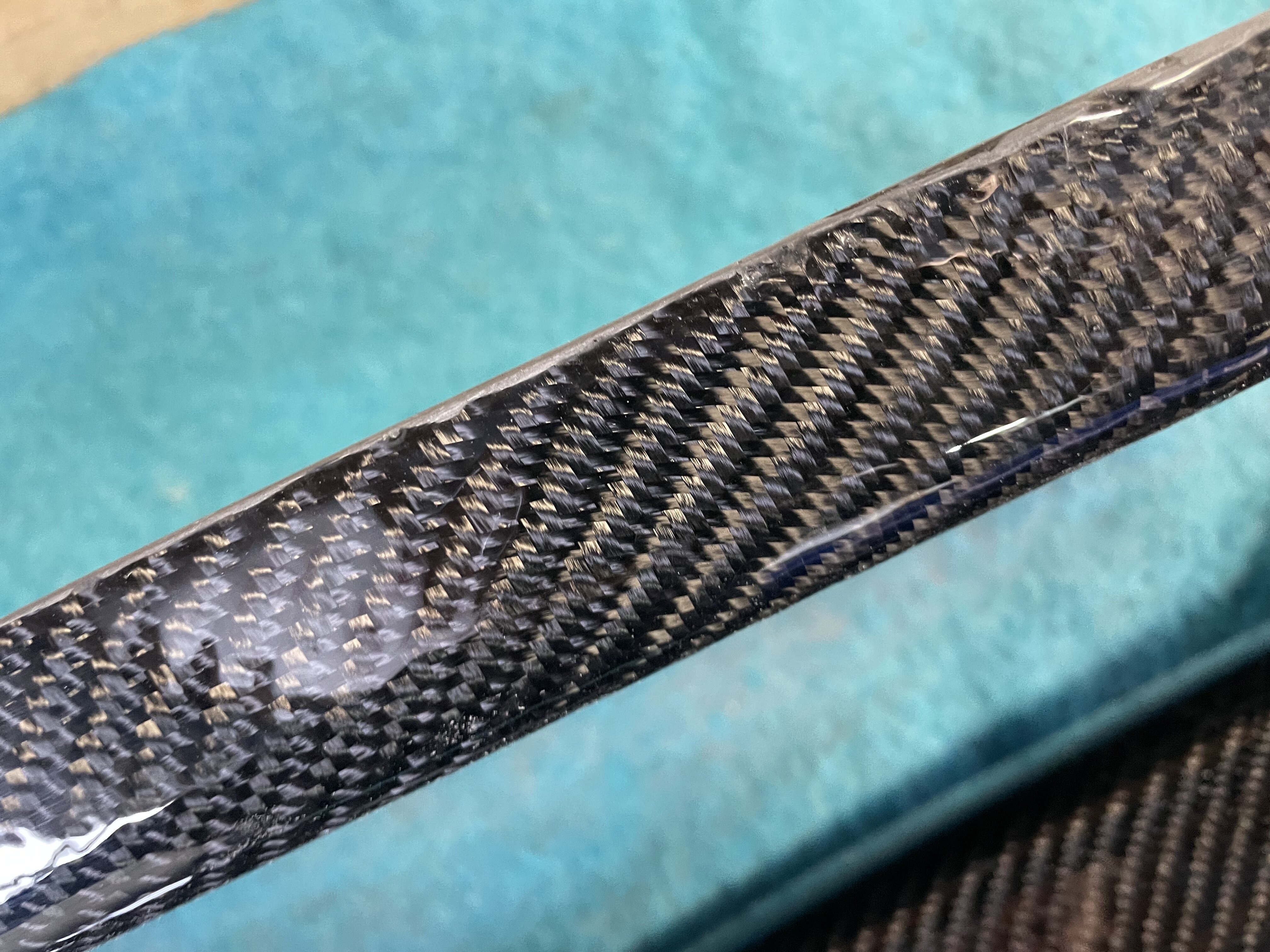

Andy wright Posted yesterday at 11:48 Author Posted yesterday at 11:48 And they looked pretty good. But the edges were not great . So another round of sanding and yet another resin coat applied this morning. Image of that to follow. This is what they looked like at 10.00am today Quote

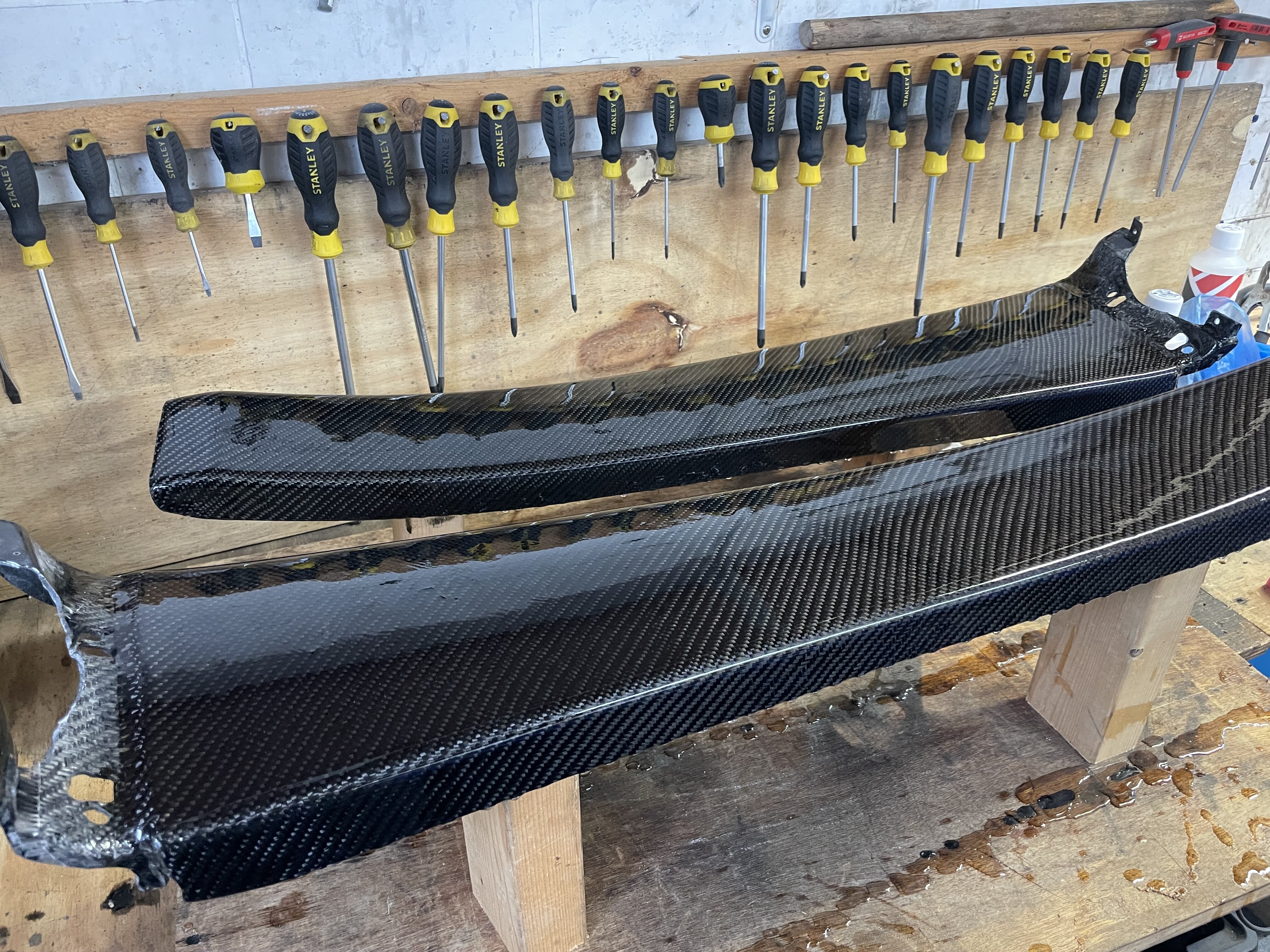

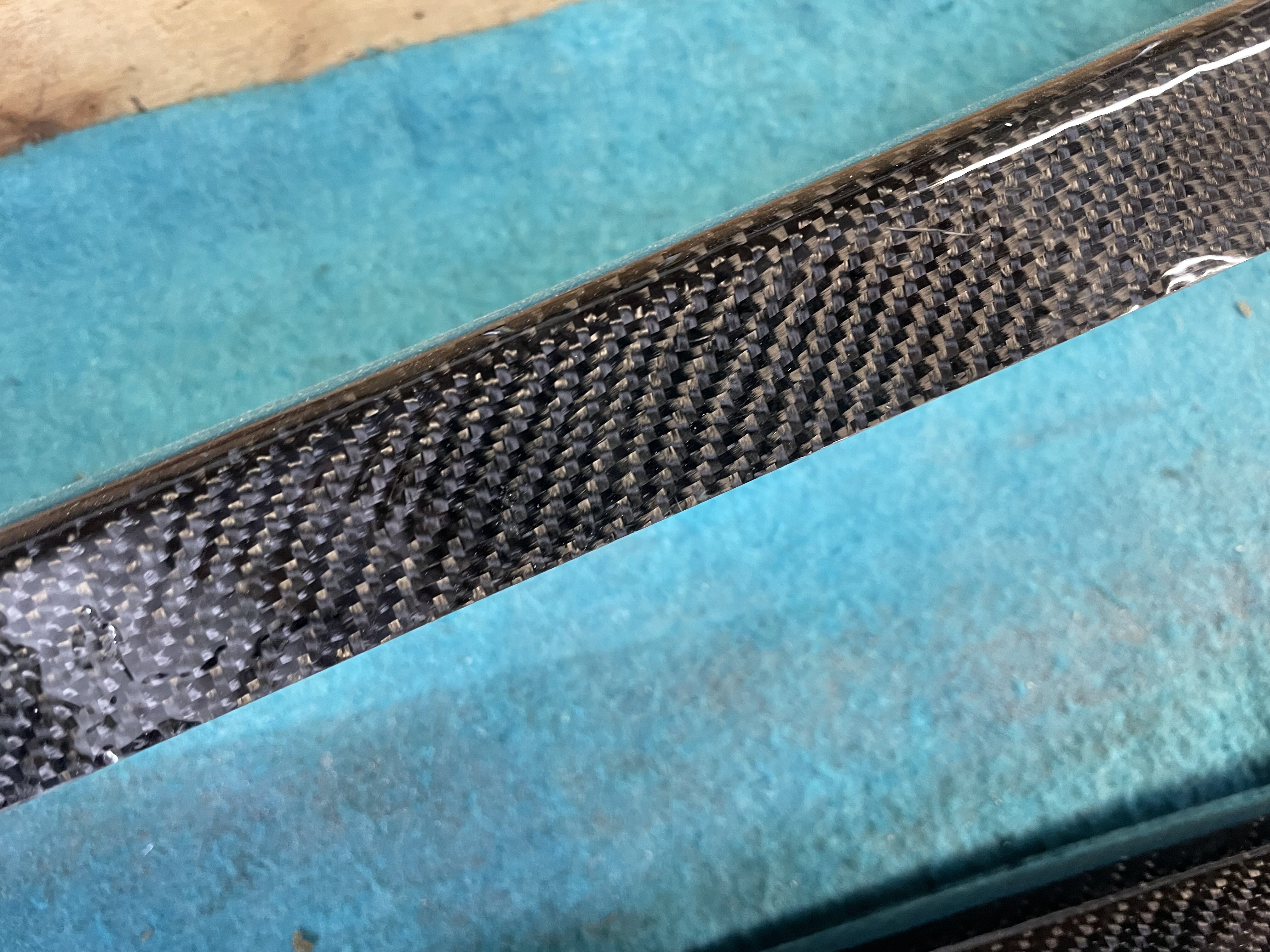

Andy wright Posted yesterday at 16:03 Author Posted yesterday at 16:03 And at 5.00pm on the same day Quote
