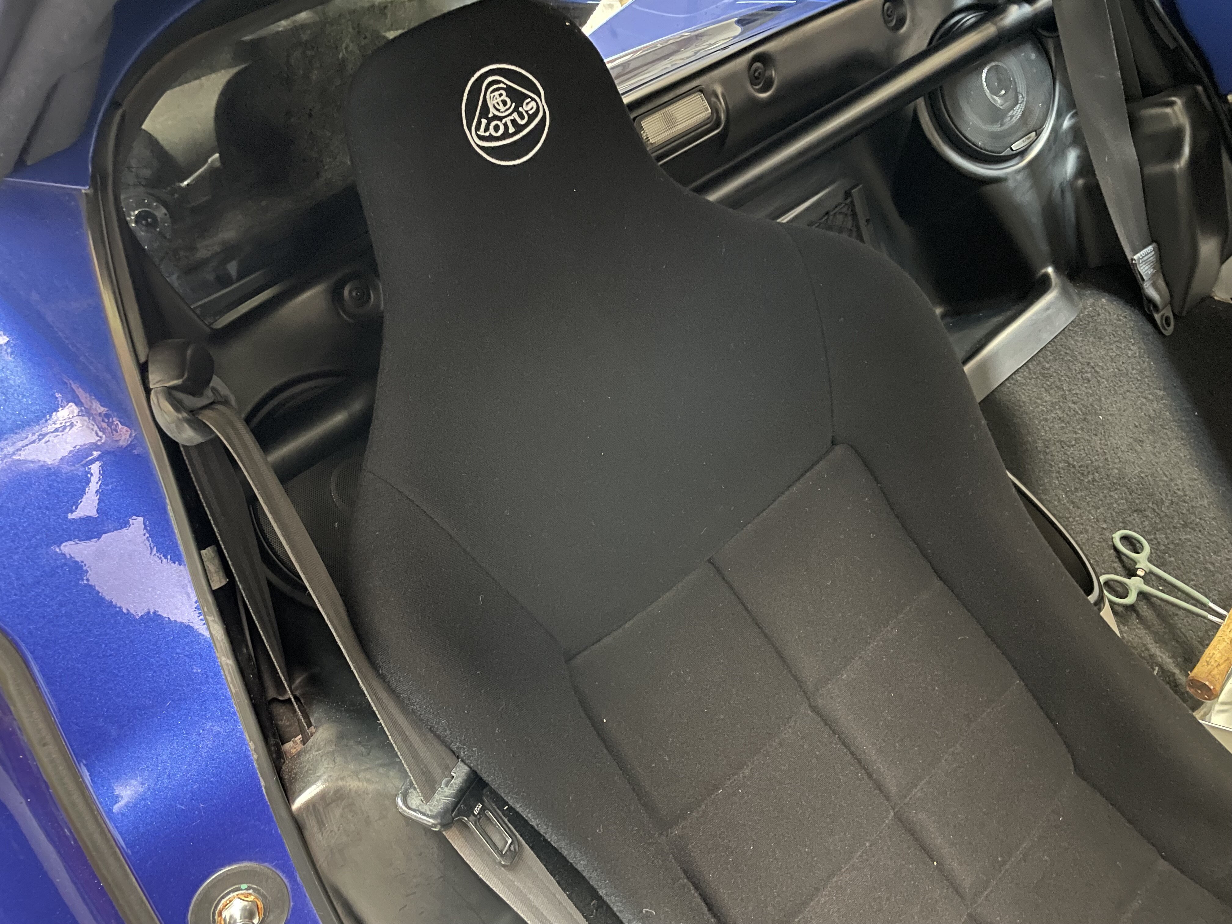

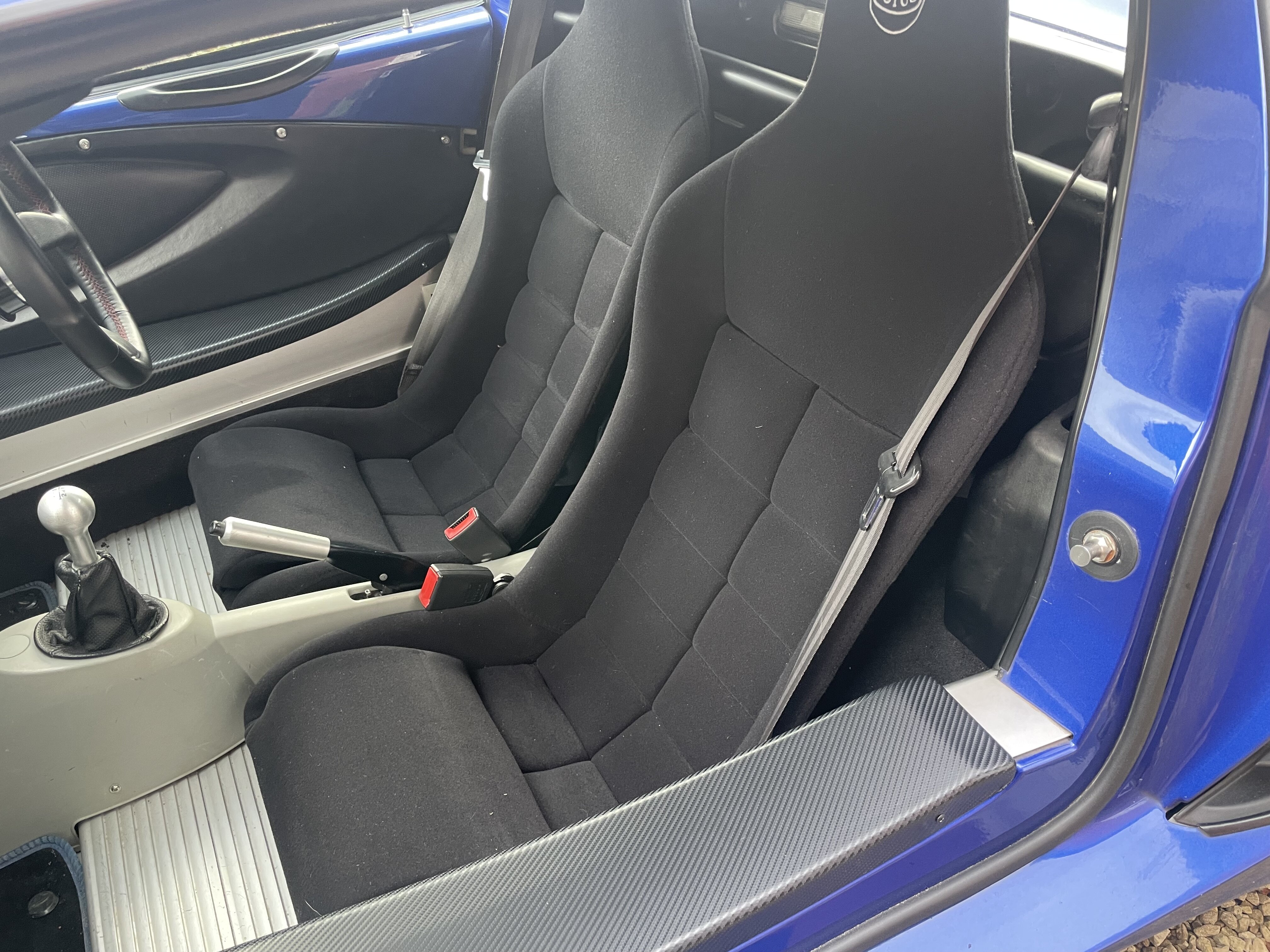

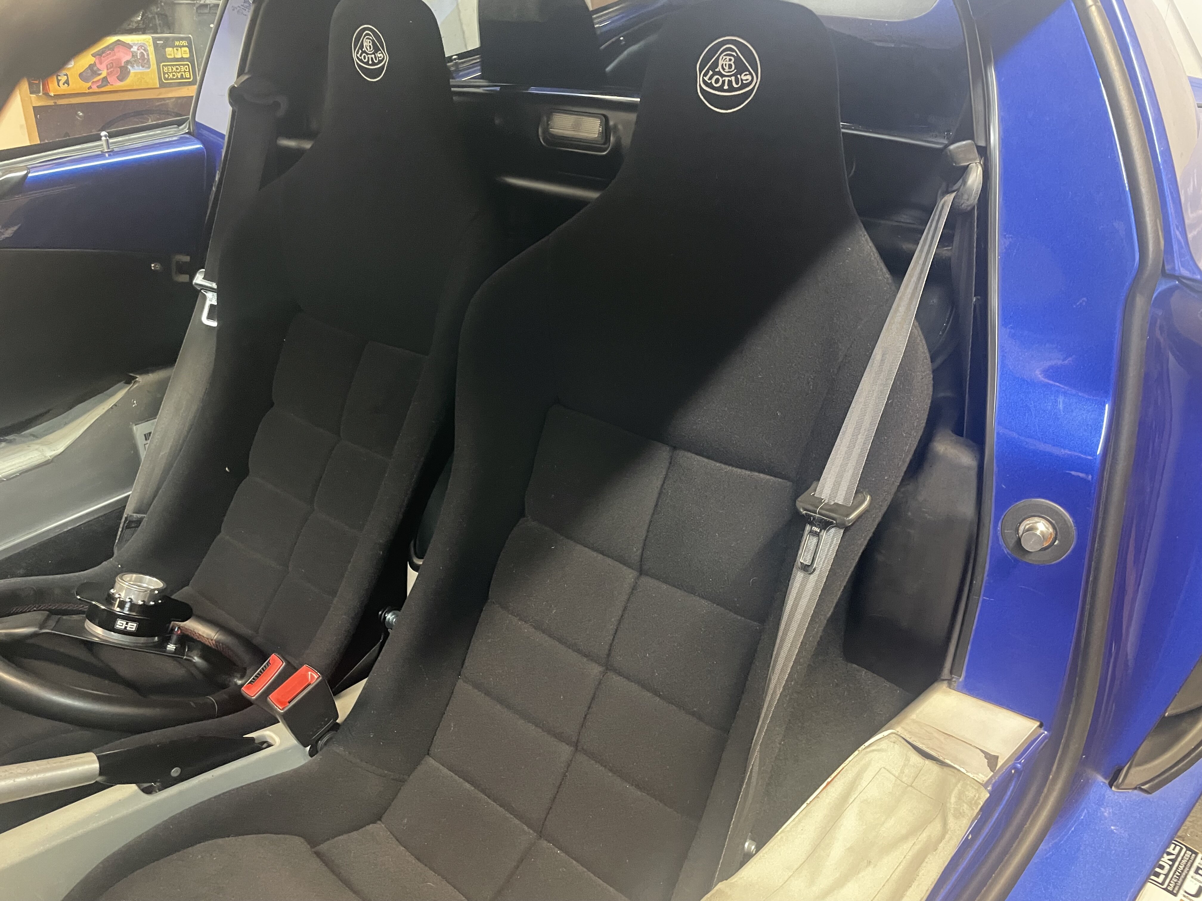

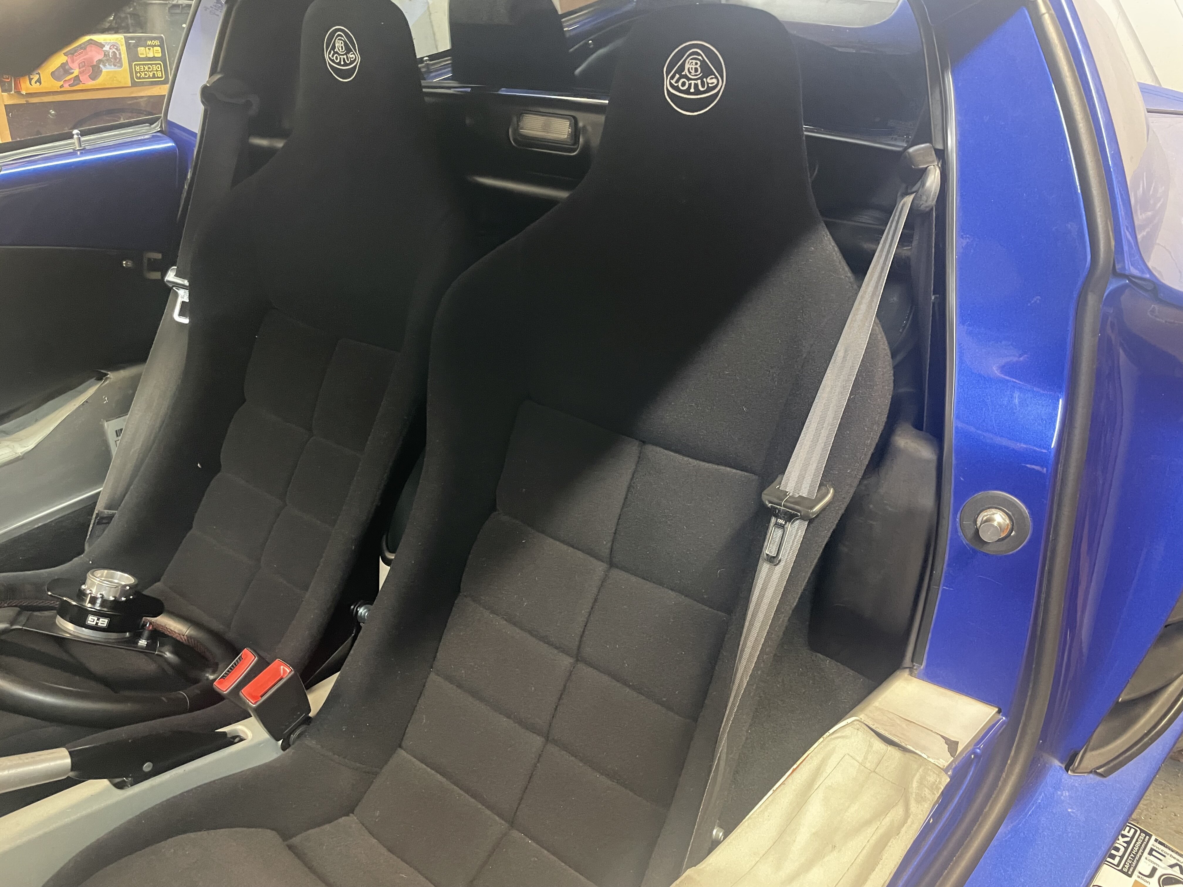

I had a great day out today at the Seriously Lotus  open day in East Yorkshire. Lovely drive out and back in glorious weather, over 100 cars to look at and people to chat to and a very nice ‘ hog roast ‘ lunch. Oh, and some nice goodies to look at , and I particular some B10 Tillet seats which are astonishingly comfortable. The only snag is that they are also astonishingly expensive . However, if anyone wants to buy my nearly new Corbeau LE seats with sewn in Lotus logo, it would be a great excuse for getting the Tillets !

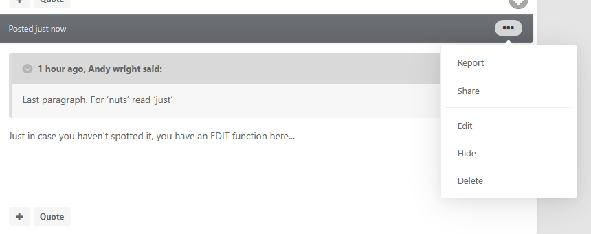

Just in case you haven't spotted it, you have an EDIT function as shown in this rather confusing screen grab :lol:

Thank you .Not noticed that option before .

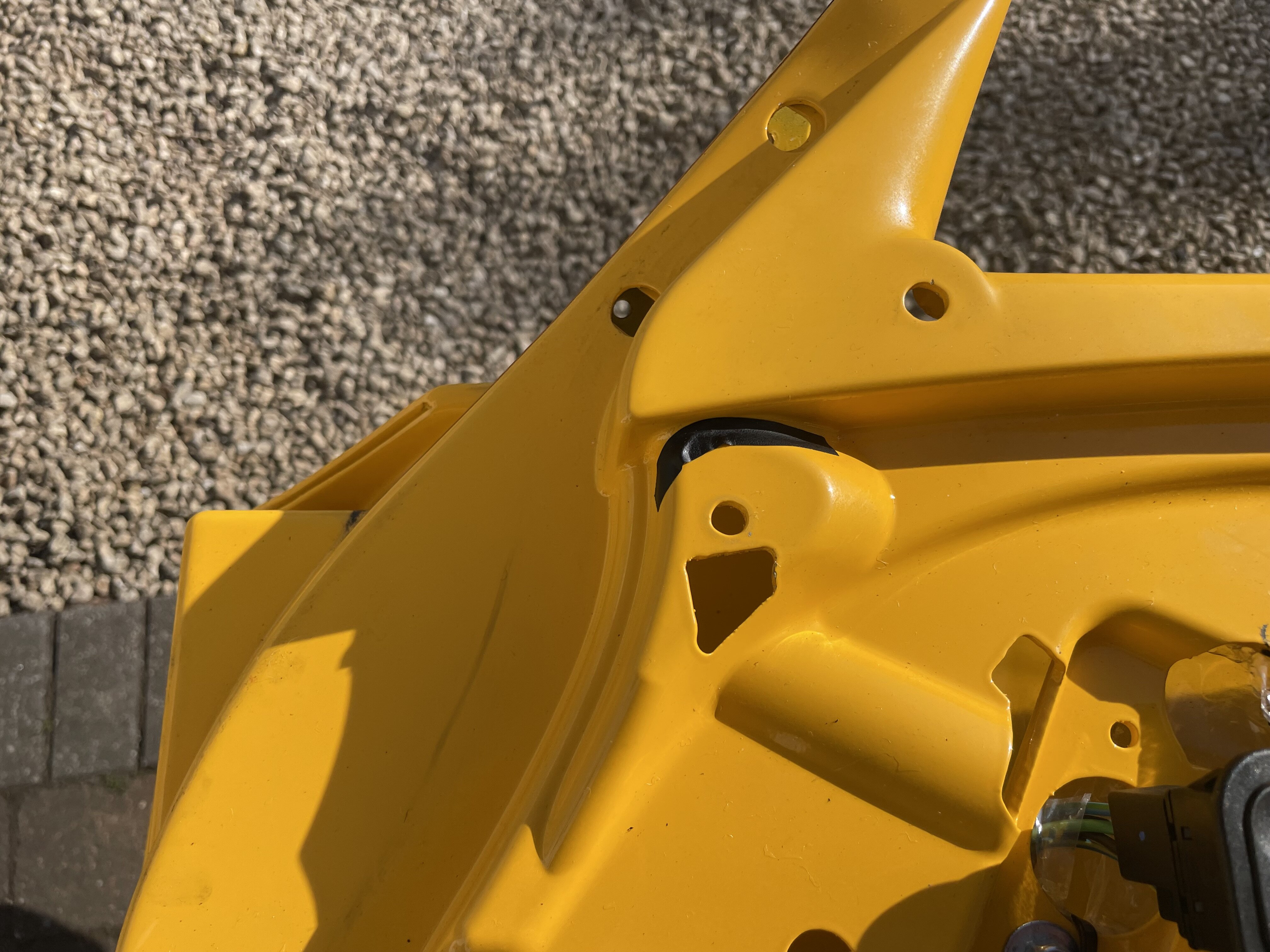

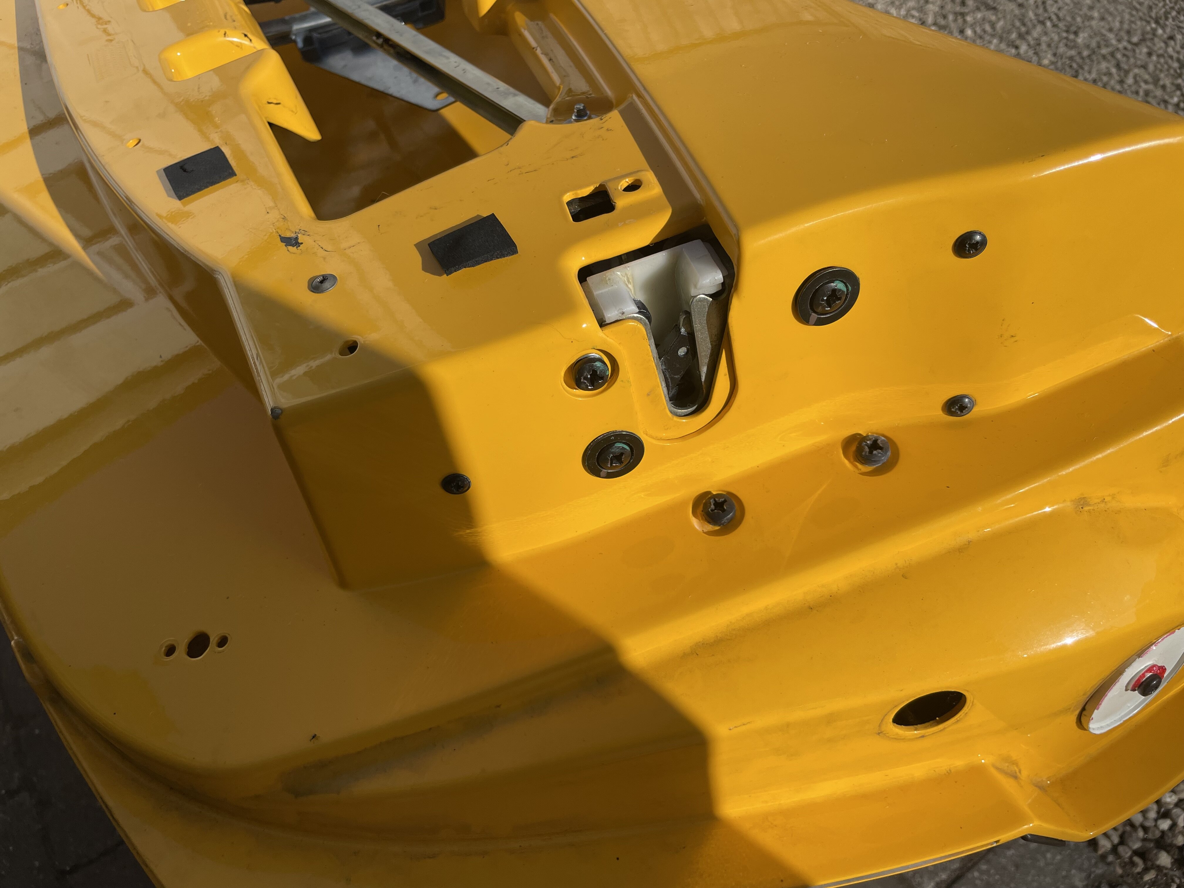

And now back to Earth with fixing the residual problems on my S2, ; smallpox outbreak on both doors. They have clearly had the infection for some time and not received any treatment. Considered a number of options, the cheapest being several cans of ‘ Paintnuts ‘ aerosol , lacquer and , err , a bit of prep. Snag is that the prep would almost certainly take some areas down to the fibreglass, And then an option appeared on eBay ( as they do ) A pair of doors , complete except for the mirrors, and I mean complete , trims, hinges , glass , the  lot . Taken from a 2019 250 cup . Absolutely pristine and they arrived within 24hours. There is one very slight drawback which I think is hardly noticeable , but my wife did seem to think that they were much more bright primrose yellow than mid blue. She may have a point, albeit a small one. Anyway, bright yellow doors now completely stripped. ( but not in the photo, thats work in progress) . Now I just need  to make them slightly less yellow , rebuild them and fit them.

Morning. In a word, almost certainly yes. I am going to  take the new doors for paint tomorrow, then I am away for a week. Once I get them back and begin to build them up again, you are welcome to come over and have a look at the stuff that I have  and decide what , if any bits you want. In principle, I will have two complete sets of door internals and door cards , it’s only the door lock barrels that I will need to ‘Rob’ from my original doors
I will let you know when I am ready to begin playing and then arrange for you to drive over and have a look . Be nice to meet you .

Message from the paint shop today to say that they have managed to get a 98% colour match using a BMW colour. The lotus one ( B100) was more like 91% ( no idea how these %ages are defined ) but it all sounds promising.
