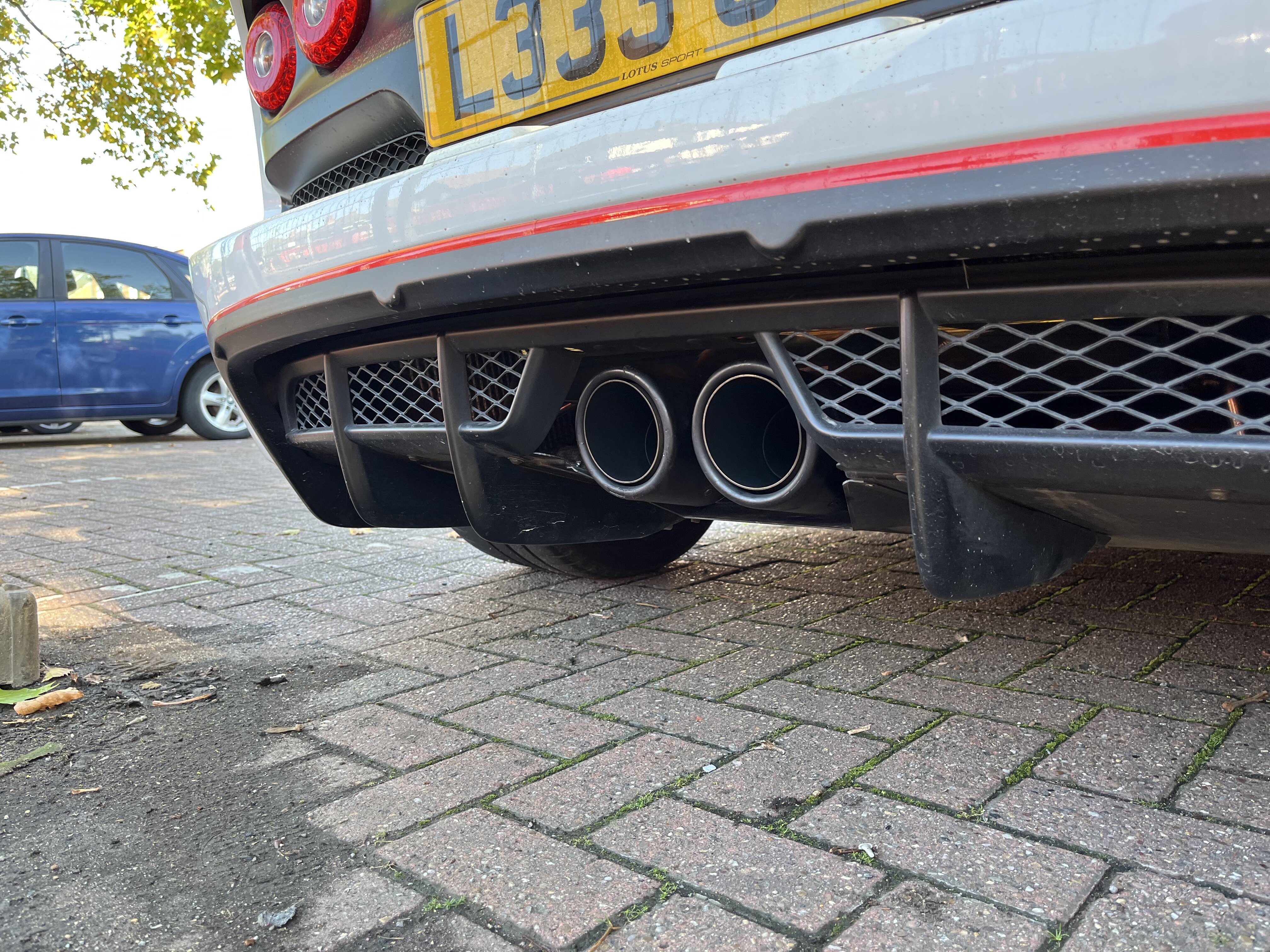

Popular Post Guido Posted September 28, 2024 Popular Post Posted September 28, 2024 Exhaust now sorted for something much more in keeping!! No more pig nose 🐽 Looks and sounds much better! I think that’s it for mods for now……… 😆 5 Quote

LotusDave Posted September 30, 2024 Posted September 30, 2024 Is the rear diffuser near the exhaust tips made of plastic? The reason I ask is the exhaust tips seem quite recessed, so from what I can see in the pic at least, it looks like the exhaust gases will heat up the diffuser a lot. If it is plastic, depending on the material type it will melt or burn and catch fire. Just a warning, something to check over. I've seen too many modified / super cars go up in flames for something as simple as this. Quote
Guido Posted September 30, 2024 Author Posted September 30, 2024 1 hour ago, LotusDave said: Is the rear diffuser near the exhaust tips made of plastic? The reason I ask is the exhaust tips seem quite recessed, so from what I can see in the pic at least, it looks like the exhaust gases will heat up the diffuser a lot. If it is plastic, depending on the material type it will melt or burn and catch fire. Just a warning, something to check over. I've seen too many modified / super cars go up in flames for something as simple as this. Good spot!! The tail pipes are adjustable so I should be able to pull them out a bit. I'll have a look when I get home. Quote
duncx Posted October 1, 2024 Posted October 1, 2024 (edited) I’m not a fan of the Pig’s snout - much prefer the twin tips so it’s a big thumbs up from me I also think that the tips look too recessed at the moment, IMO get them about flush with the mesh in the diffuser, if they will adjust that far. Edited October 1, 2024 by duncx Quote
Guido Posted October 1, 2024 Author Posted October 1, 2024 Dunc - There’s plenty of adjustment. I’ll have a fiddle at the weekend. 👍 Quote
Guido Posted October 2, 2024 Author Posted October 2, 2024 I’ve attempted to pull the tips further out. However, they touch the edge of the diffuser on both sides which doesn’t look great and might cause even more problems with heat. I might get a set of stainless tips from 2bular which won’t be as large as the carbon ones I have. Quote
