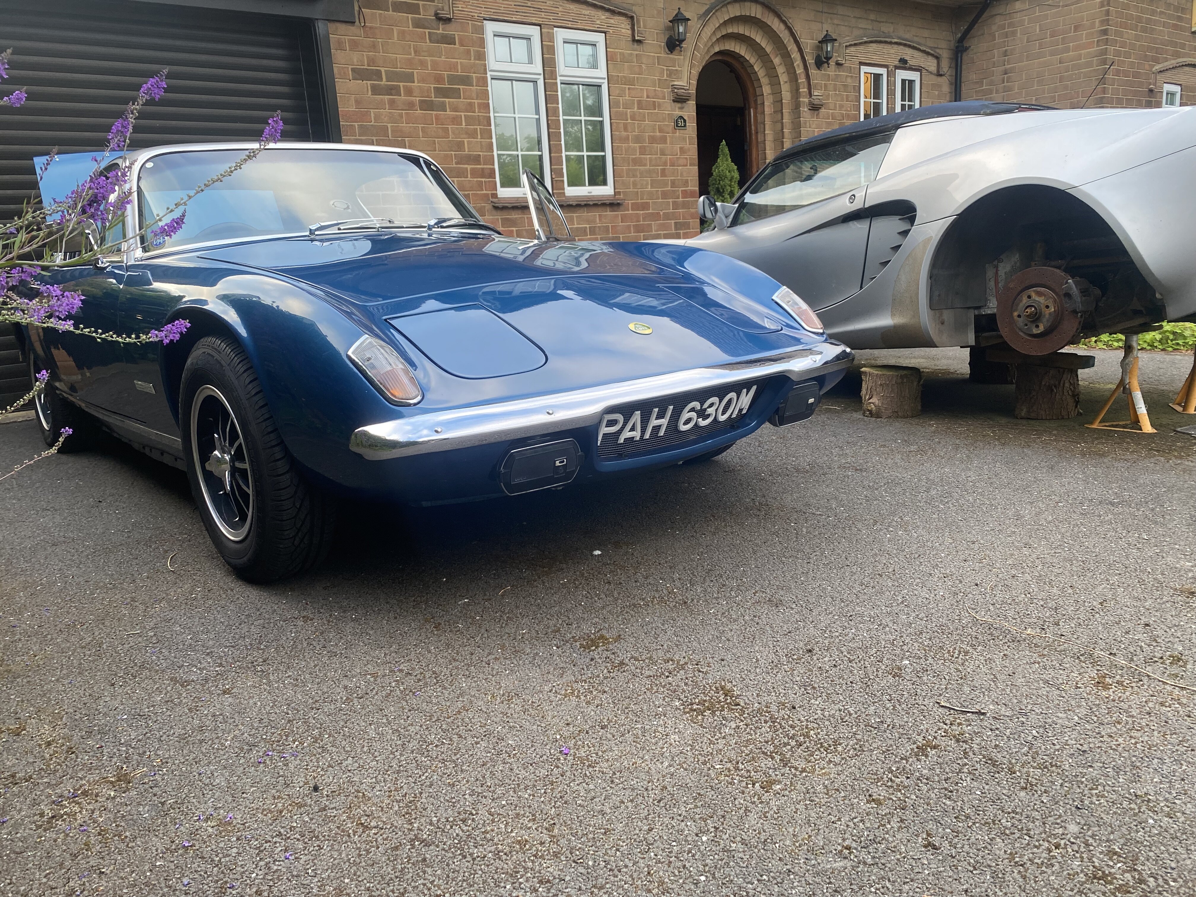

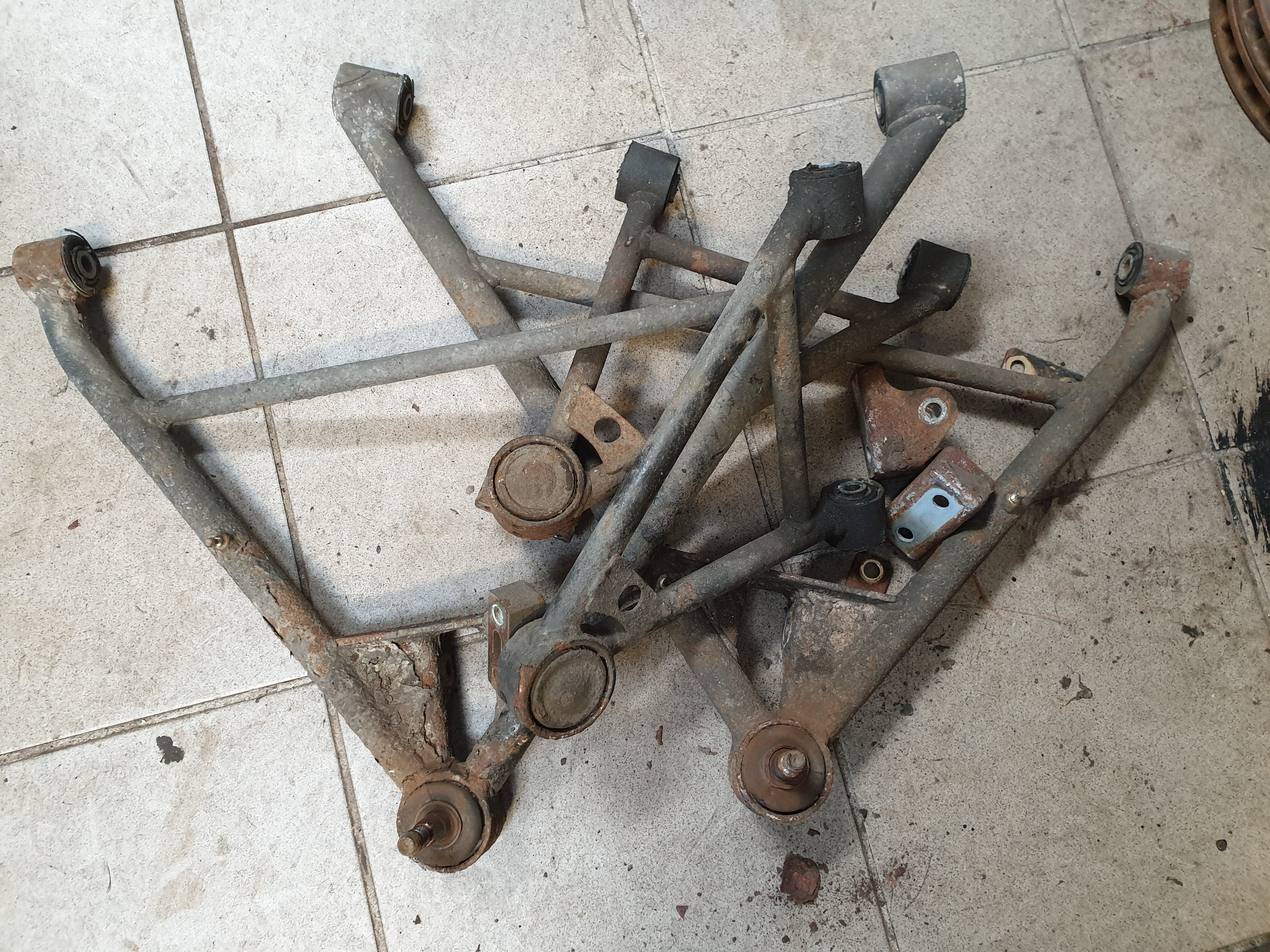

chip2257 Posted July 5, 2024 Posted July 5, 2024 On 03/07/2024 at 11:38, DeanB said: What's up with the Elise? Apart from the rear discs! D I’ve got new discs, pads, braided hoses and reconditioned bilsteins to go on We’ve given it a major service, although have still to tighten the crankshaft to 205nm We’re wondering if our wishbones are okay (they’re rusty but we’re not sure if they need replacing also) and we could just blast and paint to reuse after changing the bushes it’s a project to do with my Dad, finding time we’re both free has been the biggest delay!

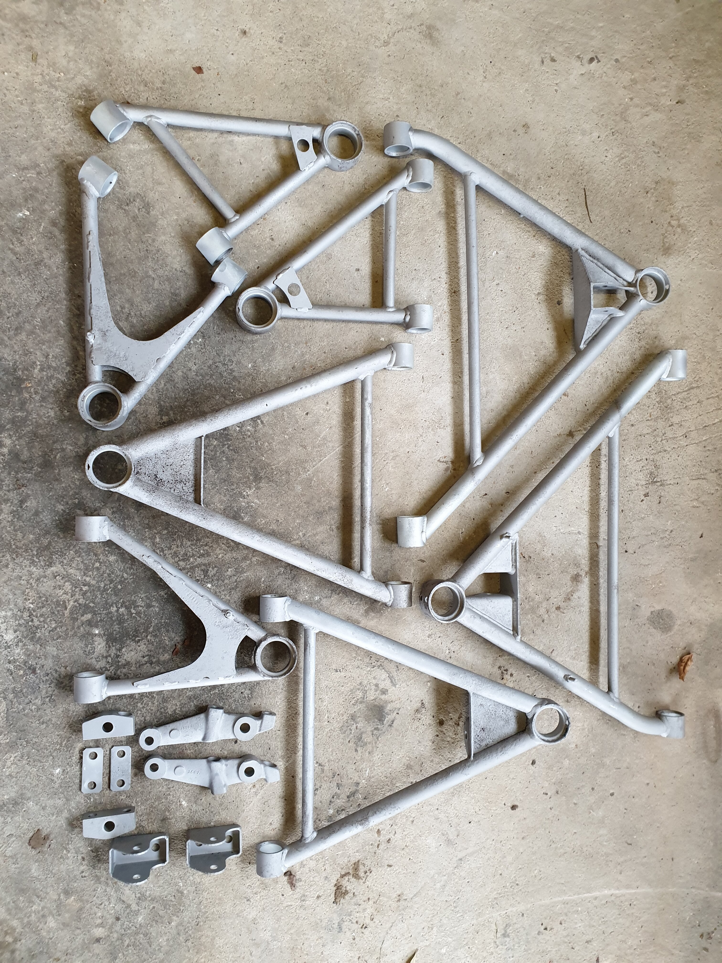

DeanB Posted July 5, 2024 Posted July 5, 2024 This is what mine were like and they were refurbed ok - media blasted and then painted. As you can see some bits were really scabby.
chip2257 Posted July 5, 2024 Posted July 5, 2024 Just now, DeanB said: This is what mine were like and they were refurbed ok - media blasted and then painted. As you can see some bits were really scabby. Fantastic! Thank you for sharing, very helpful. Very similar to ours Where did you get them blasted?

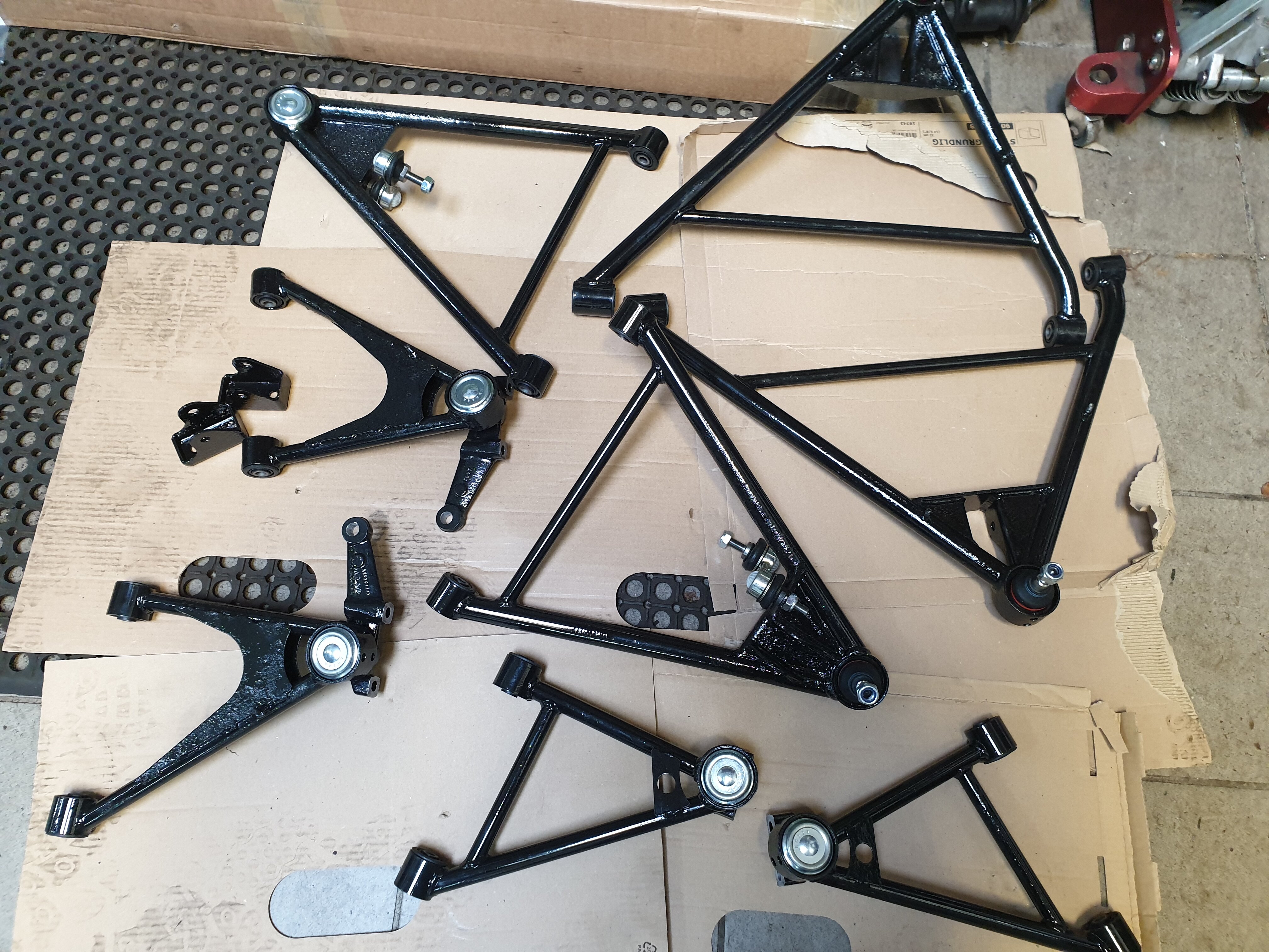

DeanB Posted July 5, 2024 Posted July 5, 2024 I had them done at a place near me in Bilsthorpe Notts. I just found him on google I think.
DeanB Posted July 5, 2024 Posted July 5, 2024 After blasting and then painting. That was 4 years ago and a little bit of rust is appearing again. If I were doing them now I would have them zinc passivated and then put at least 4 coats of POR 15 on instead of the two coats over bare steel that I did back then. I didn't powdercoat as that always chips off.
