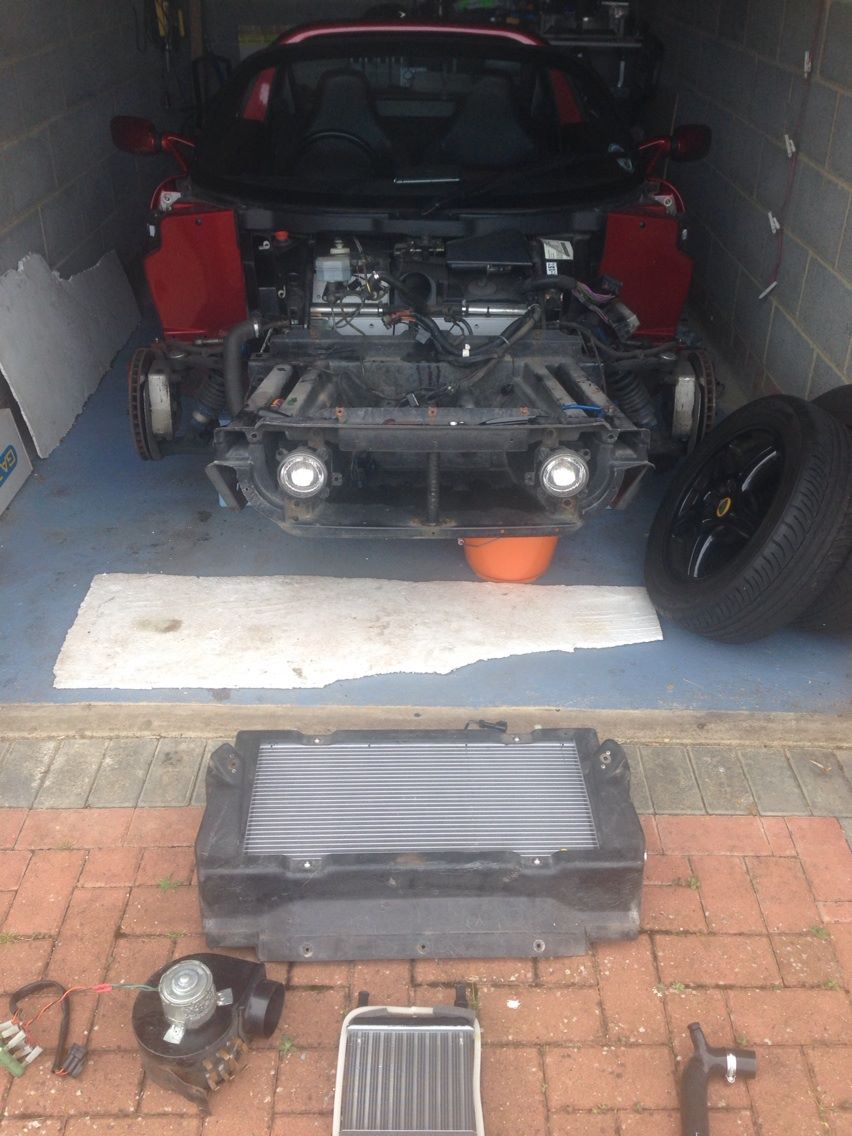

kayj_prod Posted May 7, 2014 Author Posted May 7, 2014 Well, good news! I ran the car on the level expecting to see some obvious signs of fluid somewhere, but still just a vague drip and nothing wet anywhere I could get my hand to, but then I caught rather too much of a reflection when looking through the front service compartment. I removed the water bottle and battery and... bingo. Coolant central! The 'floor' is very wet yet all pipework is dry. The only area of wetness is the bottom of the heater matrix so I think it safe to conclude I need a new heater matrix. Definitely cheaper and less hassle to fix. I'm sort of disappointed I won't need a nice shiny new radiator now! I figure the repair will be a little easier on my back with the clam off though I can see I can do it without taking it off. Unless you guys think there's anything else I might have missed, I'm going to get ordering. Thanks for that link Martin. Funnily enough, another linking that thread lead to someone else with a similar issue as me only to find the fault with the heater matrix after changing the sill water rails.

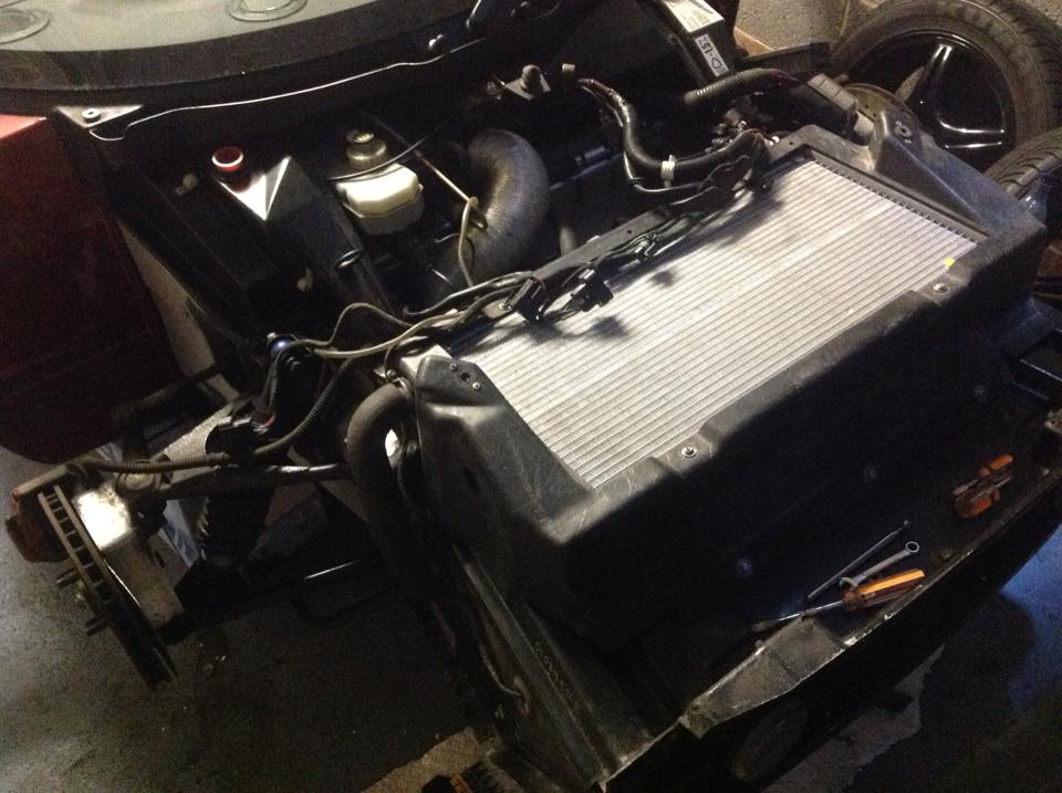

kayj_prod Posted May 27, 2014 Author Posted May 27, 2014 It's been a while since I started this job because I've been away a lot so I've only been able to use a few evenings to strip everything out... it would have been a quick job except for pretty much all of the nuts around the radiator being well rusted and pretty awkward to get a Dremel to or a hack-saw blade. Anyway, in about five hours yesterday I managed to remove the heater matrix and blower -so glad I took the clam off because it is very awkward to get out- clean everything up and then re-fit the heater assembly, rad and battery. Nice new C-clips and bolts on everything. Worst job is definitely the heater assembly. I had to stop short of reattaching the wiring loom as I don't think my neighbours would have appreciated the inevitable alarm sounding at 10 pm. I may get time to do that tomorrow, then re-fill and bleed the coolant, clam on, done!
