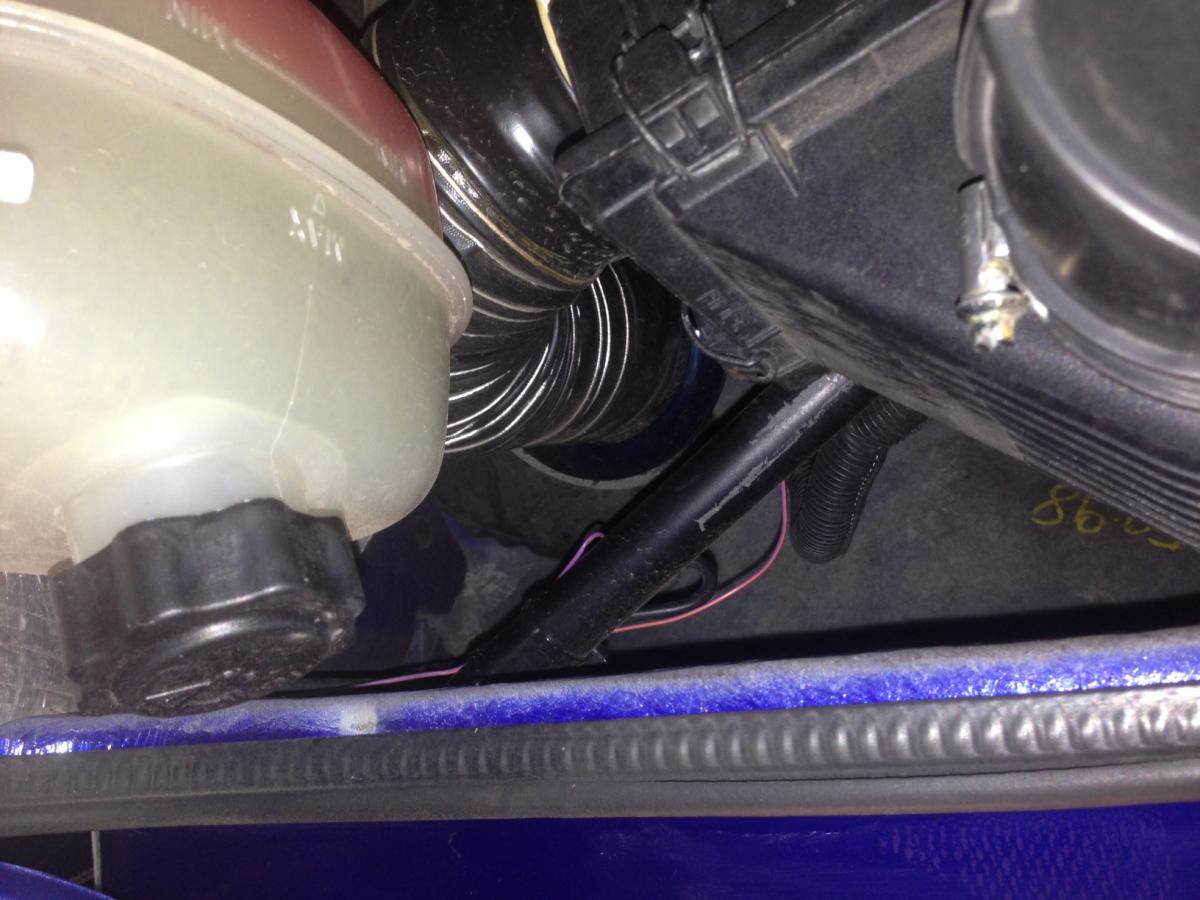

Phil S1 Posted June 17, 2013 Author Posted June 17, 2013 Thought I'd update you on where I am with this currently.... My plan was to reconvene with Brian to check the timing, check the cat hadn't collapsed and look at improving the induction side of things before another trip to the rolling road, that plan has gone slightly awry at the moment. As yet I haven't seen Brian or checked the cat but instead concentrated on the intake. I didn't want to fit a Hurricane or the like as I ran something similar some years ago and found it too noisy for my liking so I opted to fit a K&N panel filter and modify the airbox to accept a larger intake hose from the side vent. I also decided to have a go at de-wedging a 48mm throttle body. So I picked up a virtually new TB and modified it as per the seloc TechWiki:- http://wiki.seloc.org/a/Throttle_body Here's a couple of photos of the modified one against my std one:- As well as removing the wedge you can see in the photo above that there's also a lip near the butterfly that I've also removed on both sides to smooth the airflow. I removed the old airbox and intake hose, you can see from this photo the somewhat tortuous route that the air has to flow round before it even reaches the filter:- I picked up another airbox and decided to try and fit a 100mm dia intake hose into it, the reason being that 100mm fits nicely over the elliptical intake vent on the clam. I also managed to find a very reasonably priced 100mm dia elbow normally used in ventilation ducting for cooker hoods and shower extractors and the like:- and then the final piece of my jigsaw was the K&N filter:- The airbox isn't quite wide enough to accept a 100mm dia elbow but I found by cutting a slightly elliptical hole I was able to deform the elbow sufficiently to get it in, here's the hole:- and here's the elbow fitted, following a quick flash over with some satin black paint:- Two things to note here, I had to fit the elbow angled downwards as shown above in order to clear the pipes to the charcoal canister (shown in the next photo) and I needed to fit a rivet to hold the elbow in place whilst the Tiger Seal dried. Once the Tiger seal had dried I also ran some silicon sealer round to seal any other little gaps. There's a couple more photos to come and the conclusion to this particular instalment but I think I must have reached some kind of upload limit as I can't upload any more images....so you'll have to wait for now ;-)

Phil S1 Posted June 18, 2013 Author Posted June 18, 2013 Thanks for the replies, good idea to relocate the charcoal canister Legin and as you say the cars sounds so much better now! As regards the price, a Hurricane kit looks to be about £170. If you're willing to modify your existing airbox then the cost of mine adds up as follows:- Half metre length of 102mm dia 2 ply black neoprene ducting - £14.99 plus £1.95 postage. 100mm 90 degree elbow joint - £1.49 plus £1.99 postage. K&N filter - £27.99 inc postage. Grand total - £48.41 So, to complete yesterdays instalment..... Here's a photo of the modified airbox installed and showing how the angle duct avoids the pipes to the canister:- And then one more with the neoprene intake hose tie-wrapped in place. (I had to cut about 5 inches off the overall length):- Not quite as direct as Legin's would be with the canister relocated but nonetheless there is direct line of sight from the car's side vent into the 90 degree elbow so still miles better than previously. So, another job done and time to fire up and try it out. I did the TPS reset procedure and had to get the idle adjustment set again and then I was ready to go. The car felt instantly better than previously, probably more than any other mod I've done, I presume this was down to modifying the throttle body....and the increased induction sound was lovely without being too excessive. However..........I have another problem! After I had the basic KR1 porting done, and prior to fitting the camshafts, once or twice I had an occurrence where after brisk acceleration beyond say 6000rpm the engine started misfiring. It would just about tickover but wouldn't accelerate cleanly until over around 3000rpm. If I stopped, switched the ignition off for a few seconds and then re-started, all would be fine again. I spoke to Rog about this at the time and it is something he had known occur, specifically on S1's it seems. He feared it could be a fault in the ECU but also suggested swapping the TPS sensor, I had a spare so I tried that and it seemed to fix it. Now, with the addition of cams and these mods I've just done, it will start misfiring every single time I use more than around 5500rpm. Keep the revs down and all is well. So the car's still fine for driving on the road but I think trackdays are out of the equation until I get it resolved. I did a bit of research in the seloc archives and found a few similarly modded cars that encountered very similar problems and one in particular by Greg_S which was pretty much exactly my spec of car with identical symptoms:- http://forums.seloc.org/viewthread.php?tid=311487&page=1#pid5291153 If you read through it you'll see he changed just about everything without success until he had an Emerald fitted. I can only assume that the ECU just can't cope with the amount of air now coming in. There's also a theory that the MAP sensor being located within the ECU on an S1 might be a contributing factor in all this? I am going to try swapping the TB back to a std 48mm one and see if that minimises the problem again but as Greg_S found, I am starting to think that I'm going to need an Emerald to fully resolve it and get the best out of all the mods. It still could be that my ECU is faulty, I could potentially pick up a secondhand one but from what I understand it is not just a plug and play swapover but requires a tool to synchronise with the alarm immobiliser. So that option could cost me maybe £150? and may be no better than I am now so it's not an option I'll be taking. I'd sooner put the money towards an Emerald I reckon, in the knowledge that will fix it once and for all. So close....I can feel all the right elements are there...I just need something to make them all talk to one another
