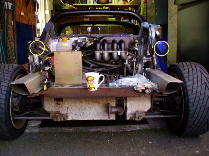

Ladders Posted July 28, 2008 Share Posted July 28, 2008 Martin, when the clams off it might be worth making access holes to the speaker pod bolts from the rear of the clam, if it's possible? I was round steve's and he showed me access holes that had been made either side from the rear, so you can get access to them through the engine bay. May be worth asking him about it as it's a bit hard to explain! Link to comment Share on other sites More sharing options...
Martin R Posted July 28, 2008 Author Share Posted July 28, 2008 Martin, when the clams off it might be worth making access holes to the speaker pod bolts from the rear of the clam, if it's possible? I was round steve's and he showed me access holes that had been made either side from the rear, so you can get access to them through the engine bay. May be worth asking him about it as it's a bit hard to explain! Im sure he will be along shortly. Im not sure half of this is going back in though. The radio is knackered and we use the Elan for the touring so i will give it some thought. Access holes would be good though Link to comment Share on other sites More sharing options...
Ladders Posted July 31, 2008 Share Posted July 31, 2008 Martin, the holes I was on about are here on Steve's. Not sure if you'd be able to get to them with the clam on though? Good mug btw! Oh, btw any reason you haven't had a new manifold Martin? The old one is a heap of junk IMO! Link to comment Share on other sites More sharing options...
Martin R Posted July 31, 2008 Author Share Posted July 31, 2008 Phil, thanks for the offer but im going for a PRT one when / if its ever running again. Dave, there are 3 or 400 reasons why im sticking with the old manifold. Steve, im just about coping with the lovely Lizs help Link to comment Share on other sites More sharing options...
