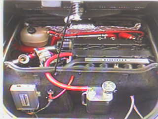

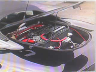

playball Posted February 19, 2008 Posted February 19, 2008 hi phil,if you need ne ?s anawering or come across ne problems plz dnt hesitat to ask. i did this conversion back in 2004. so if your intrested i still hav a few pics i can send to u. so il be glad to offer u some advice if u wish, it was vry tight squeeze but worth it. all the best and gud luck.
Phil.S Posted February 19, 2008 Author Posted February 19, 2008 hi phil,if you need ne ?s anawering or come across ne problems plz dnt hesitat to ask. i did this conversion back in 2004. so if your intrested i still hav a few pics i can send to u. so il be glad to offer u some advice if u wish, it was vry tight squeeze but worth it. all the best and gud luck. Sent you a PM. Cant wait to see some pics!!

Fiona Posted February 21, 2008 Posted February 21, 2008 Very tidy looking install. What bhp are you getting?

playball Posted February 22, 2008 Posted February 22, 2008 Very tidy looking install. What bhp are you getting? ENGINE SET UP TO ROUND THE 325 MARK, GIVING A POWER TO WEIGHT RATIO OF 401 BHP RUNNING AT 10 PSI OF BOOST.
MilesH Posted February 23, 2008 Posted February 23, 2008 Very tidy looking install. What bhp are you getting? ENGINE SET UP TO ROUND THE 325 MARK, GIVING A POWER TO WEIGHT RATIO OF 401 BHP RUNNING AT 10 PSI OF BOOST. Not meaning to doubt you, and purely out of interest, but 325bhp from that engine. In my years of rovers I've only seen a handful running that sort of bhp from that engine - AN racing being the notable tuners of big hp as I remember. What have you done to get that? I am assuming forged engine, T28 (or custom turbo?), larger intercooler??

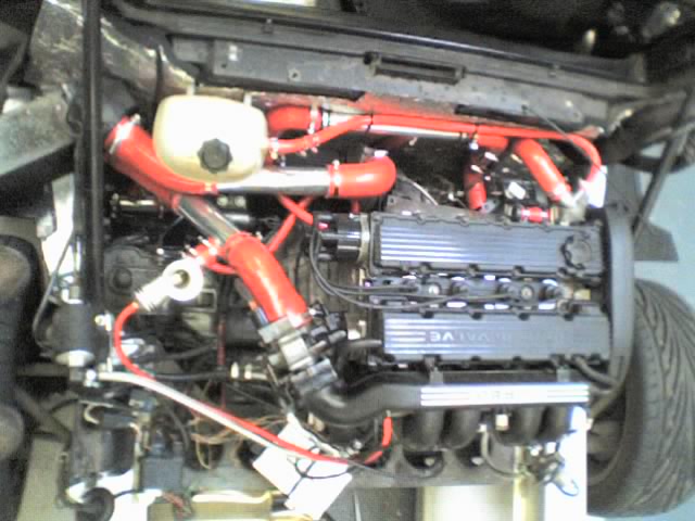

Phil.S Posted February 24, 2008 Author Posted February 24, 2008 Progress update: made loads this weekend - gaskets finally arrived on Friday. Had to drive to lincoln on sat to get some piston rings but took the engine from this: to this to this: So pretty much ready to try to get it in..... Thanks to playball off here by the way for being so very helpful in talking me through what is involved.
Phil.S Posted March 2, 2008 Author Posted March 2, 2008 Ok another quick update summed up as follows: Out with the old: In with the new: First job is to replace my 'custom engine mount: Looking good though.
Ladders Posted March 3, 2008 Posted March 3, 2008 Looking good though. Like the precision equipment on the wheel! Have you fabricated the engine mounts yet? Can you use the same gearbox etc as the K?
Phil.S Posted March 3, 2008 Author Posted March 3, 2008 Looking good though. Like the precision equipment on the wheel! Have you fabricated the engine mounts yet? Can you use the same gearbox etc as the K? Hehe! An essential part of any job! Rover turbo uses a PG1 gearbox but with an LSD. All the mounting is the same and it looks very similar. The bellhousing is slightly different and I needed to use the clutch release arm from the elises gearbox as the lever arm points up and the rover one points down. oh and also the gear linkage needs a spacer making up as the mounting pillars are 20mm shorter on the turbo one. apart from the spacer though it uses the same mountings etc. which is very useful. I finished getting the engine in at 5pm on sunday so had to rush off for mothers day so i'll think about the mounting this week.
