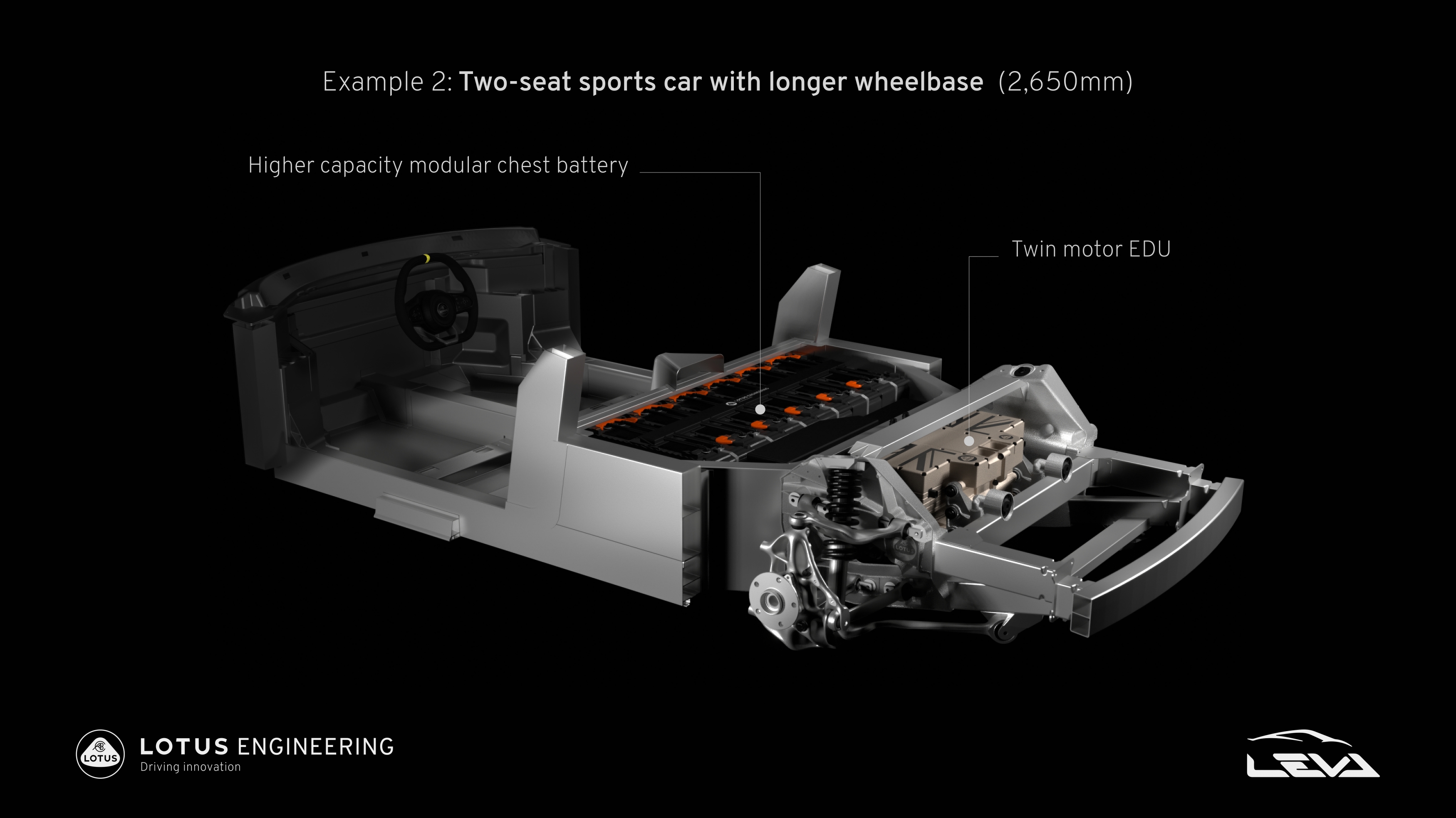

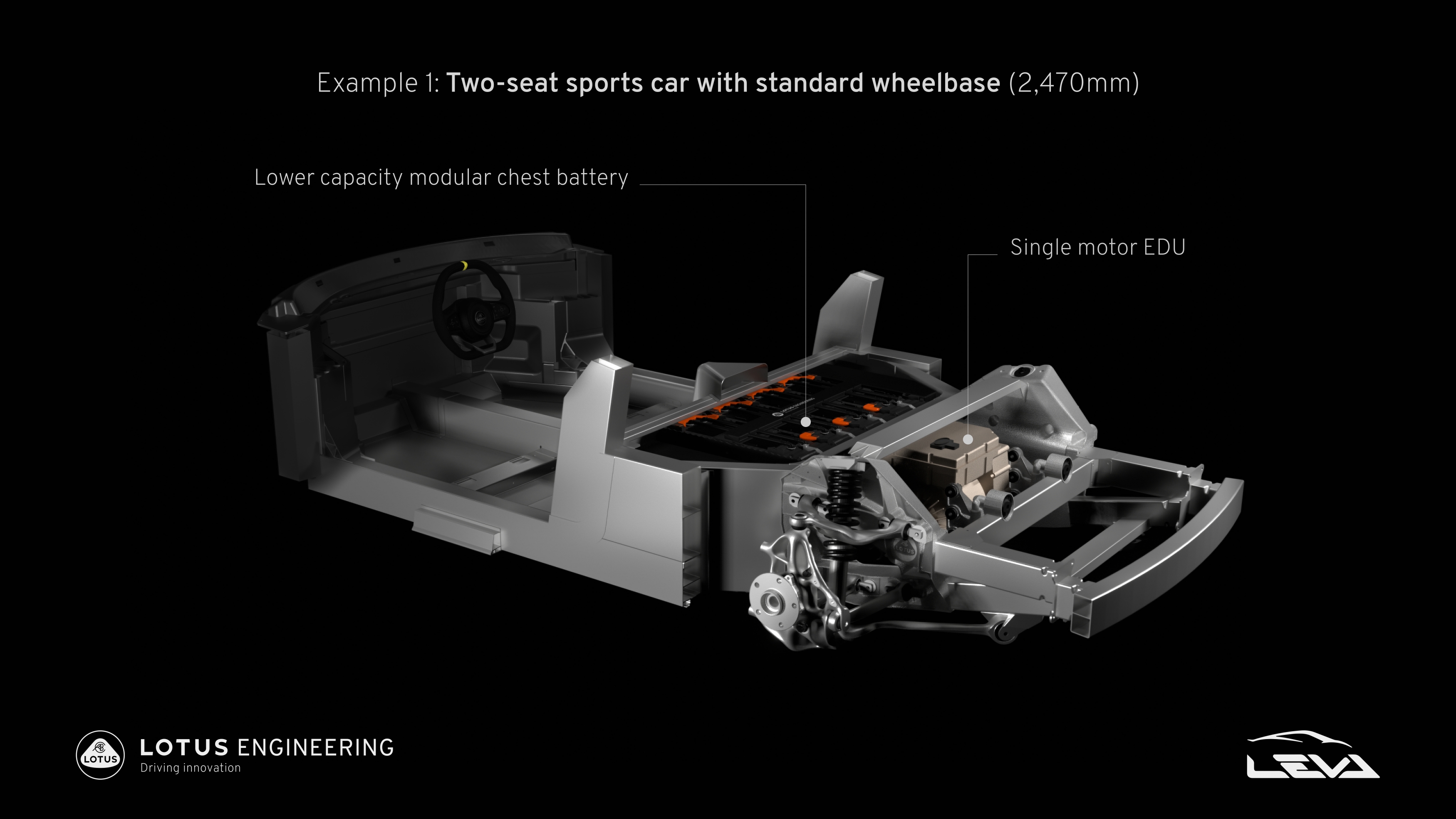

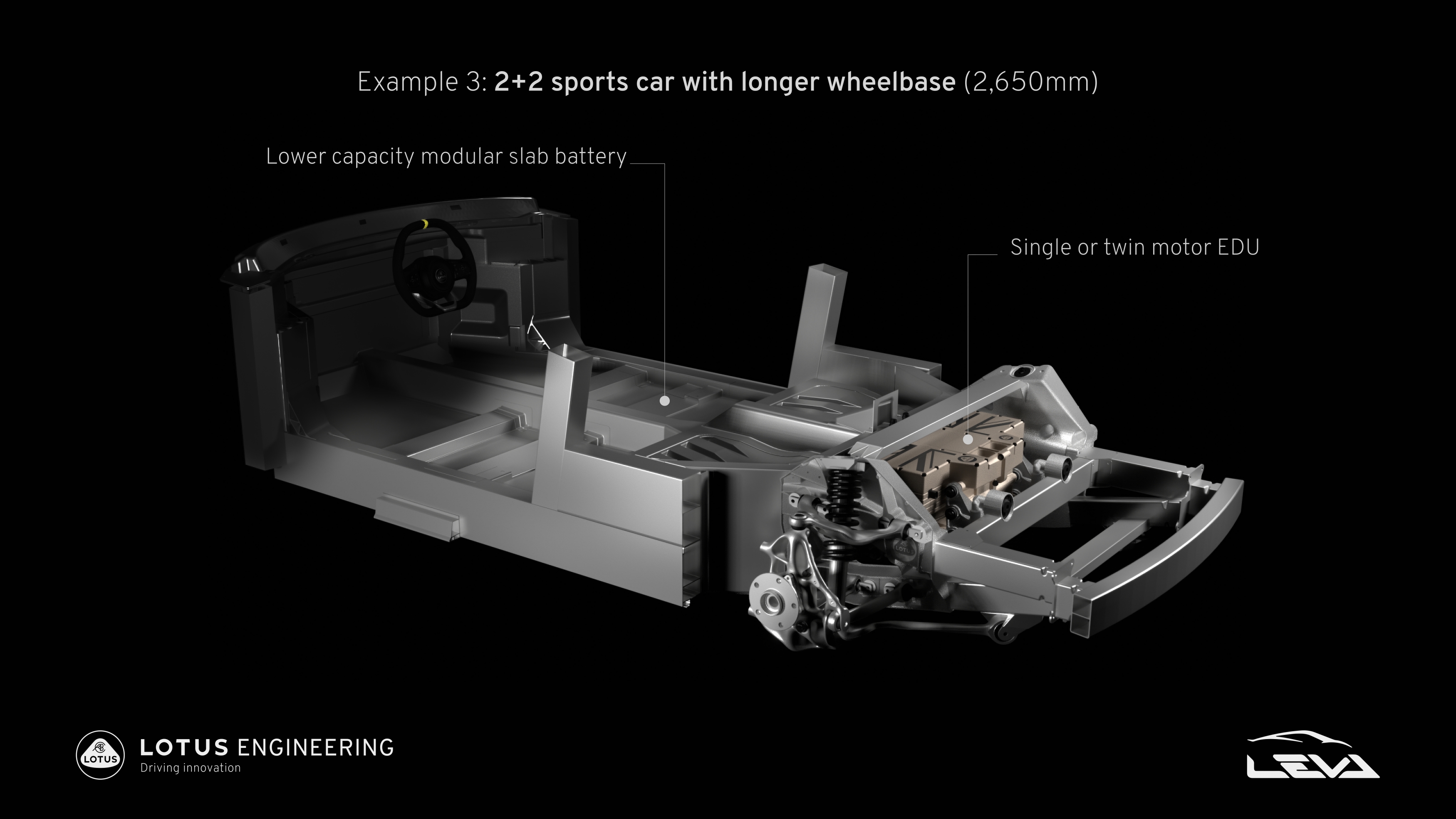

A new animation from Lotus reveals how the technology will form part of the new electric sports car chassis, illustrating the versatile nature of this all-new Lotus-developed vehicle architecture. It is fully adaptable to provide a platform for a range of EVs with variable layouts, wheelbase lengths, battery sizes and configurations.

Two-seater
Minimum of 2,470mm
8-module / chest
66.4kWh
Single / 350kW
Two-seater
More than 2,650mm
12-module / chest
99.6kWh
Twin / 650kW
2+2
More than 2,650mm
8-module / slab
66.4kWh
Single / 350 kW or Twin / 650kW
As the animation shows, all three layouts feature a common lightweight die-cast rear sub-frame with multiple interchangeable components. This is the Project LEVA innovation, and it means a single vehicle architecture can accommodate two different types of battery configurations:
  • ‘Chest’ layout, where the modules are stacked vertically behind the two seats. A chest layout is a ‘mid-mounted power pack’, ideal for sports car / hypercar vehicle types where a low overall ride height and low centre of gravity are required, and as seen on the Lotus Evija pure electric hypercar.
  • ‘Slab’ layout, where the modules are integrated horizontally under the cabin. This is most suitable for vehicles where a higher ride height and a taller overall profile is required. It is often referred to as a ‘skateboard power pack’ layout.
The innovative new subframe features cylindrical battery cells for high energy density, with the option of a single or twin electronic drive unit (EDU) to support. Cold cure, spot bonding and advanced weld processes mean reduced environmental impact during assembly.
