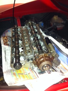

This is my Cam ladder upside down. The exhaust cam is on the left and the two inlets on the right of the picture.
The standard engine has an exhaust cam and an inlet cam.
The VVC has one exhaust cam and two seperate inlet cams, that are timed up by the ECU, Hydraulic Plunger and the VVC mechs, that sit on the end of the inlets.
You can take the VVC exhaust cam and pop it in a standard car but not the inlets. You could use a VVC cam and another inlet cam, but this would be a single inlet cam.
