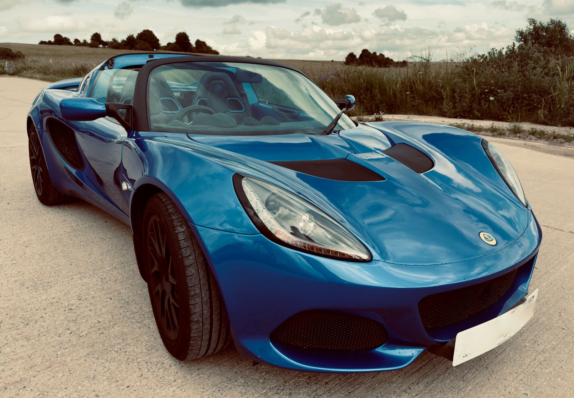

nick_t Posted July 9 Posted July 9 Hi, Apologies if this has been answered recently - I've just joined and couldn't find anything in the search. I've recently bought a 2018 Elise Sport 220 which I've been enjoying hugely. About the only thing I'd like to change is the sound, and I've read that a TRD airbox is a big improvement. The problem, of course, is I have also read they are no longer made and I can't find any in stock either. So does anyone have any suggestions: - where might I be able to find one? - any alternatives that achieve the same thing? Thanks, Nick Quote
