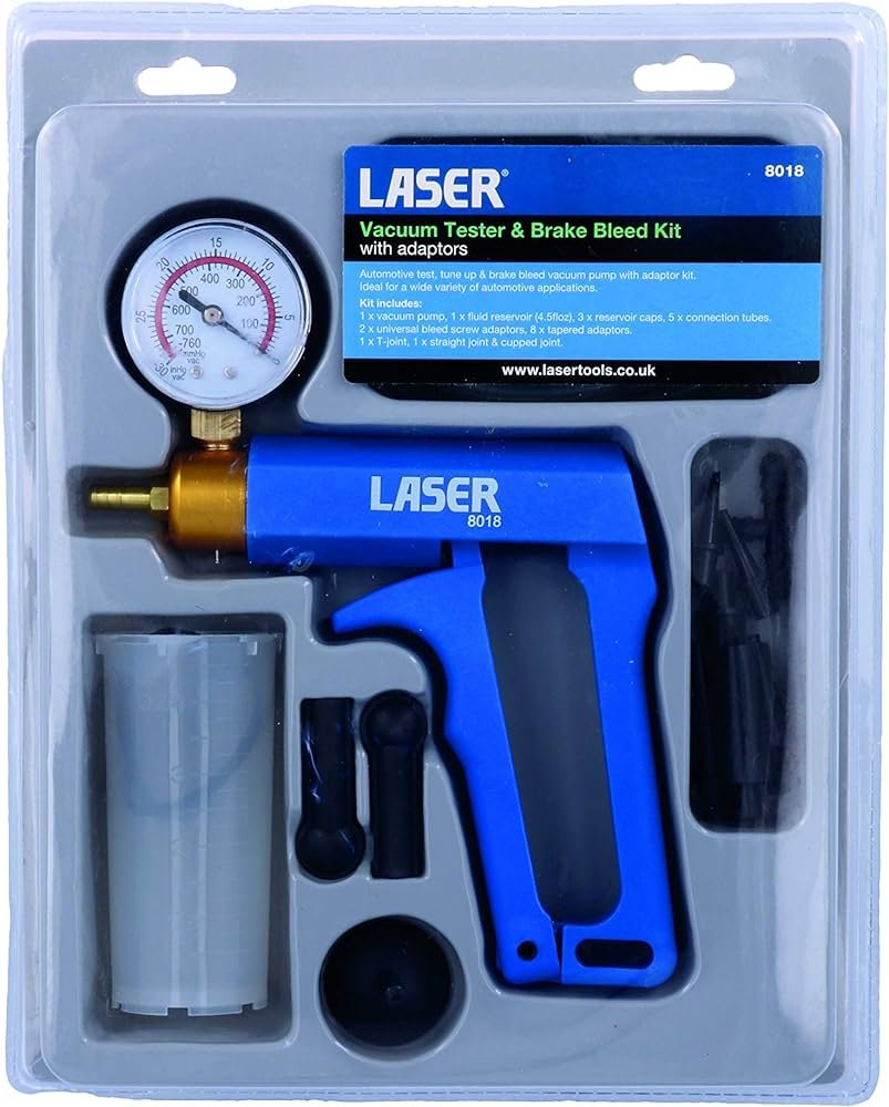

LotusDave Posted April 28 Share Posted April 28 Thought i'd share my recent experience. So I bled my brakes the other month prior to this years (2024) first track day. Standard 2 person method. But the pedal just felt a little spongy afterwards despite the amount I bled it. So much so I struggled to heal and toe on the track afterwards, as the pedal travel was too far down to get my heel up on the accelerator. I recently bought the LASER brake bleed kit (picture below) and used it to re-bleed the brakes. The difference was night and day, easy to do with one person and pedal hard as a rock. If anyone does regular trackdays on here, I highly recommend this tool. That's my 2 cents :-) FYI: I'm using Dot 5.1 Mobil fluid, if anyone was wondering. 1 Quote Link to comment Share on other sites More sharing options...

MrWill Posted May 6 Share Posted May 6 On 28/04/2024 at 15:45, LotusDave said: Thought i'd share my recent experience. So I bled my brakes the other month prior to this years (2024) first track day. Standard 2 person method. But the pedal just felt a little spongy afterwards despite the amount I bled it. So much so I struggled to heal and toe on the track afterwards, as the pedal travel was too far down to get my heel up on the accelerator. I recently bought the LASER brake bleed kit (picture below) and used it to re-bleed the brakes. The difference was night and day, easy to do with one person and pedal hard as a rock. If anyone does regular trackdays on here, I highly recommend this tool. That's my 2 cents 🙂 FYI: I'm using Dot 5.1 Mobil fluid, if anyone was wondering. Thanks for the tip. Just ordered. Going to give it a go. Same as you I have a little bit a free travel in the brake pedal sufficient to take the pedal below the loud pedal when braking hard at the point i want to heel. Will see if this takes that away. 👍 1 Quote Link to comment Share on other sites More sharing options...
SamG40 Posted Thursday at 15:58 Share Posted Thursday at 15:58 Will get one, given up with the ezibleed. Bloody thing had a mind of its own the last time I tried to use it and ended up with brake fluid coming out of the valve you put on the tyre. When they work they are great but they seem to last two minutes. Quote Link to comment Share on other sites More sharing options...

Lithopsian Posted Friday at 19:57 Share Posted Friday at 19:57 I use essentially the same bit of kit. Makes changing the brake fluid very simple. Not so sure it is the best way to get air out, but it will certainly pull the fluid through. Quote Link to comment Share on other sites More sharing options...
