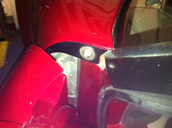

Anyway, my front clam is almost ready to come off except for one stubborn bugger of a bolt. It doesn't look corroded and I've applied plenty of penetrating fluid. It just feels bloomin tight! Any suggestions for getting it moving? I'm worried if I attack it any more I'm just going to end up rounding it out. mad.gif
Posted
Keith,
I have yet to remove my front clam so can't really advise you too much on that one other than to make sure you've got a good allen key that's not rounded off. I like to use hexagonal bits fitted into a socket wrench where possible.

Well done BIs. I'm hoping for similar help...
So I'm lagging a bit behind all the other suspension refreshers... but I don't get my parts until Christmas Day.
Hey Keith. If everything was smooth, it wouldn't be fun at all.
With regards to your bolt, make sure you use good hex bits on a wrench to ensure that you have maximum control and reduce the possibility of slipping out and damaging the head. If you are using something smaller, you may find by switching to a socket wrench, its not as tight as you think.
