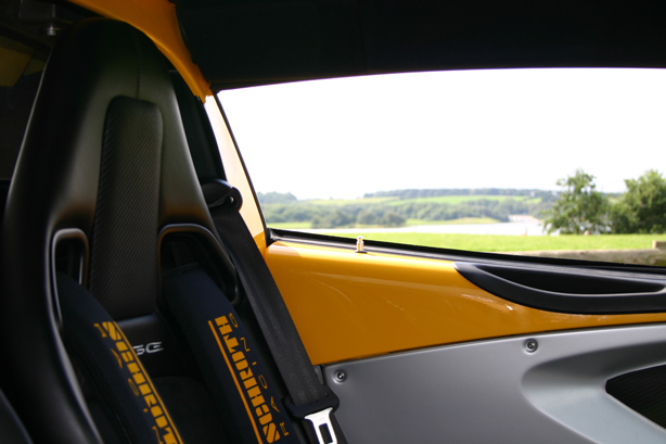

chris_h Posted September 23, 2004 Posted September 23, 2004 I have both on my S2 Exige. The normal belt is much easier when just popping to the shops, but i feel i can drive the car much harder with the 4 point on. I'm going to the Notts/ Derby pub meet on thursday 30th if you want to have a look. Chris

Bramble111s Posted September 24, 2004 Posted September 24, 2004 Chris, Boy your exige seats look fine, any chance of a full seat pic! Also are they S2 exige black leather seats? if not then whats the full name, I would really like to get some of those! thanks
Mark H Posted September 24, 2004 Posted September 24, 2004 Chris, Boy your exige seats look fine, any chance of a full seat pic!Also are they S2 exige black leather seats? if not then whats the full name, I would really like to get some of those! thanks Pictures of the seats in this thread: http://www.midlandslotus.co.uk/forum/index...?showtopic=2338
