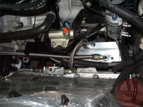

chorton_1 Posted May 13, 2006 Posted May 13, 2006 I've not heard of that before. I would be pretty surprised if corrosion were true given that the sealing face isn't open to atmosphere but I don't know for sure. Similarly, it's difficult but not impossible to cross-thread to the point of causing the problem. If they are replacing the line into the tank and charging labour then that potentially isn't a 2min job (I would think you have to drop the tank, but maybe you can do it through the access panel). Would be worth posting the question on SELOC if you haven't already due to the wider experience on there. Its just the pipe between the fuel pump and fuel filter, so I don't think there is a lot of labour involved as they are changing the filter for service. Thanks anyway Yep but the fuel pump is in the tank. The fuel lines disappear through the bulkhead (see pic) and attach to the top of the pump. The only way to get to that is via an access panel on the inside of the car. I'm not sure what you need to do to get enough access - possibly remove the seat. It's not a big job but it isn't a case of just pulling items out of the engine bay. And as a schematic layout....
