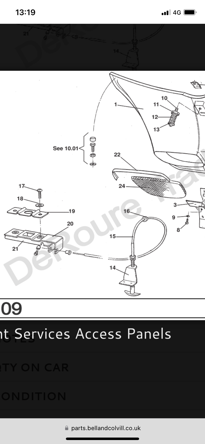

winthattt Posted July 1, 2024 Posted July 1, 2024 Not sure if you mean front of back, if not be keen on cutting holes in my car! If you can see the latch I would have thought a stick is your friend? If you can see where the cable should be pulling, push it with your stick from the other side. If you look on the bell and Colvile website you should be able to see you latch in the parts catalogue and work out where to push it.

Jonathan E Posted July 2, 2024 Posted July 2, 2024 Take the front drivers wheel arch liner out and you can reach the catch. Only problem with this method is you will probably need the locking wheel nut key that is stored under the bonnet🙄, it is doable though.
Mutley00 Posted July 2, 2024 Author Posted July 2, 2024 2 hours ago, Jonathan E said: Take the front drivers wheel arch liner out and you can reach the catch. Only problem with this method is you will probably need the locking wheel nut key that is stored under the bonnet🙄, it is doable though. Thankfully no locking wheelnuts matey 👍. I can see the spring and catch - do I need to pull something to mimic the role of the cable or shove something. Boy am I technical!!
Jonathan E Posted July 2, 2024 Posted July 2, 2024 It’s a long time since my last S1, but imagine your sitting in the drivers seat, the cable pulls the catch to the right, so if your looking in from the drivers side wheel arch you should push the catch away from you(see pic) it sometimes helps to have somebody apply a little downward pressure to the bonnet when you push the catch👍
