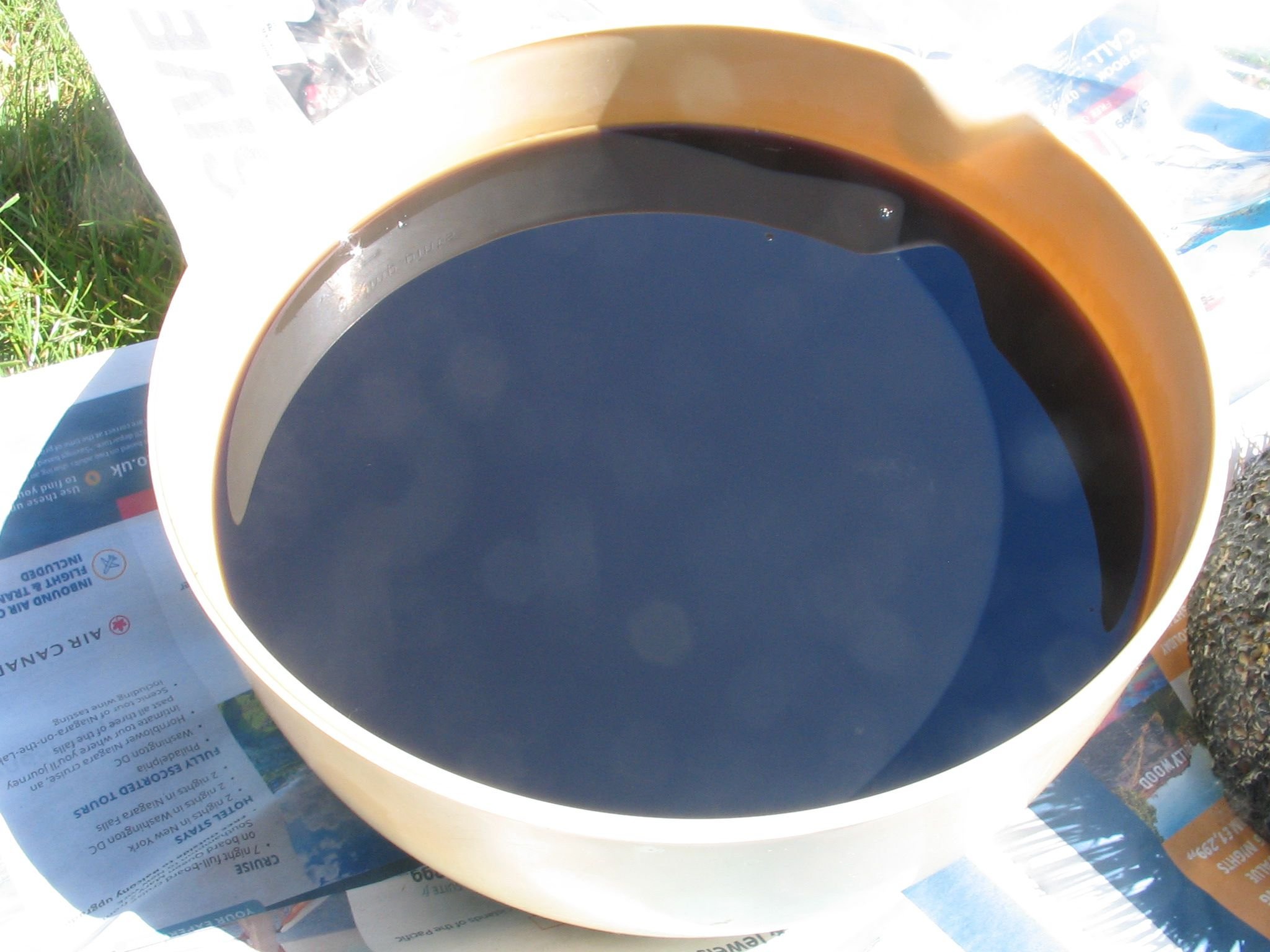

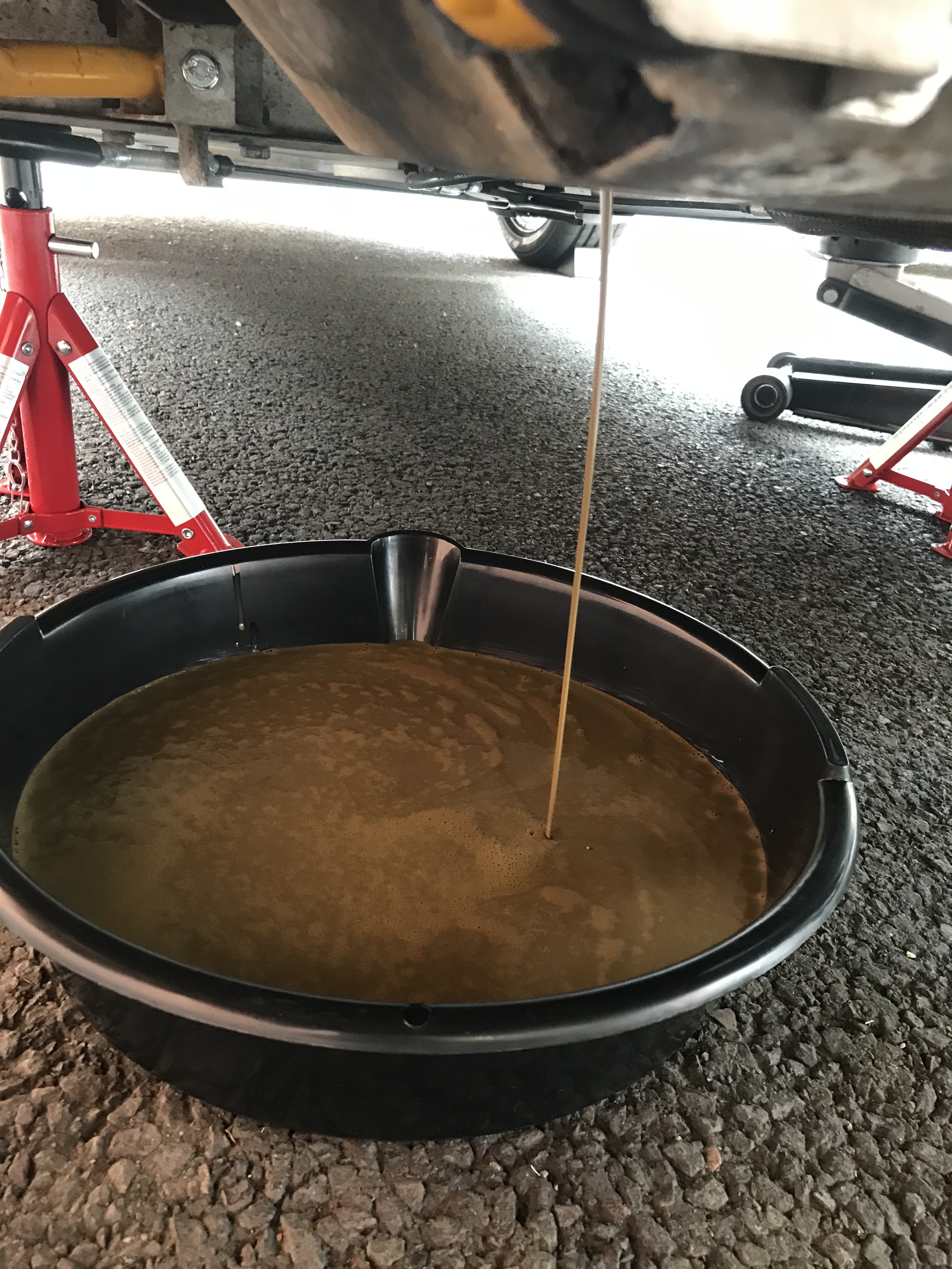

Yeah I think that gearbox oil wanted to be changed 🤯
The colour is a bit off in the photo but it looked like a milky coffee!
2.something litres of MT90 in ready for tomorrows drive
Posted
It might have been contaminated with water.  I've seen worse cases where there seemed to be more water than oil.  Mine came out after 20 years looking very clear, but darker than new.
Posted
After 7 years in the elements I’m certain water got in there, the cloudiness was almos an emulsion.
luckily I only drove about 50 miles like that, the MT90 change should do me another few years

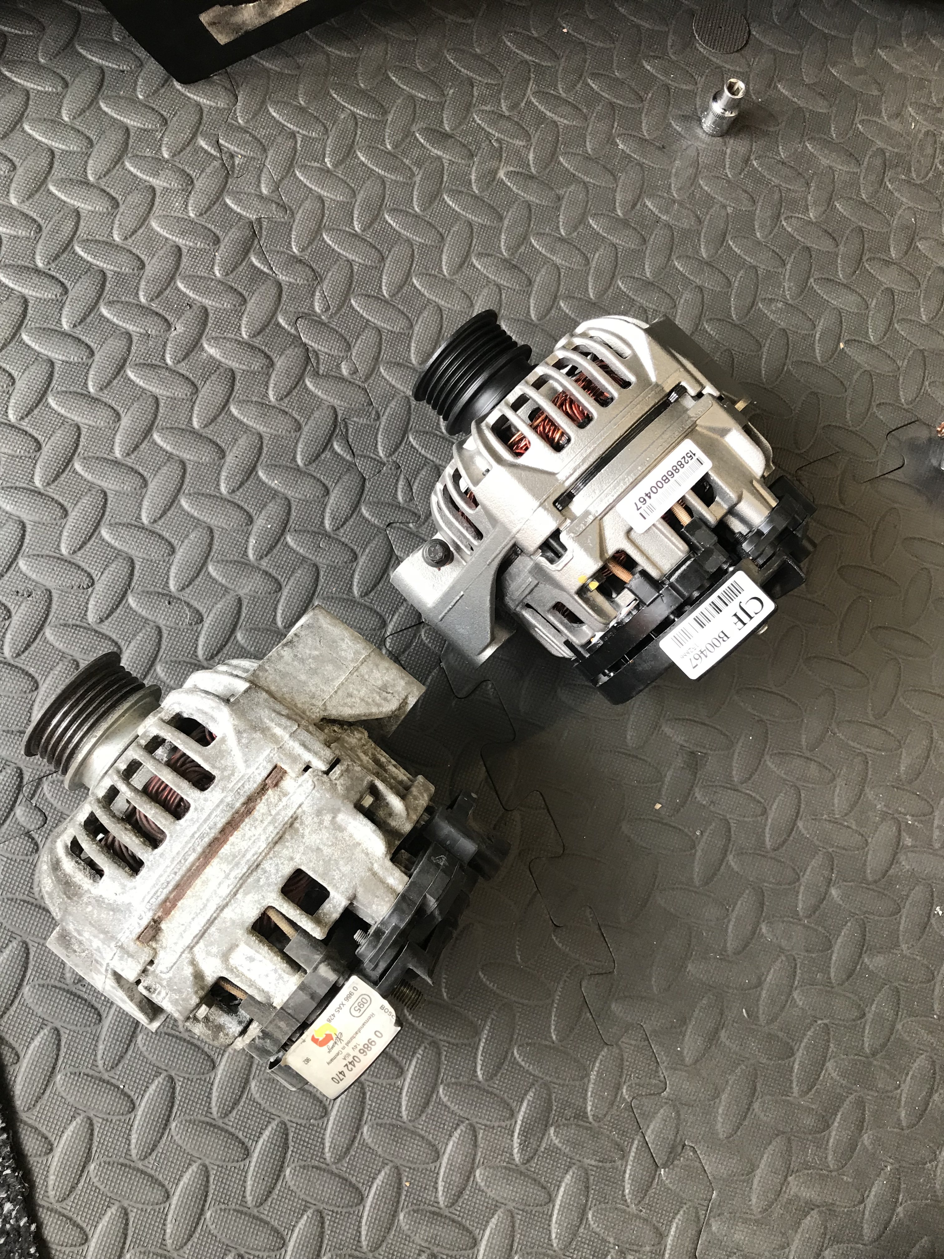

I think I did the right thing changing the alternator, it was charging the electrics fine but something was amiss…
The replacement was a remanufactured Bosch 0124225011 from CJF Rotating Electrics in Hednesford (near Lichfield) it was £80 outright (no surcharge or old alt swap).
I’ll take my old one to them when I’m next at the in laws and have it refurbished as a spare

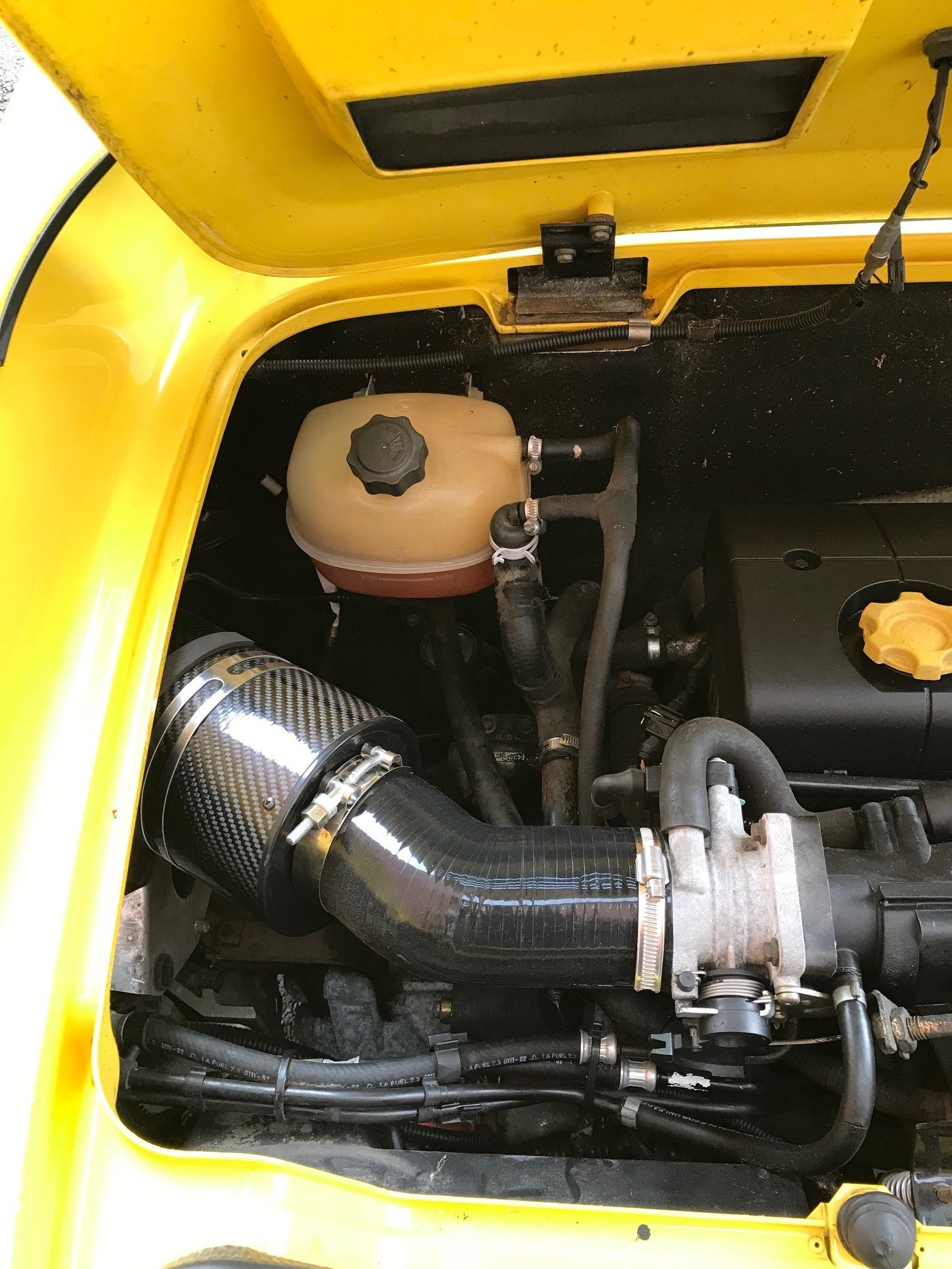

I've also changed a couple of bits, including the stock airbox for a BMC filter - just for a little induction noise really

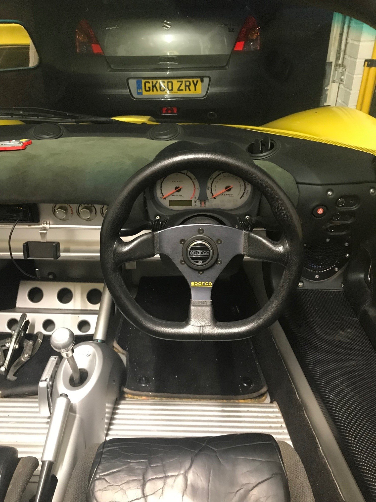

Changed the stock S2 wheel for a flat bottomed 320mm Sparco - Lotus horn push on route!

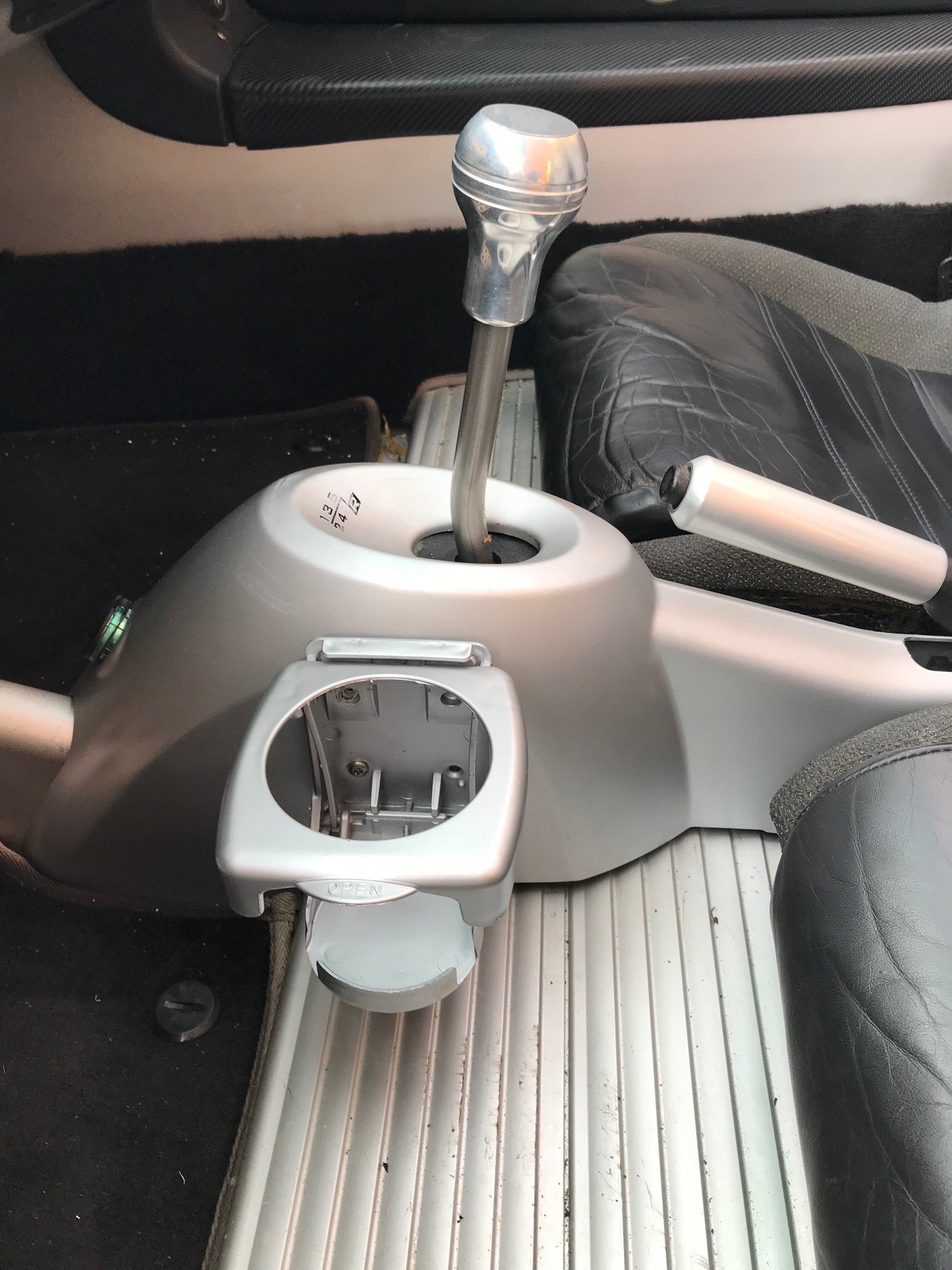

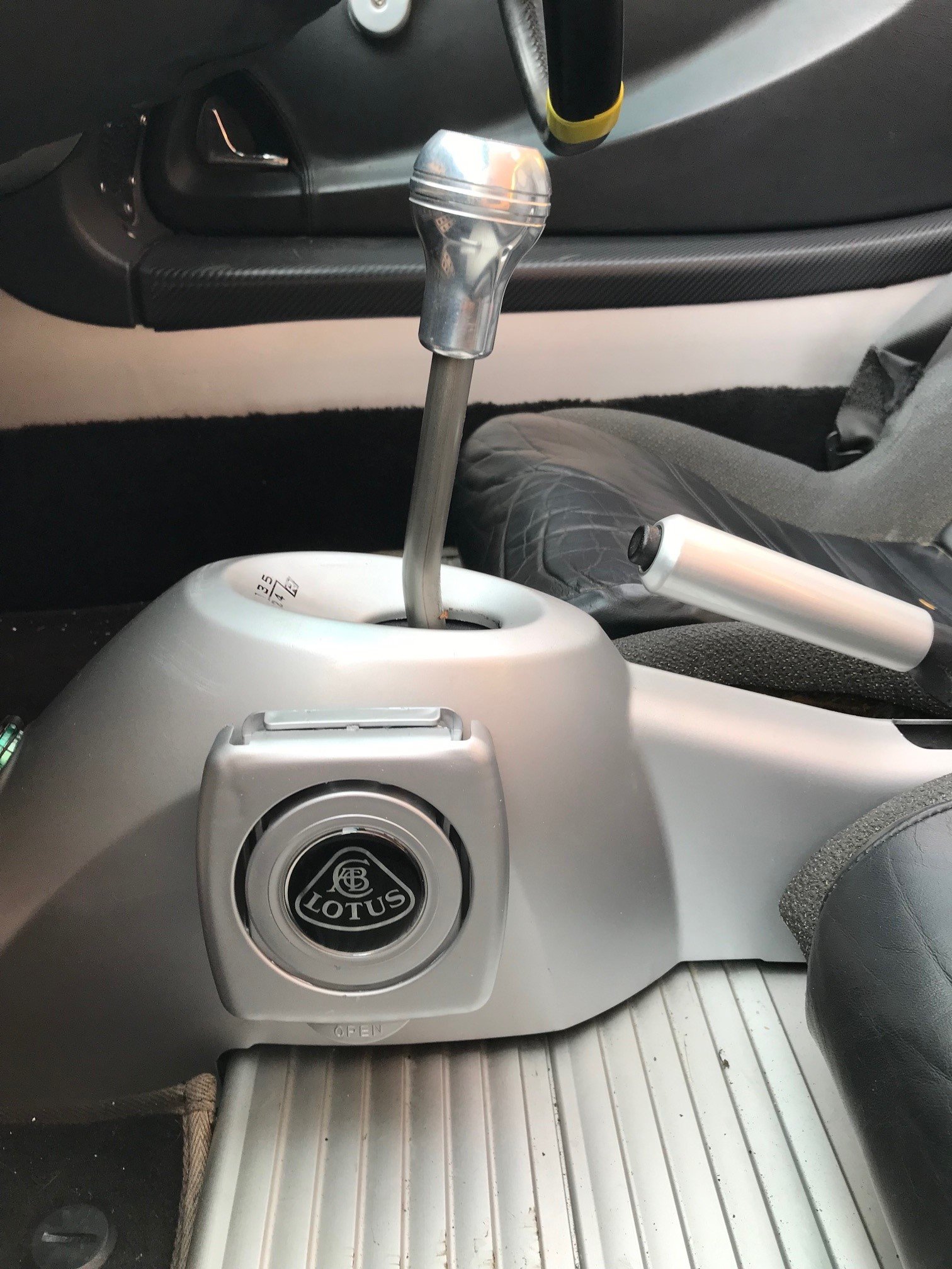

And to appease the wife I adapted a cheap cupholder to fit the elise console -
We've got a couple of trips booked and she wanted a coffee location, this is easily removable as it uses the side torx screw for mounting as well as a little double sided tape.

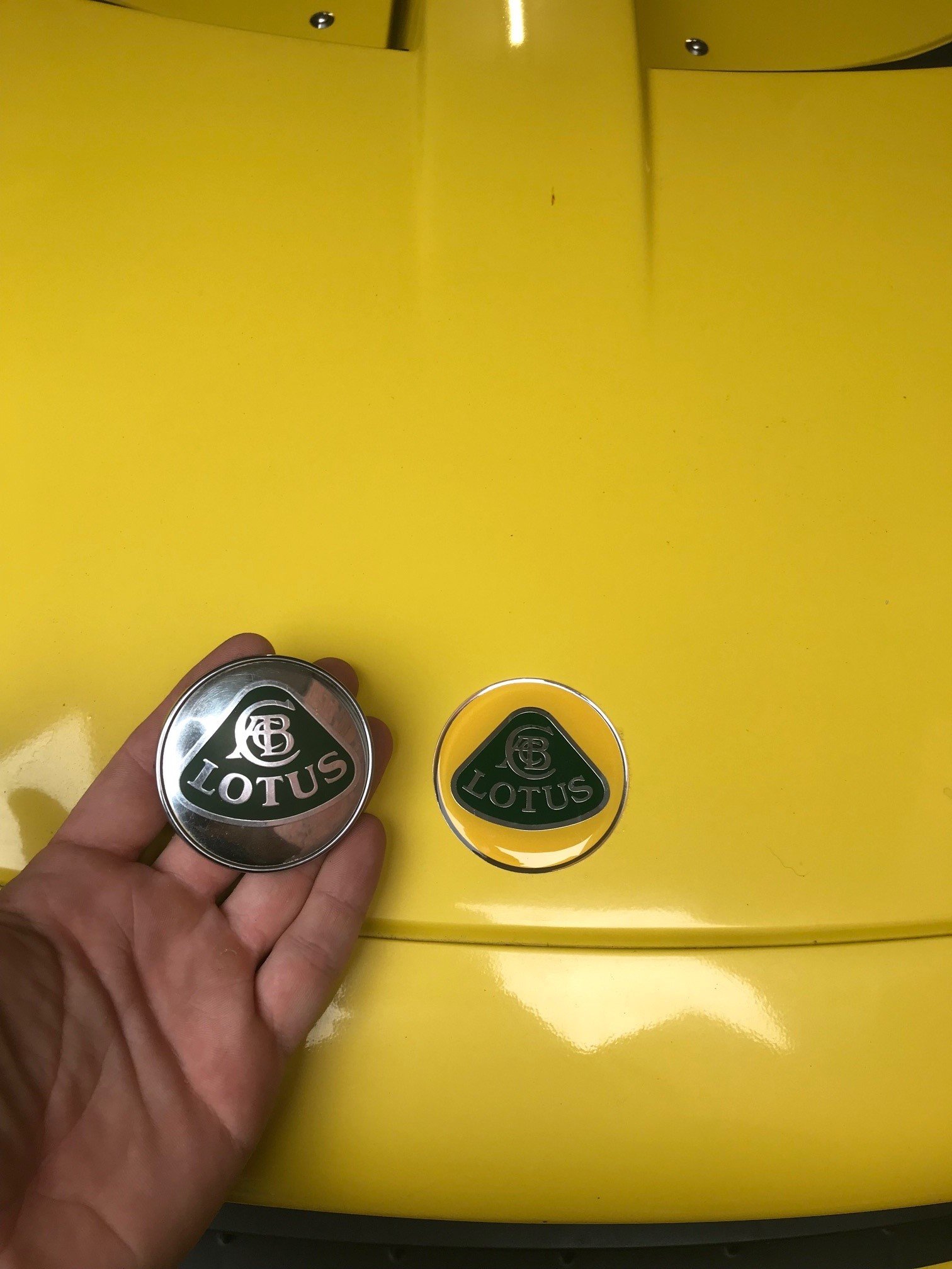

Finally changed the faded replica badge for a decal from Dan @ Divinehandicraft - I'll get a proper badge once the bodywork is sorted.

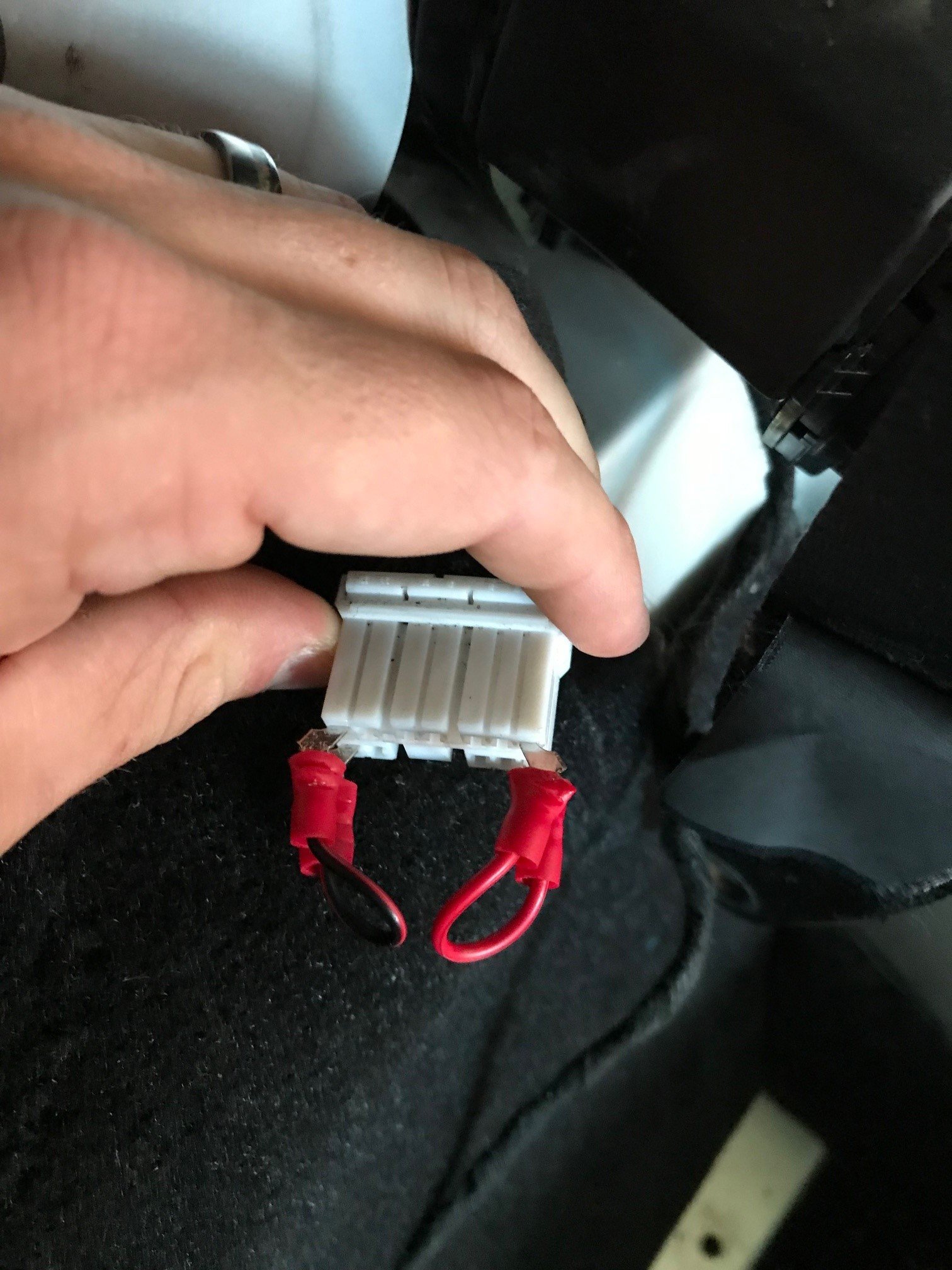

I was booked in with Dan at HPE auto yesterday for geo and corner weighting, but when i got in the car at 6:45am... nothing! She wouldn't start.
No cranking attempt and the fuel pump wouldn't prime either, after 30 minutes of trying different button pushing, disconnecting the battery and pushing the car out of the garage in case of radio interference, I decided it was the immobiliser at fault.
I have no idea why it's decided to die now, when it could have over the last seven years of being sat, but two bits of wire and some snipped off spade connectors and she ran again: bridging.thumb.jpg.1059207ee287f616f748adb70eacb159.jpg#
Eliseparts immobiliser plug arriving tomorrow as a more permanent solution.
Posted
41 minutes ago, Lithopsian said:
I'm intrigued by that badge.  Never seen anything like it.
The silver one?
Posted
45 minutes ago, Virgiltracy said:
The silver one?
Maybe I'm seeing it wrong.  It looks transparent in the photo, which really would be odd!
Posted
Ah, no not transparent, I think it was just a cheap replica badge which had a silver base, unfortunately seven years in the elements caused the yellow to fade away
