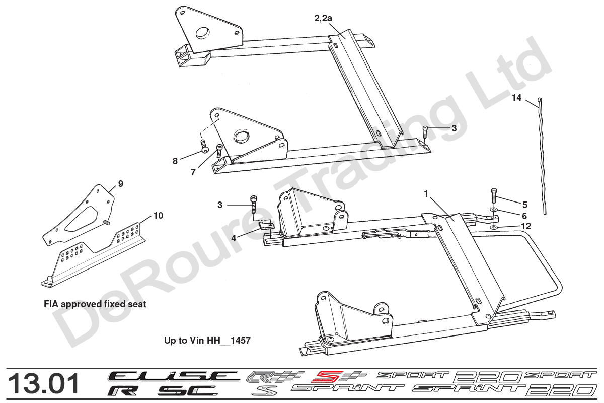

After a fair amount of googling I found this. Item number 14 isnt on my car because it is a later modification from lotus.

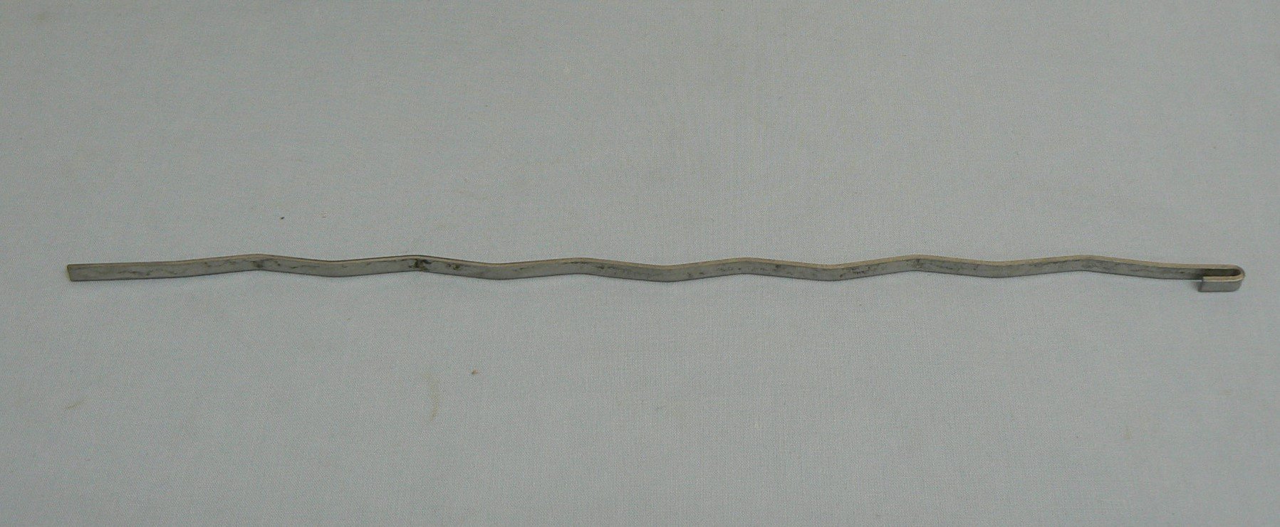

Here is the modification
CE57BB89-1212-4EDA-B4D4-1529131EC36F.thumb.jpeg.b02c0a3cbd86001421000d863e87258f.thumb.jpg.627f49a072e03a26a4afe979083d3370.jpg
Its from this thread
https://www.thelotusforums.com/forums/topic/92601-exige-s3-loose-drivers-seat-thread/#comments
If you go to about page 6 on the topic you will find reference to it.
and according to the people who have fitted them it works a treat. Many have had them fitted under warranty. bit late for me ☹️
Trouble is its they are £41.94 from here.
https://www.sjsportscars.com/parts-and-accessories/A142V0001K.htm
Even more through the lotus parts site Deroure
Just wondering if its worth trying to make a pair.
Cheers Andy

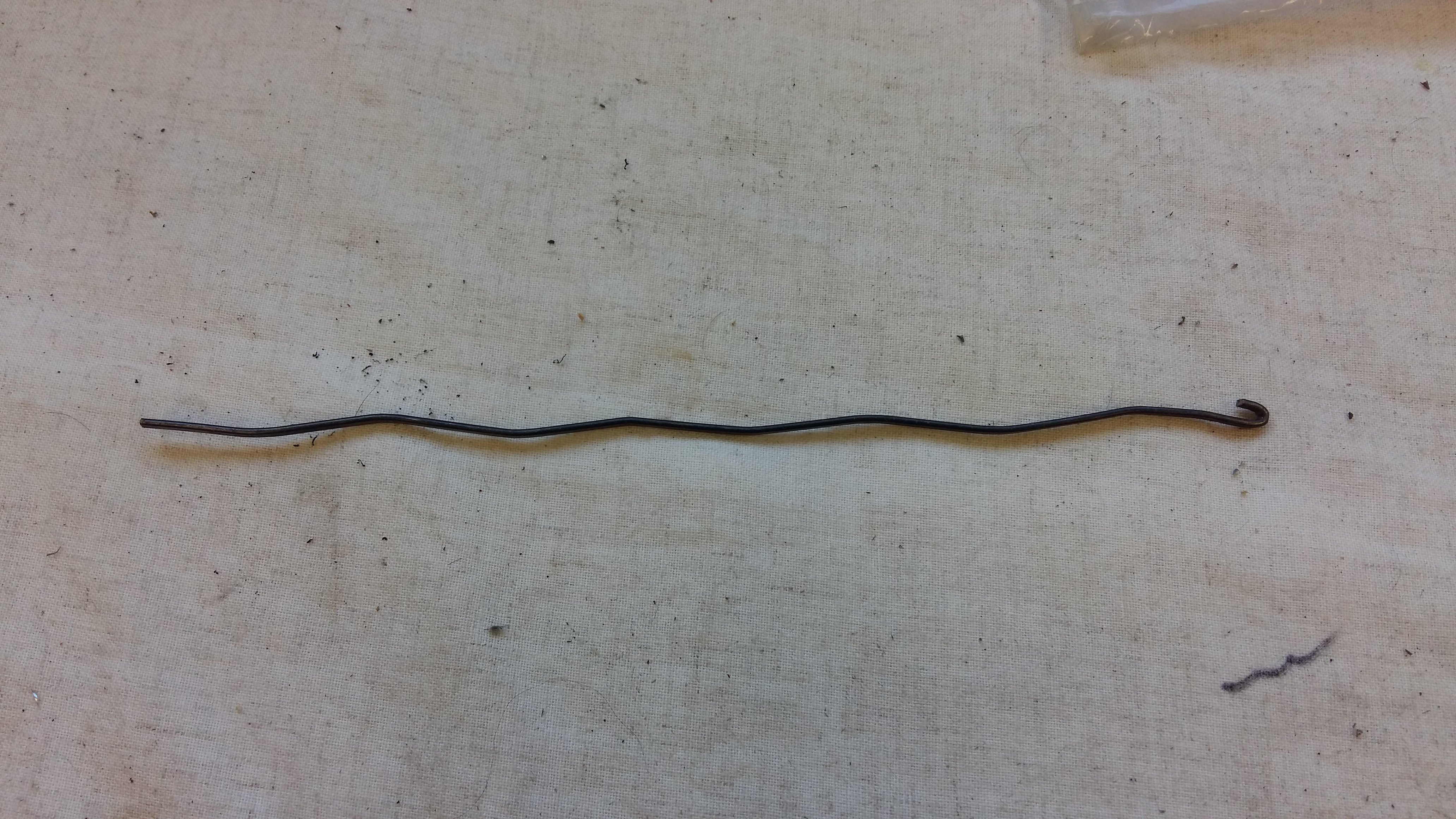

I have had my seats again today after the peaks run and I have managed to make some.
Details later!!
First impressions are that it works. The seat is nice and tight now.
  • 2 weeks later...
Posted
Hi
Almost forgot about this.

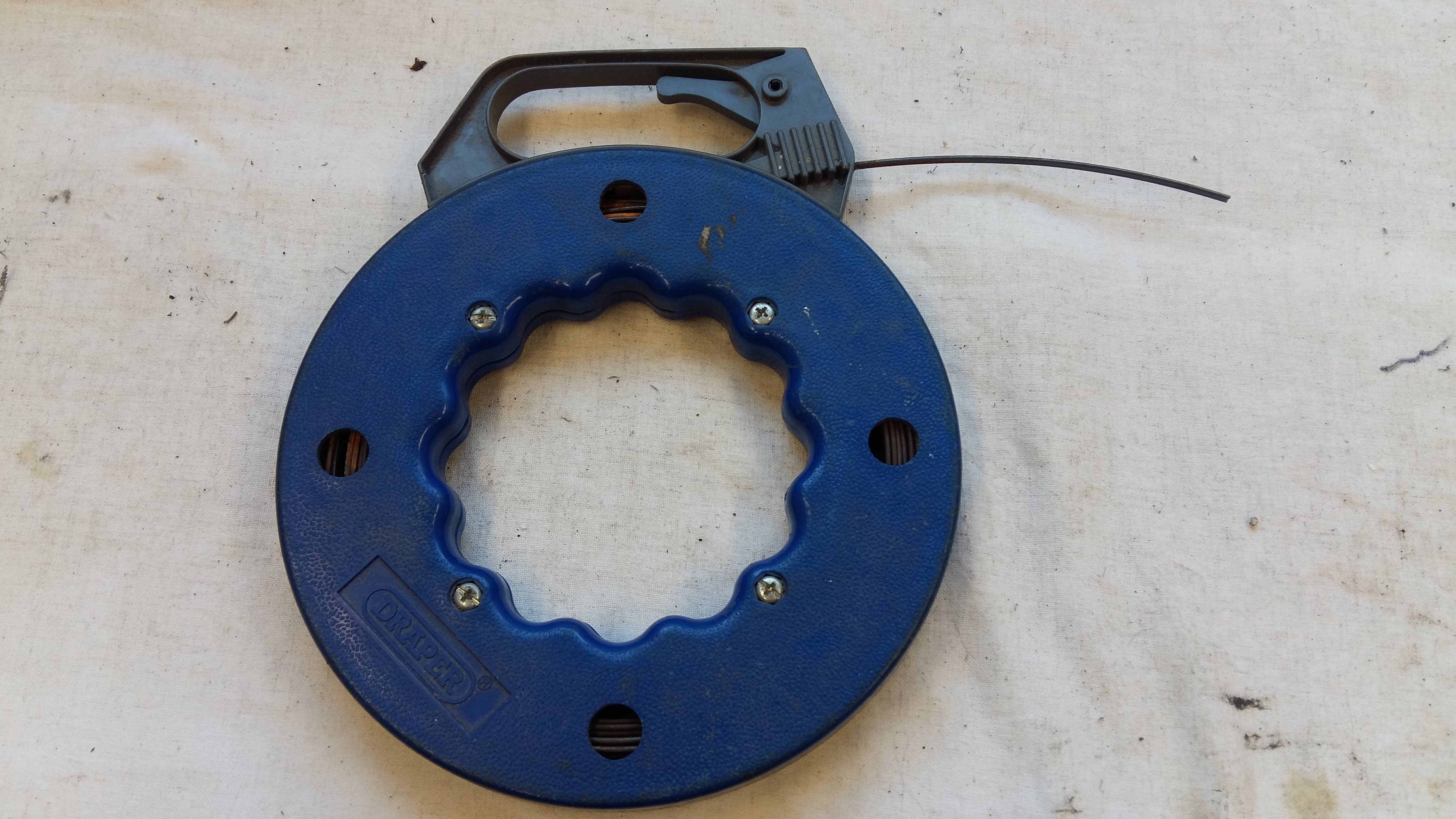

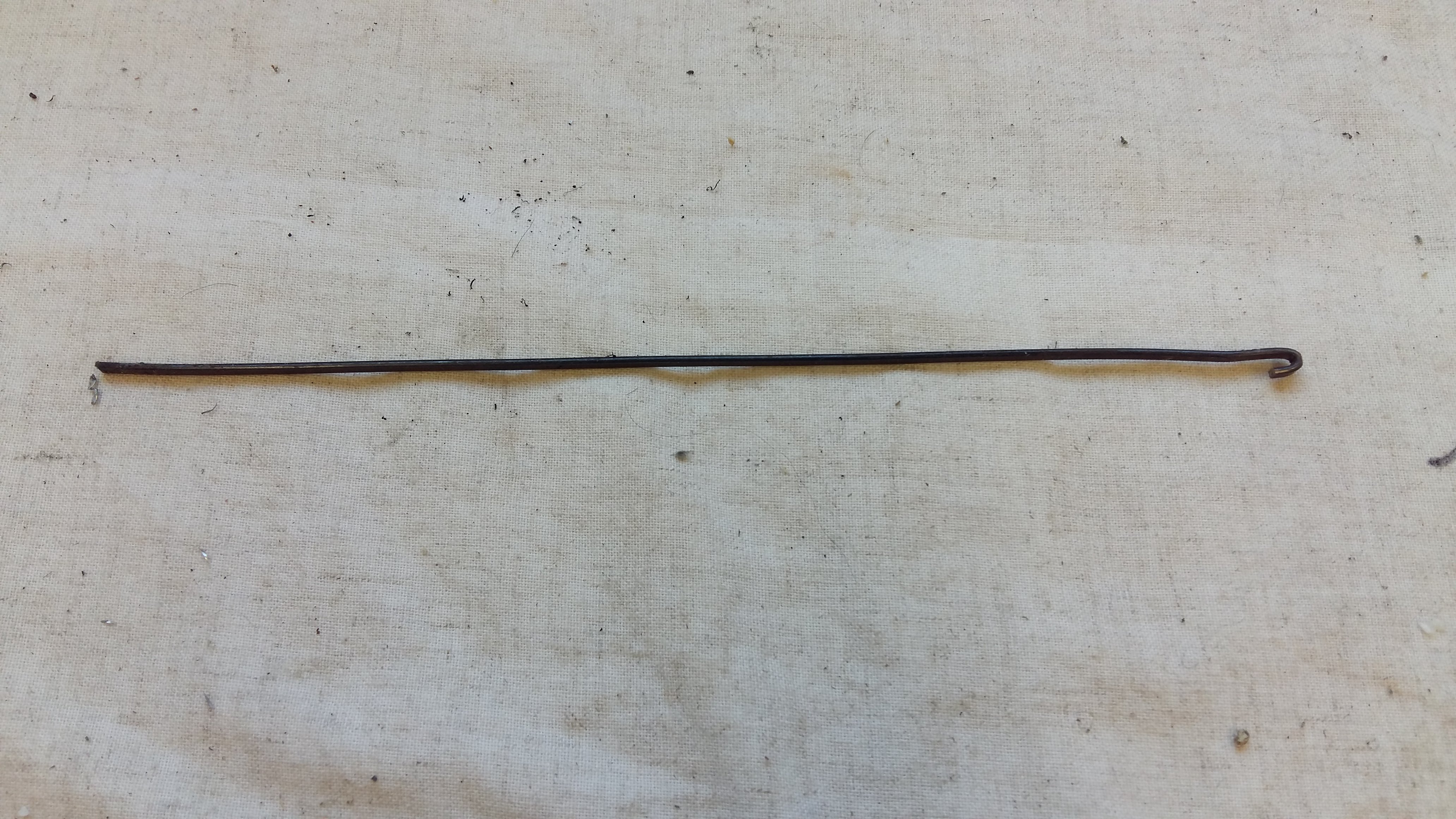

This is the material I made the seat runner tensioner out of.
It is an electricians draw tape for conduit. I am aSparky by trade.
Kinda lucky really because this was due to be thrown out as it was going rusty in the back of the garage.
It is made of spring steel and if you are not careful it will snap when trying to put a sharp bend into it.
This was the first try at making the tensioner.
Unfortunatly I didn't make it long enough, I forgot about having to bend the other end up once fitted.
But I,m sure you get the idea.
