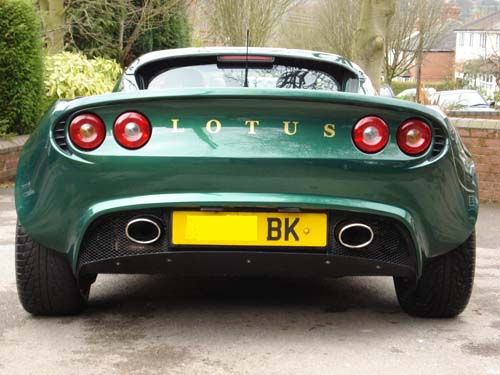

hi jo
i fitted my towing eye and painted colour of wheels(gold) as an aid to stop people reversing into my car and damaging clam. if the other car has low bumpers it helps (eye had 2 skuffs on it when i sold it, suggesting 2 contacts) but is no use if a higher car reverses into you.
also i removed and sprayed my diffuser black when i fitted front splitter( in black ) to match. i think it looks great and "hides" the back end well, particularly if your exhaust grills are done same colour.
it was a long job, remove diffuser, major clean with variety of cleaning products, then some alumi prep paint, so paint would key to it, rub down with fine sandpaper, then 3 coats of hammerite smooth. new stainless bolts to fix and away you go. you do need to keep it touched up !
worth it in the end thou.

I'm going to spray my rear diffuser black to match wheels & grills. I wanted to get hold of some new fixings though. What I havent found are the clips that go on the inside of the rear clam that hold the bolts in place. does anyone know where I can get these from?
Edit: Found them! lol Here:
clicky

Posted
I use the Hammerite spray. Works just great and get a nice even coat. Gave my grills 3 coats just to be sure :clap:
