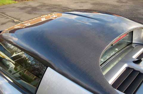

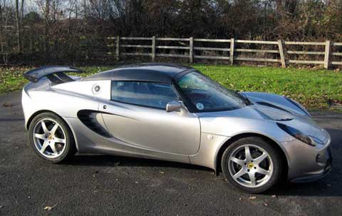

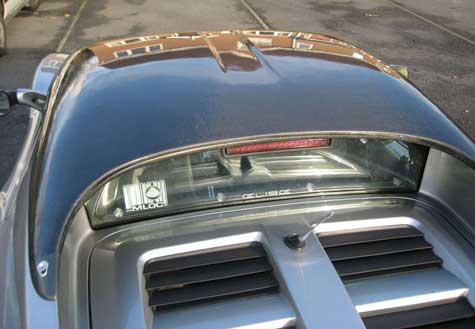

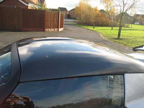

Smiley Chenit Posted November 14, 2007 Posted November 14, 2007 hey guys i/ve got an 02 long soft top so am intrested in this too. out of intrest what costs am i looking at for the lotus converstion and 2 tops eliseparts standard eliseparts cf cant access elisparts site at work,only mloc thx richbk p.s you got any pics of yours smiley Hi Rich The prices of the black gel coated top (inc VAT) is £938.83 but in the carbon fibre its £1169.13 on eliseparts. On my CF version, the skin on the inside of the car is also using the black gel coat so would look good if all done this way... but of course personal preference would be to pay the extra as it's well worth it for the difference in the looks. I really doubt that there is much difference in the weight between the two types though. Will take some pics and post back in a mo Cheers Tom
Smiley Chenit Posted November 14, 2007 Posted November 14, 2007 hey guys i/ve got an 02 long soft top so am intrested in this too. out of intrest what costs am i looking at for the lotus converstion and 2 tops eliseparts standard eliseparts cf cant access elisparts site at work,only mloc thx richbk p.s you got any pics of yours smiley pics as promised, rich :-D EDIT: oops... forgot to mention but if anyone is around the Derby/Notts monthly meet tomorrow then I will be there if you want a peak at the hardtop

Smiley Chenit Posted November 18, 2007 Posted November 18, 2007 Re the long tail hardtop shown... Is the inside lined (pictures if poss), and does it reduce the instantaneous misting that occurs within about 2-3 seconds at temperatuers below 5 deg c with the soft top? Ta! Hi natwest normally the inner skin is just gel coated fibreglass which has a high gloss finish - this would be the case if choosing the usual gel coated or carbon fibre option. However, I had spoken to Geary about having the interior trimmed and this could have been done but would need to have been sent to a retrimmer they use (specialising in Lotus, TVR and classic Morgans) and would have cost a £100 extra for a type of felt material but the biggest downside was the additional delay this would have caused of around 4-6x weeks as these chaps are always very busy. I have since had mine retrimmed with carbon leather which does reduce the road and engine noise whilst also (according to the girlfriend lol) makes the car a bit warmer than before too. To the front - There is a large flexible clamp which tightens to the bottom of the windscreen and spreads the load across the whole width (I'll take some pics when it's light tomorrow and post back then). Along with a heavy guide pin which keeps allows for accurate fitting on the corner of the screen - this slots into one of the spacers used the the soft top. This can be further adjusted by 4x screws attached to the bracket that the guide pin is mounted through. At the back - there are a couple of long bolts which are fitted into to the tails directly into the current bolt holes that secure the softtop mount part thingy (sorry don't know what it's called). Erm, as to the instantaneous misting... I'm really not sure about the difference that this makes as mine still does mist up fairly quickly (especially as it's snowing today) but it does seem to clear quite quickly and also stay clear(warmer) One other comment I will mention as big advantage is the much better fit with the hardtop with the windows due to the rubber seals which are supplied as these you add yourself ensuring the best possible fit for your car. Hope that this helps a bit but any further queries just fire away
