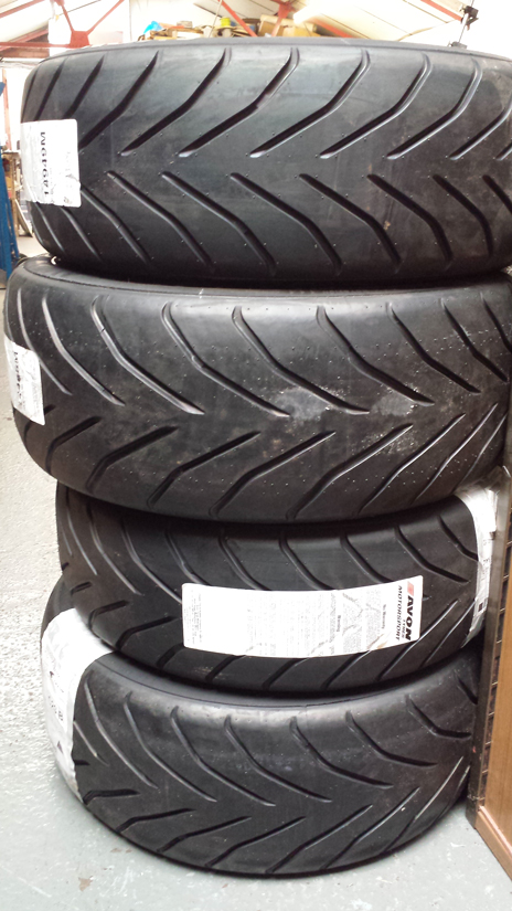

R.I.B. Posted July 23, 2013 Share Posted July 23, 2013 Just bought a set of Avon ZZR's, same tyres that they're currently using in the Lotus Trophy cup, apparently they're lapping quicker than the A048s and not wearing down as quick. Ordered them direct yesterday lunch time and arrived today. Spoke to a guy called Christopher who was really friendly and helpful and has even asked for me to give him a call back to let him know what i think. Another big bonus is that they're a lot cheaper than the A048s. Here's a link with the contact details incase anyone's interested.... http://www.lotrdc.co...paration/#tyres Just got to fit them on the my new rims and i'll be ready to try them out at Le Mans Can't wait Link to comment Share on other sites More sharing options...

R.I.B. Posted July 23, 2013 Author Share Posted July 23, 2013 For my s2 they cost me 577 Inc vat plus delivery. Haven't seen any recommended tyre pressures, I'll try starting at 24 / 26 cold and see how I get on. The tyre walls feel super solid. G - I'll need to borrow some skill from somewhere to get the best out of them but I'll give it a good go Link to comment Share on other sites More sharing options...
