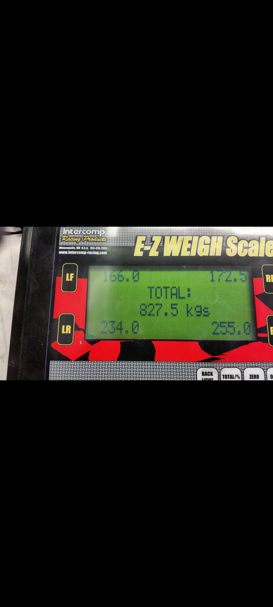

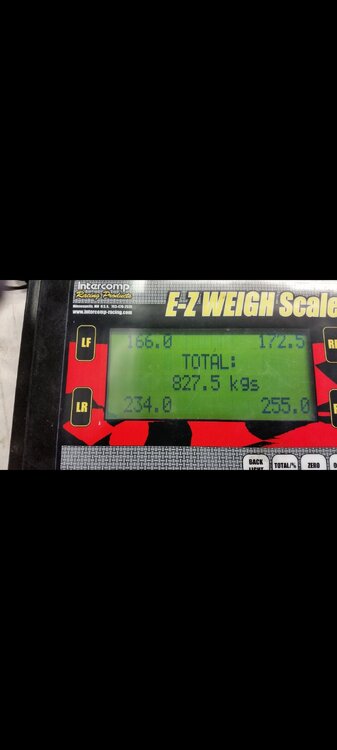

DeanB Posted November 25, 2024 Posted November 25, 2024 Interesting even though I know nothing about wheel frequencies! Can you recommend where I might find a good explanation online? I have added a photo of my corner weights with me aboard and about 10 litres of fuel. Quote

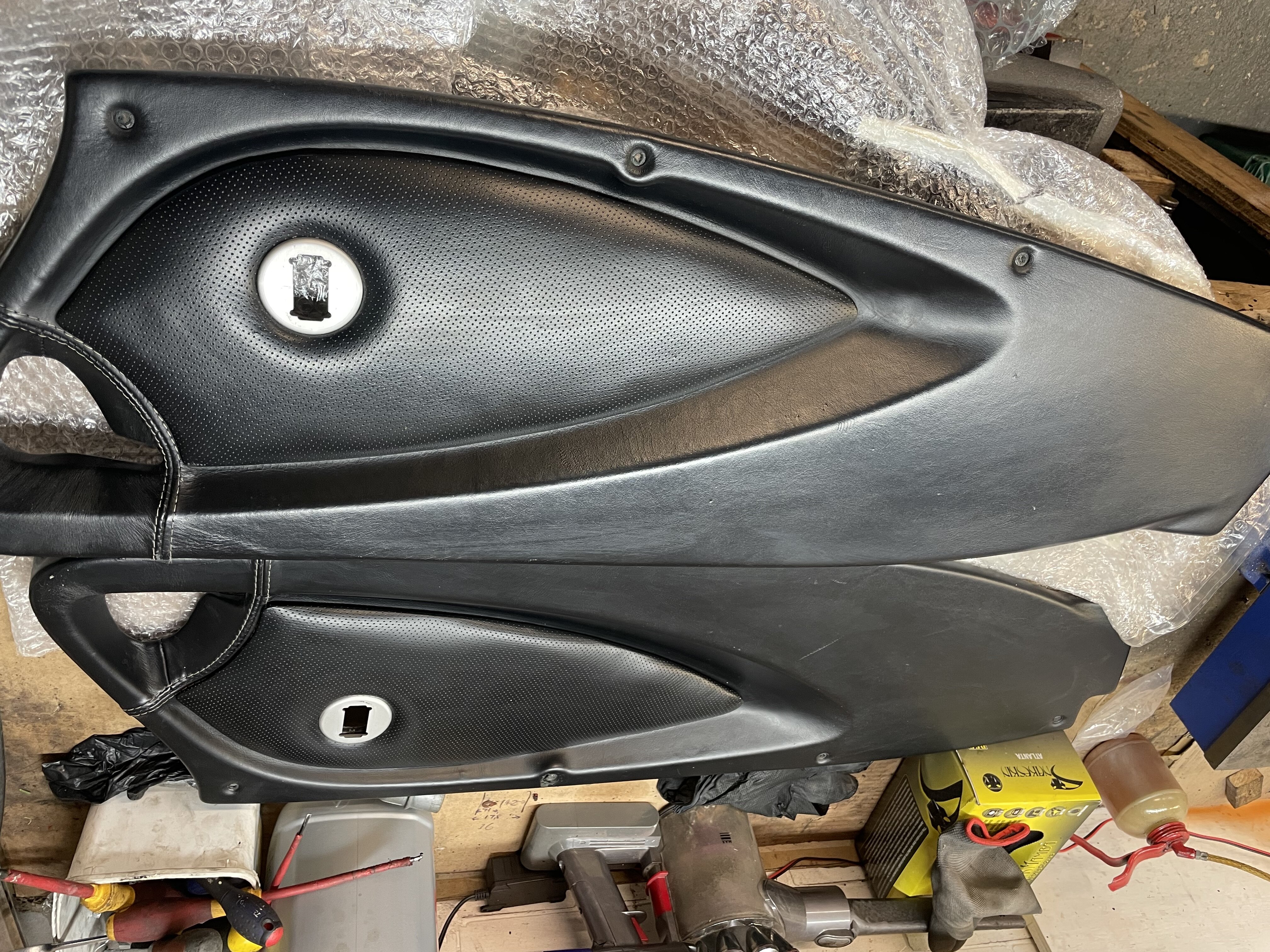

Andy wright Posted November 25, 2024 Author Posted November 25, 2024 And after all this talk of suspension, back to the seats and door cards . The cream interior has gone to a new home . £65 of eBay black doorcards arrived on Sunday and after a little tlc look like this . They are not absolutely perfect but pretty good: undamaged and almost without marks or scratches. Quote
DeanB Posted November 25, 2024 Posted November 25, 2024 2 hours ago, Andy wright said: Just answered my own question. S2 K series. And you have about 9-10 kg of fuel and X kg of you ( where 60< X<90) so your Elise is no more than 750kg. That is very light. I think it was 746kg with that bit of fuel in but no roof on or stowed. Quote
Andy wright Posted November 25, 2024 Author Posted November 25, 2024 Right. So you are 71kg. 😀😀😀😀 Quote
Andy wright Posted November 26, 2024 Author Posted November 26, 2024 Flippant comments aside. That means that the lotus o.e spring rates were absolutely on the money for that weight. I have access to corner scales so I will be interested to see what my 1ZZ powered S2 with me plus hardtop weigh in at . And the seats saga. I saw a pair of B5 Tillets on Facebook but on enquiry found they were sold. Sob. So went ahead and ordered a pair of Corbeau LE seats with the Lotus logo sewn in to the headrest. Then yesterday said Tillets popped back up again , so if anyone wants a brand new pair of Corbeau LE seats still in their boxes ( they haven’t arrived yet ) ……..😀 Quote
