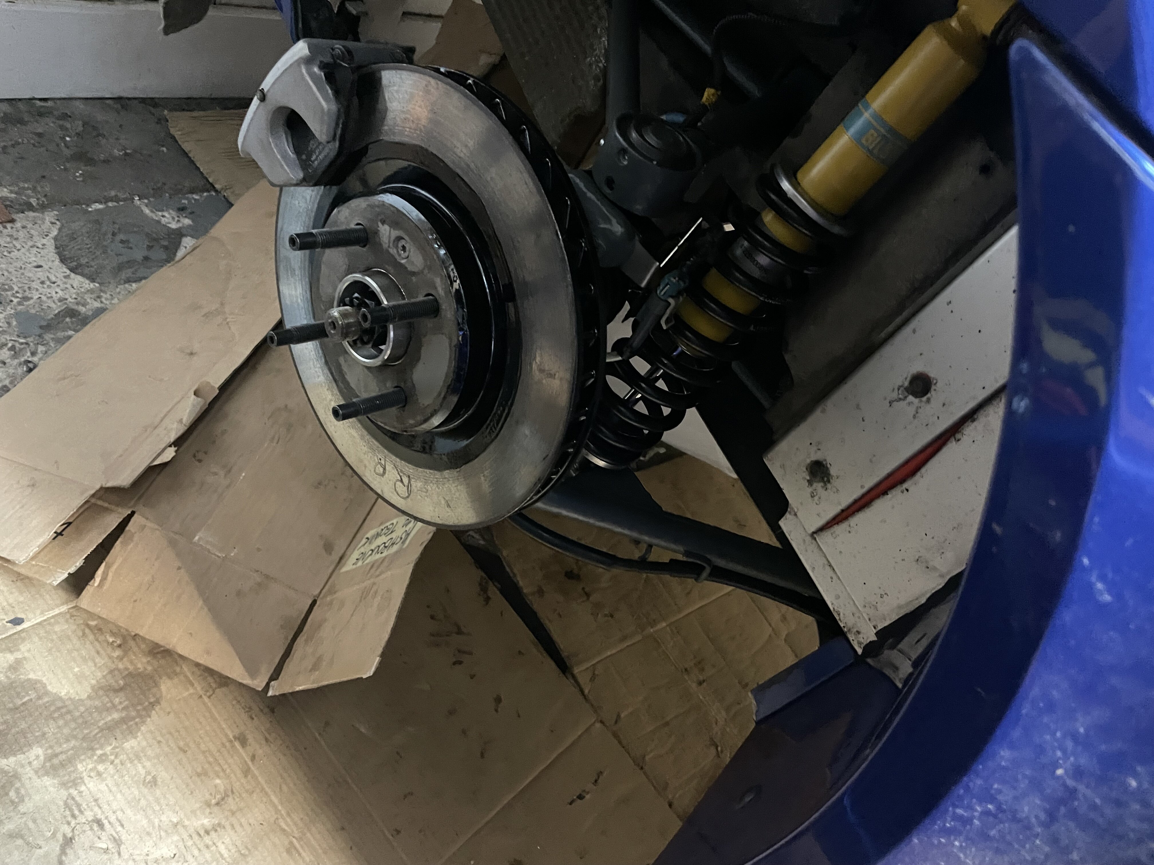

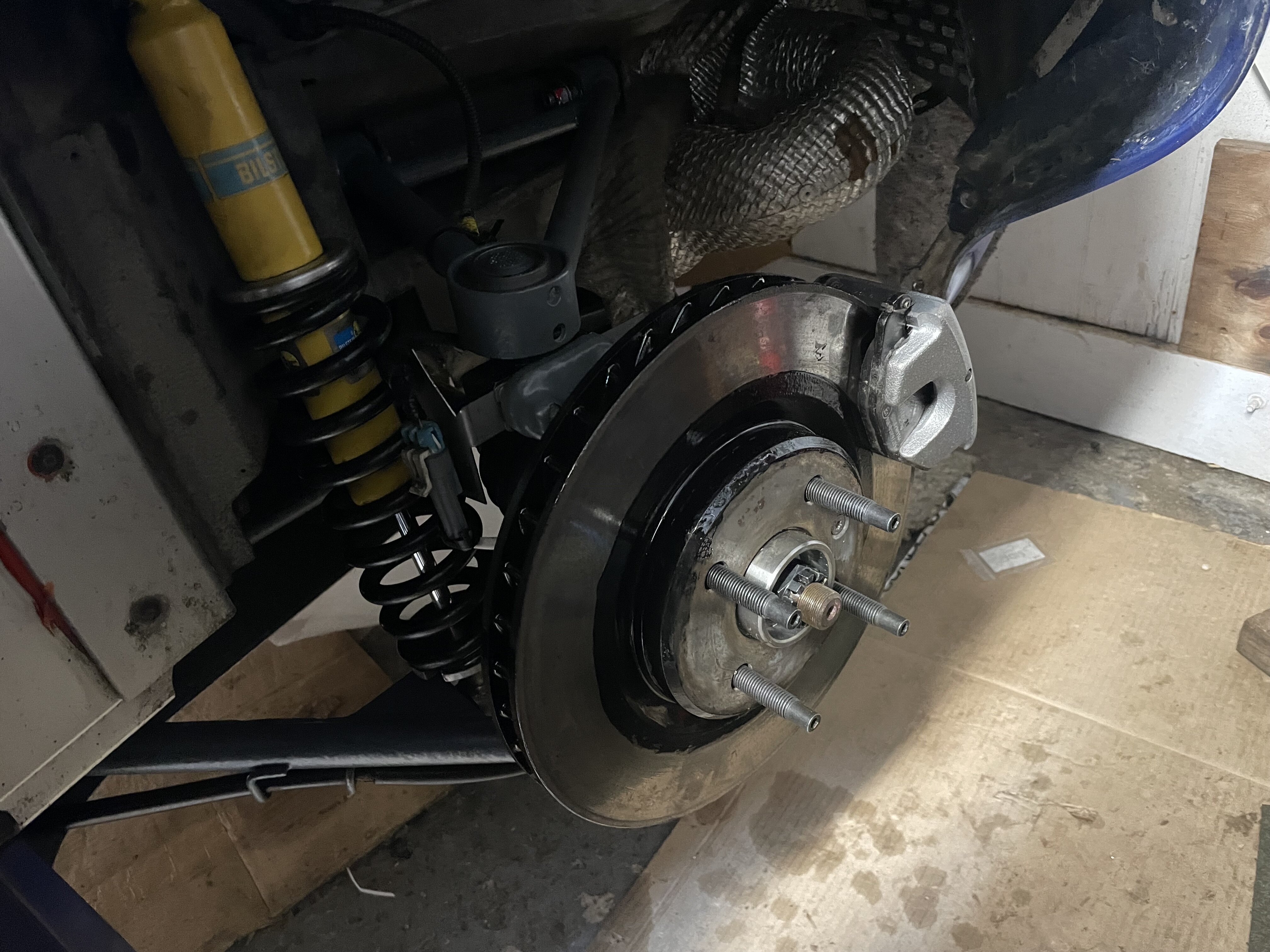

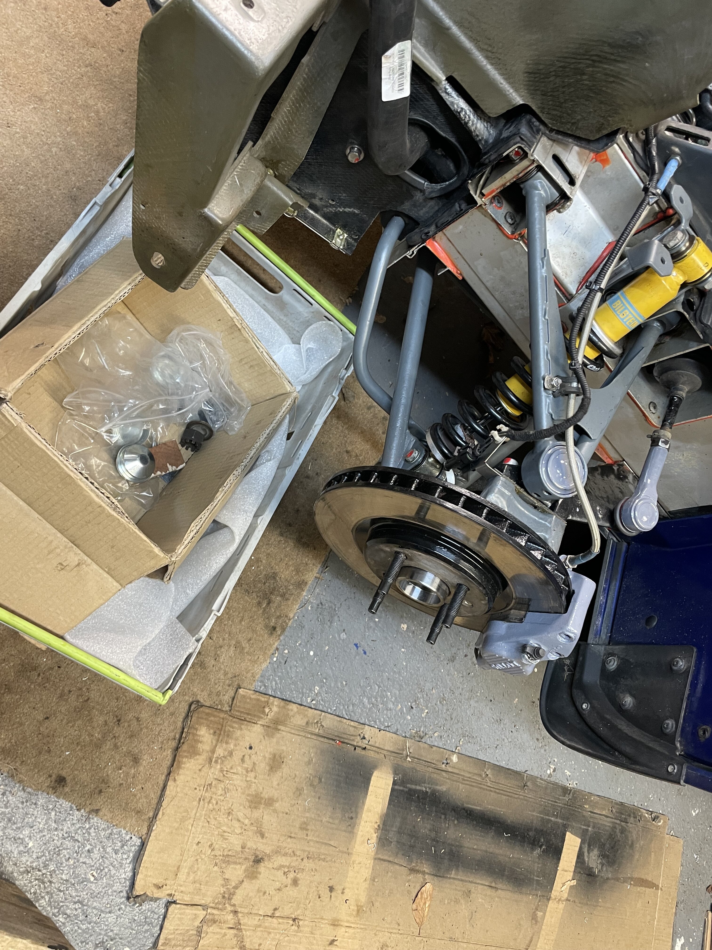

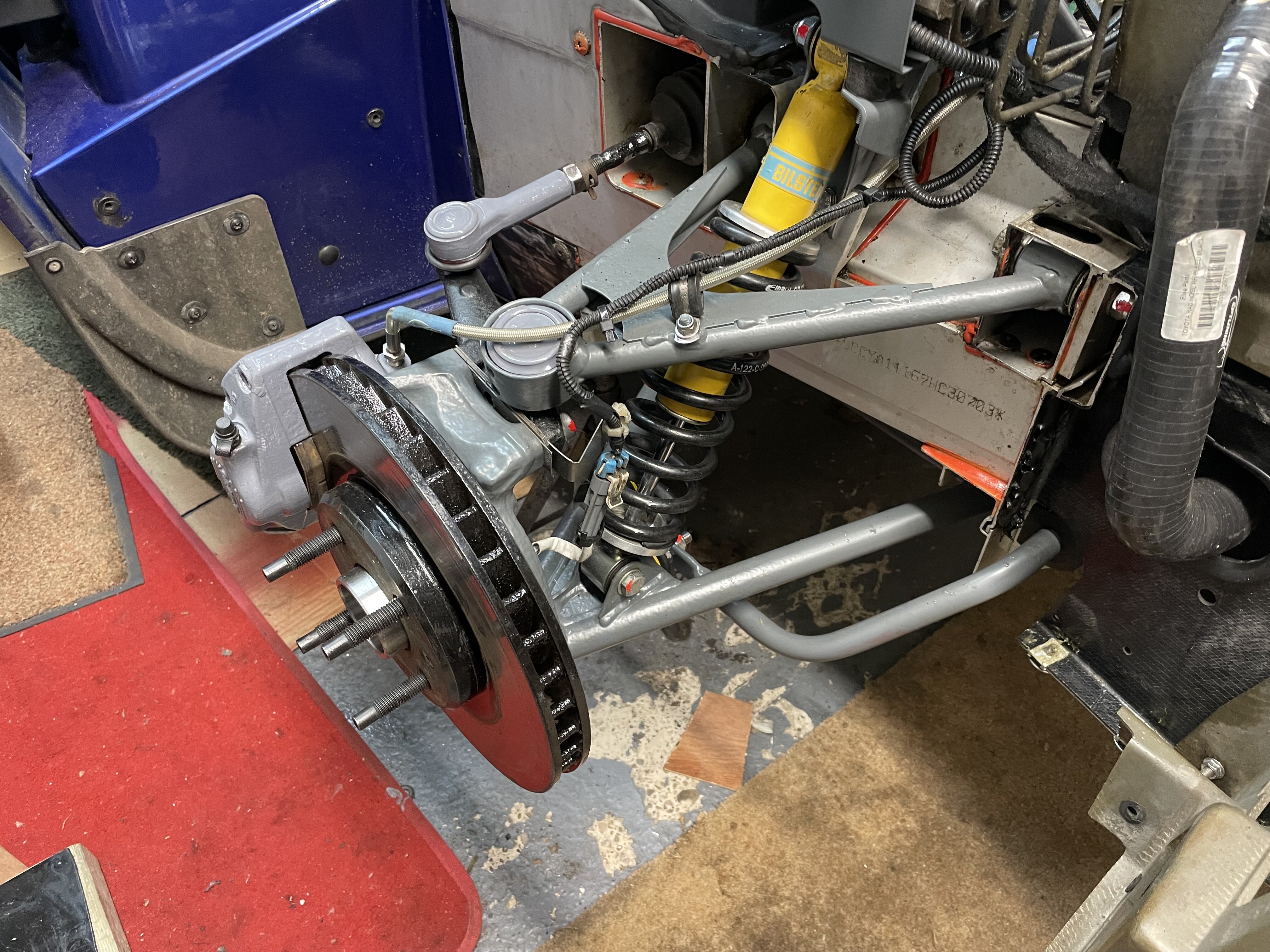

Today’s fun centred on filling the cooling system and then bleeding it. Nice easy ten minute job. 90 minutes later and finally both sides of the radiator warmed up and the heater did what it was supposed to do ( heat ) . And no leaks . But I am still not certain that I have  all the air out so will resume that fight another day . Front calipers now on and connected, but I forgot about the pad retaining pins so had to clean those . I should have bought new ones but the novelty of spending more on it has definitely worn off. Even though I do  keep looking at exhaust systems and nice dampers and Yokohama A0 52 tyres ………..

Locking the fronts can be an issue, but a lot of it is in how your apply the brakes.  The braking system on the Elises is heavily biased to the front, partly through the hydraulics and partly the big(-ish) front calipers vs the measly rear ones.  It works well if you apply the brakes progressively and transfer weight to the front, but stamping on the brakes can easily lock them which is quite hairy!  If you ever get chance to test the brakes on a rolling road (like the UK MOT) or even just to watch, it is comical how easily the front calipers lock with no weight transfer, and all-but-impossible to lock the rears without un-weighting the back end (maybe with a stronger right leg than mine?).

As for the brakes , the rears are 38mm piston ( I think ) and the fronts 44mm so yes, I see your point on the front bias . I have o.e m Calipers, ditto discs ( which ere bloody heavy ) and Mintex 1144 pads so an almost stock system. When I drove the car before pulling it apart I thought that the brakes felt pretty decent ( almost to my surprise ) . Some two piece lighter rotors from ‘ Seriously Lotus ‘ would be nice, but they will have to wait.

And on another note, brakes fitted and bled so now it’s time to replace the front clam .

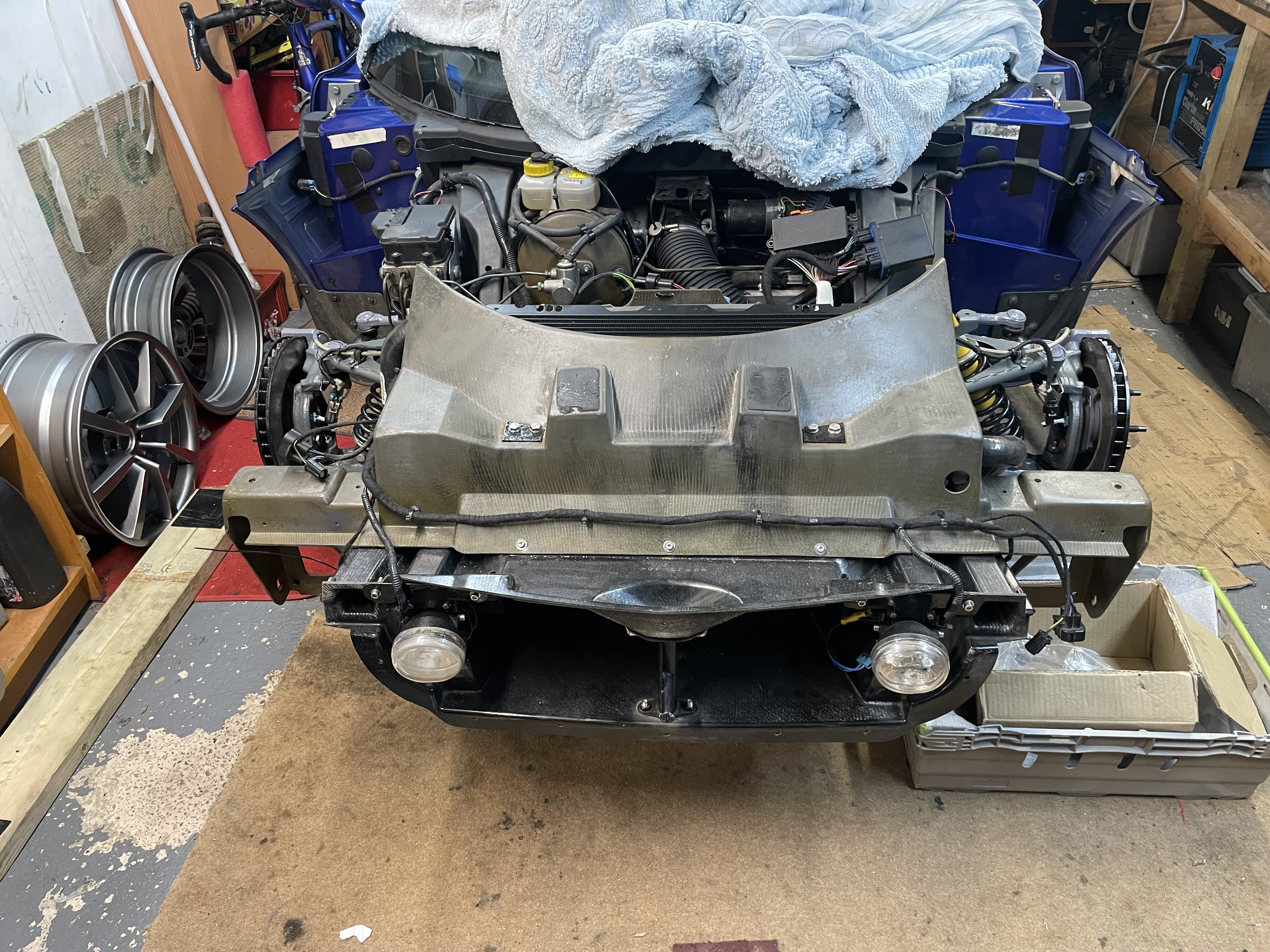

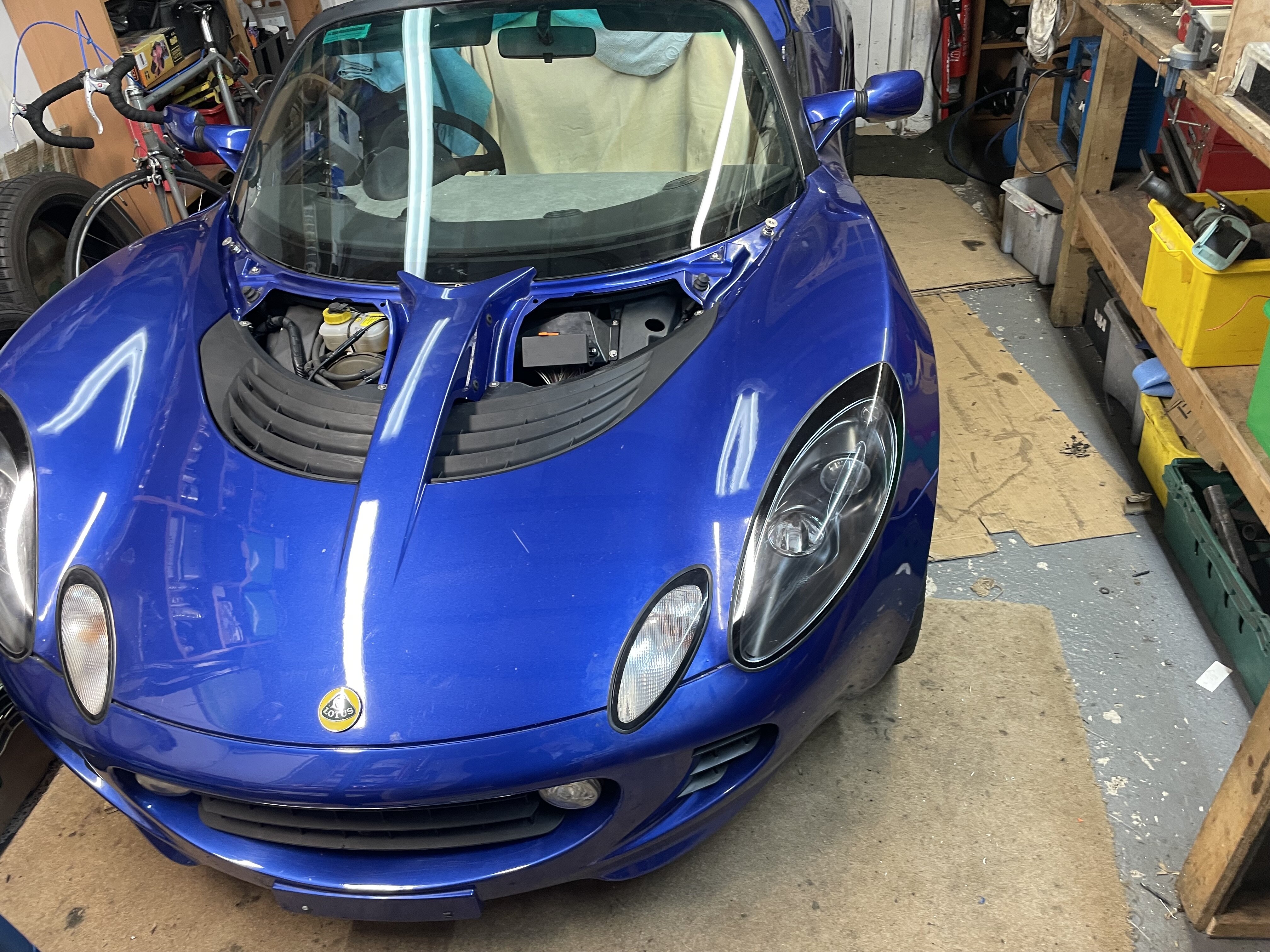

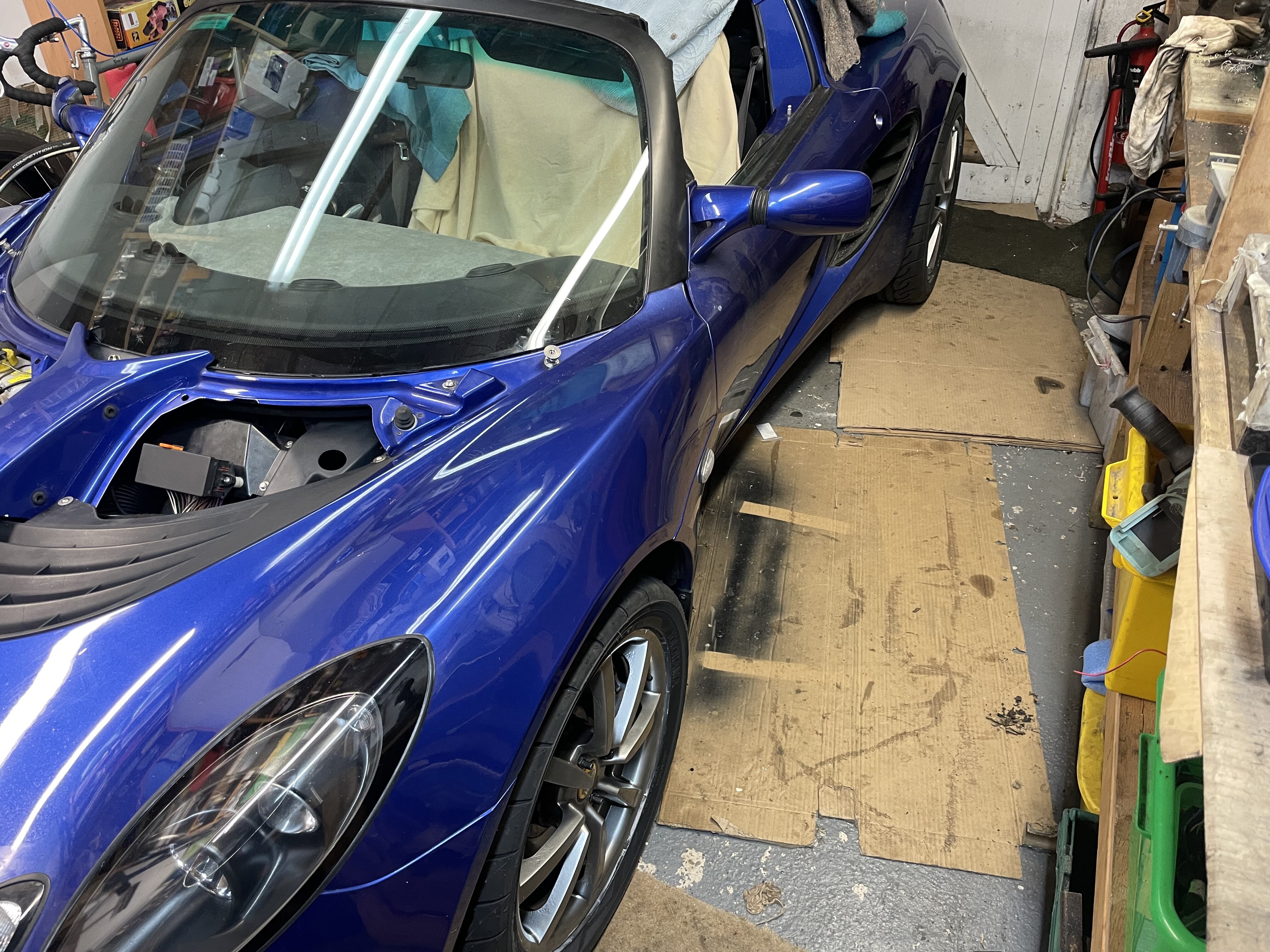

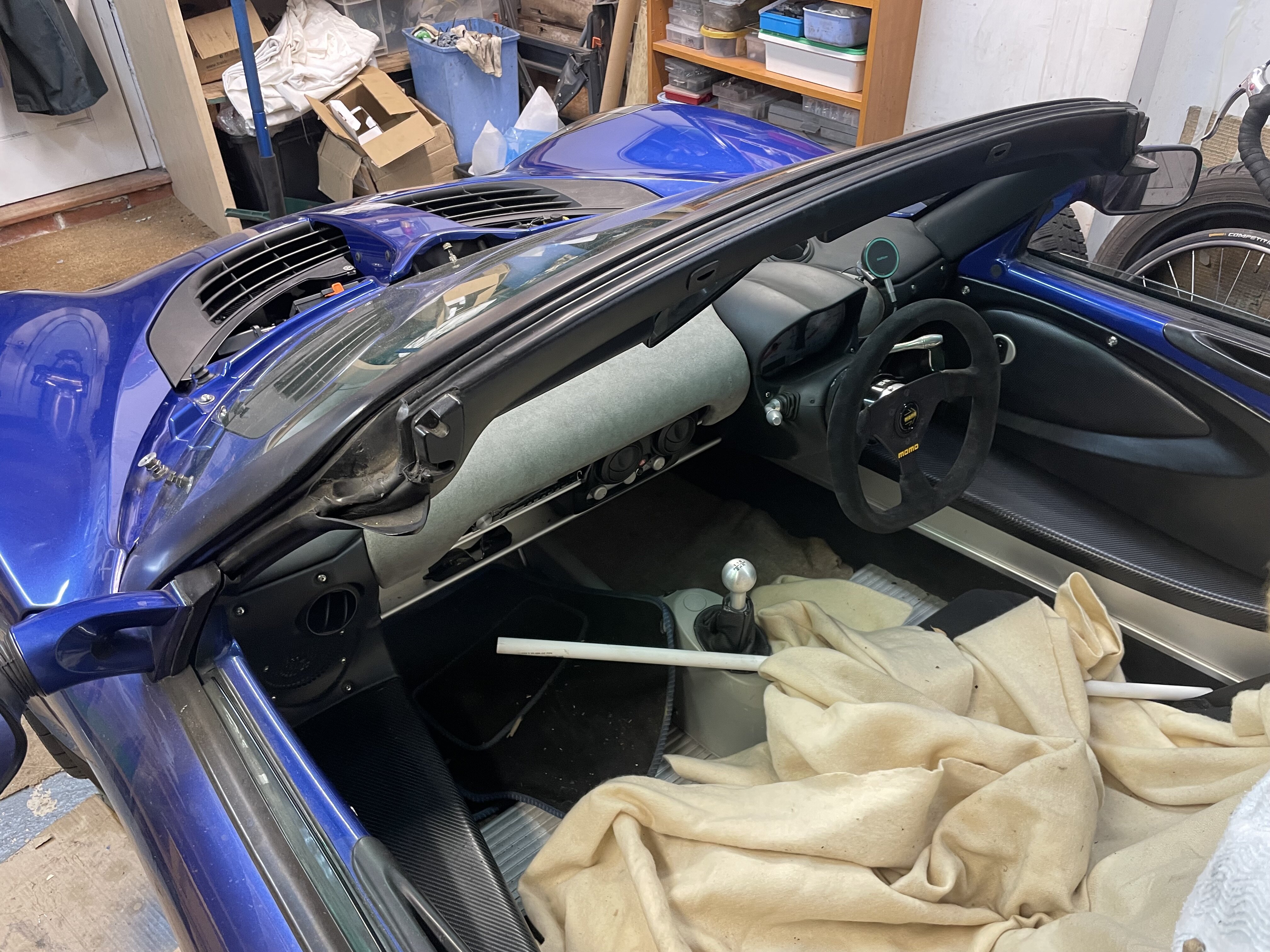

Today was clamshell fitting day. So the front of the car got its clothes back on. As always, jobs take much longer, much longer than planned. The clam itself dropped into place quite easily and I had all the new bolts ready and all the captive nuts thread - chased and, in one case, drilled out a sheared 6mm bolt and re-tapped the thread. The drama started when I began to tighten up the bolt at secures the ‘A’ post edge of the clam to the rear edge of the ‘A’ post cover . I dropped my spanner which immediately ran off and hid in the gap between the inner sill and the ‘A’ post cover. Bother, have to take the cover off the retrieve spanner.Yes, the bottom two bolts that screw into captive nuts both sheared, despite my best efforts with ‘Plus Gas ‘ and care . Drilling those out and re- tapping was more joy .

Back on its wheels test day afternoon. The bolts for the clamshell on the A post still need tightening but I need the car outside to do that with the doors wide open. Tracking to check before the diffuser goes back on and the hardtop needs its headlining  replacing. But otherwise, a trial drive up the road early next week if it is dry.
Posted
And it needs a windscreen wiper and the inspection access covers . Oh, and a good clean inside and out . So not quite there yet …………
Posted
