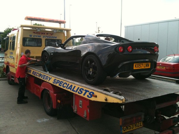

Now to get the throttle body back together tonight and convince the AA to assist in moving her . . . . . . .

She was collected by the AA this morning and fingers crossed, they will be starting to strip the throttle body etc down later today.
