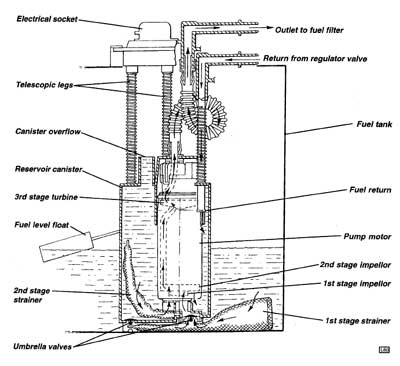

Posted
I'm planning to pull the petrol tank out and clean the 'first stage strainer' on the fuel pump. If (I think) that is blocked the fuel will only get to the pump via the canister overflow. That would also explain why after it's left for a while, the car runs. What happens then is that is the fuel seeps through the blocked 'first stage strainer', just enough to run the car for a bit. That's my theory anyway. I just need the time to ponce about getting the tank out.
I'll let y'all know how it goes.

I broke down again after a 150 mile motorway run, fully loaded with passenger and luggage but this time at 27 litres. Same simptoms, AA man came out 40 mins later and followed me to a petrol station, all ok until I got back to 27 litres again, broke down on my way to work, waited 25 mins and made it back home ok.
I'd had enough so I booked the day off and set about whiping the fuel tank out. I ordered a new fuel pump from elise parts (about £100).
Both of the 1st and 2nd stage strainers were clogged with crap and the canister was full (not actually full) of what seemed like Iron filings. I changed the pump anyway as it's a pain in the arse to get at and for all I know it might have been the pump regardless of the crap. I drained the tank and it had more crap sliding around the bottom.
Took me about a day to do. The biggest pain was getting the filler hose off and then on again.
All is now well. :)
