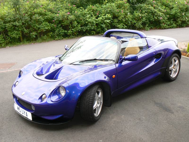

mambosasa Posted May 31, 2008 Author Posted May 31, 2008 I finally managed to take a better picture of the car with the splitter.
Pesky Posted June 1, 2008 Posted June 1, 2008 Sorry to be pedantic, but isn't that a "Lotuspower" splitter (rather than "Elisepower")? Looks good
mambosasa Posted June 1, 2008 Author Posted June 1, 2008 Sorry to be pedantic, but isn't that a "Lotuspower" splitter (rather than "Elisepower")? Looks good Some people, eh..
