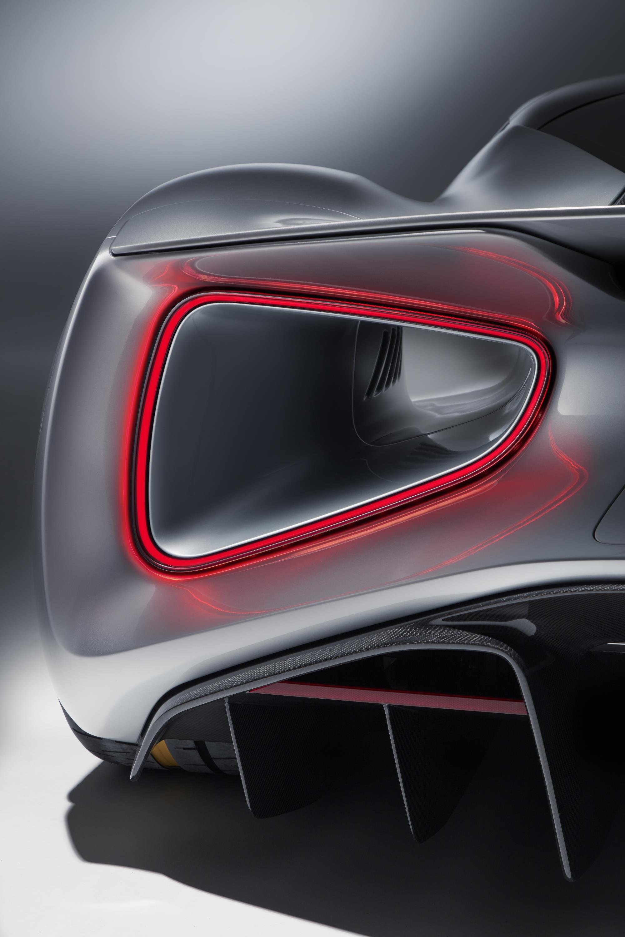

-      Can you explain the car’s porosity in aerodynamic terms? Most cars have to punch a hole in the air, to get through using brute force, but the Evija is unique because of its porosity. The car literally ‘breathes’ the air. The front acts like a mouth; it ingests the air, sucks every kilogram of value from it – in this case, the downforce – then exhales it through that dramatic rear end.

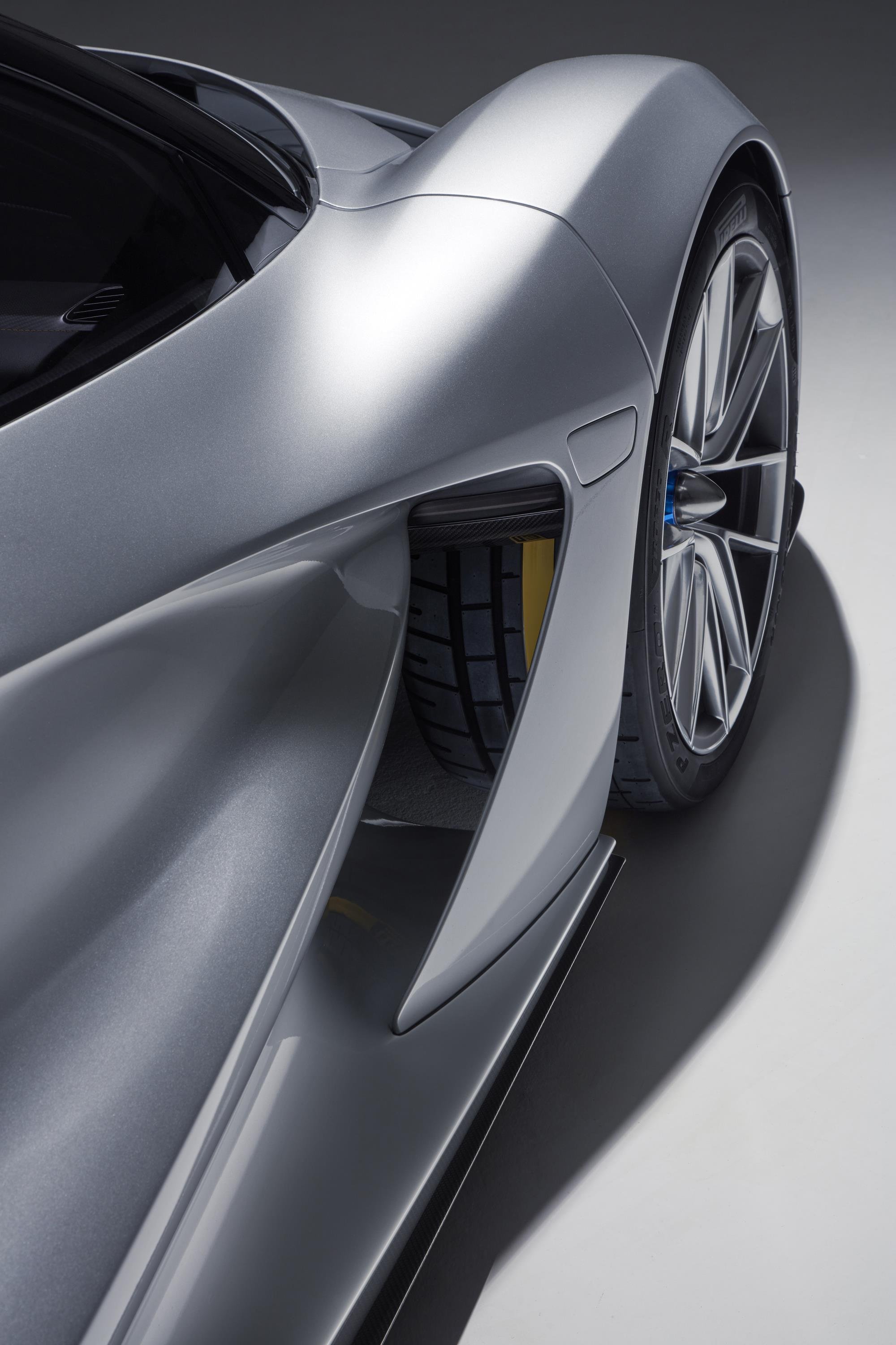

-      What role does that deep front splitter play? It’s designed in three sections; the larger central area provides air to cool the battery pack – which is mid-mounted behind the two seats – while the air channeled through the two smaller outer sections cools the front e-axle. The splitter minimises the amount of air allowed under the vehicle, thus reducing drag and lift on the underbody. It also provides something for the difference in pressure between the upper and lower splitter surfaces to push down on, so generating downforce.’
-      Are the Venturi tunnels through the rear quarters part of the porosity? Yes, they feed the wake rearward to help cut drag. Think of it this way; without them the Evija would be like a parachute but with them it’s a butterfly net, and they make the car unique in the hypercar world.
