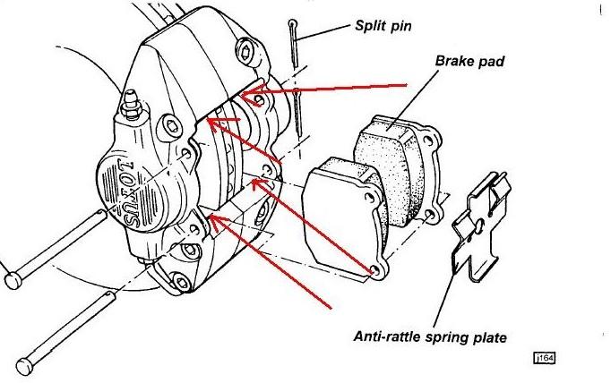

Fitting Brake Buffer Pads
This is where the anti rattle buffers go on the front pads mate. If the rear pads are rattling i'd check the retaining pins, the rears are different from the fronts and never heard of the buffers being needed on the rear pads before.
