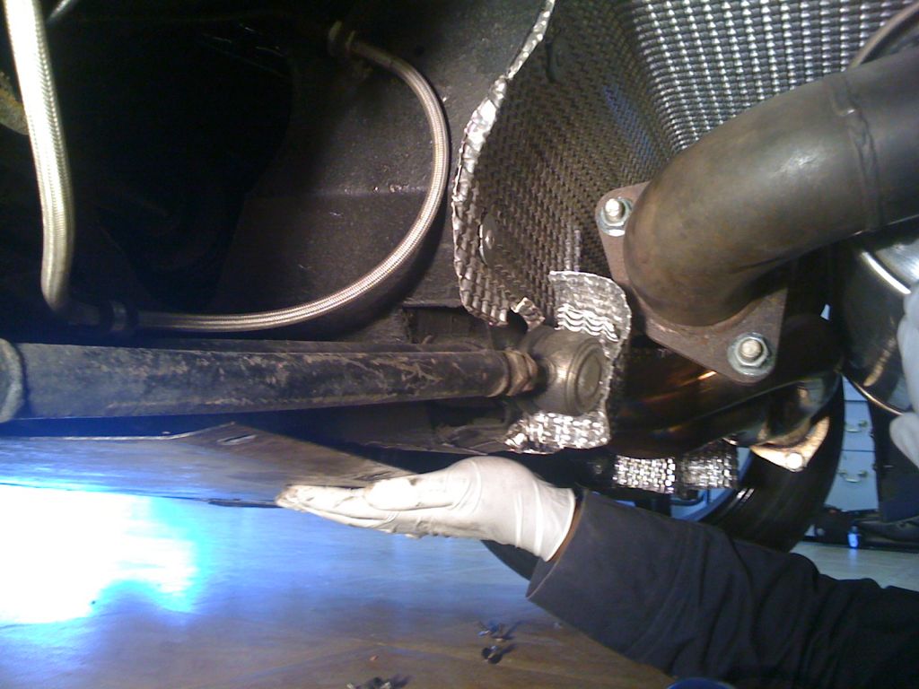

Preparation

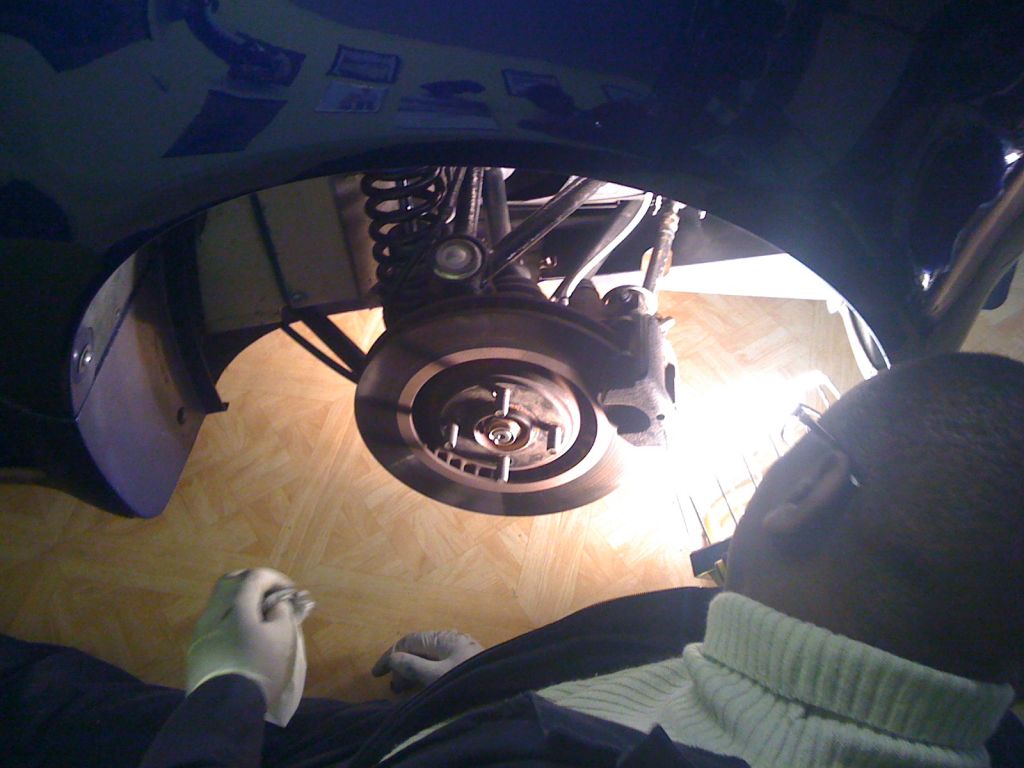

1. I removed the rear near-side wheel and left the car up on jacks.
2. I removed the diffuser and loosen up the centre undertray. This provided adequate access to the bolts required to drain the oil.

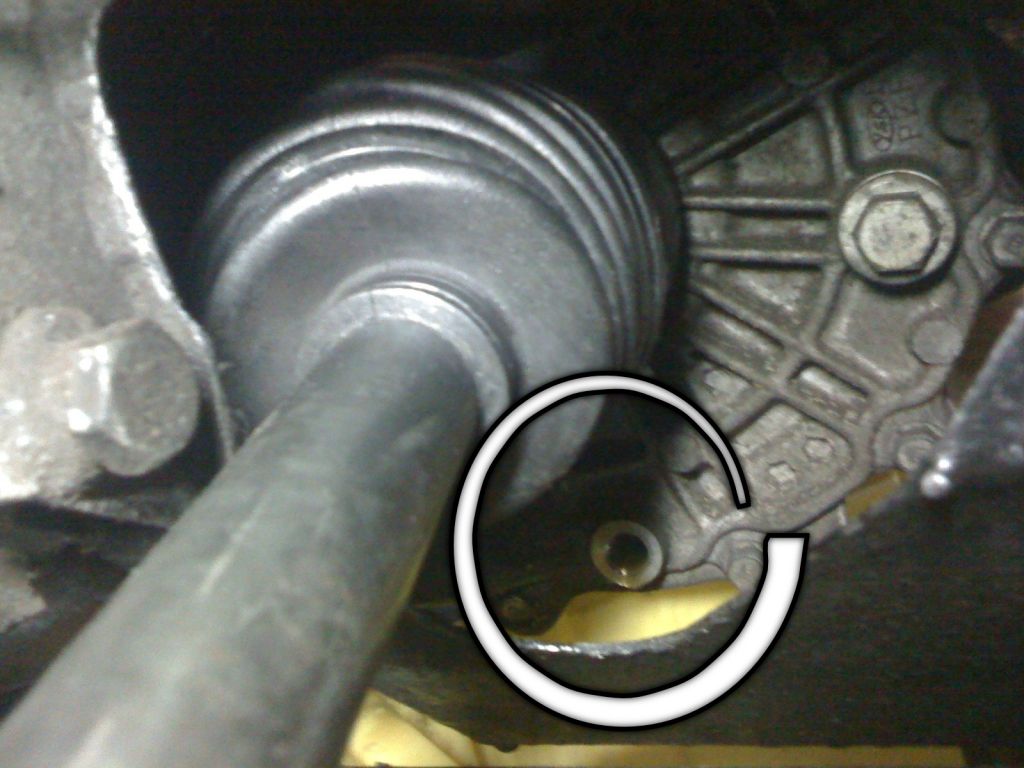

Draining
1. I removed the lower bolt as shown on the photo. Note that you will have to use a ratchet handle to remove this bolt.
When you do this, don't forget to place a catch tray under the car :(
2. In ensuring that gearbox is fully drained, I had to lower the car on the jacks to level. I left the car to drain for about ten minutes.
3. Once completely drained, I replaced the bolt.

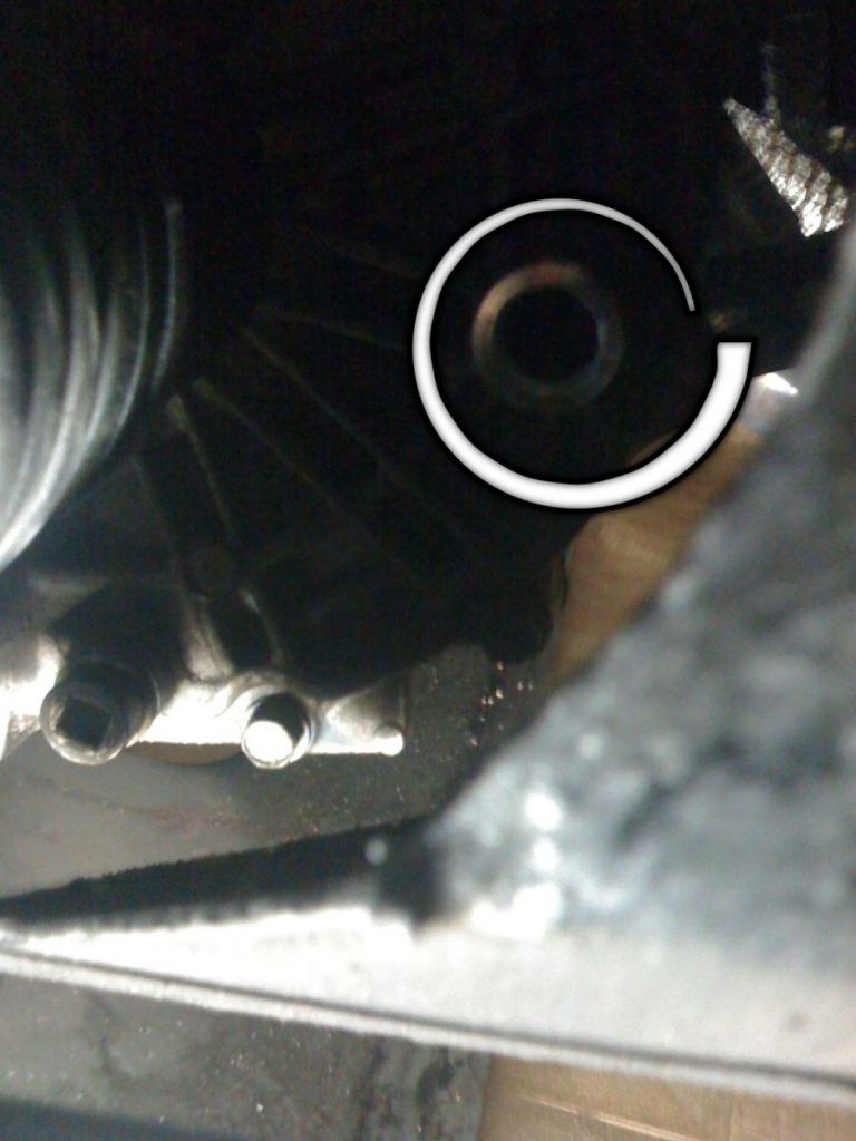

1. I then removed the top bolt. Doing this will do two things. Firstly, the outlet will act as a 'level' when re-filling the gearbox. Once oil comes out of this hole during re-filling process, then you have reached the correct amount. Note that the car must be level to ensure that you have required amount of oil in the gearbox. Secondly, it will act as a breather hole to allow oil to flow.

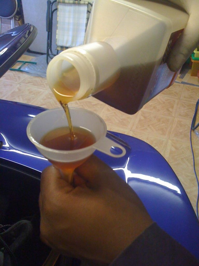

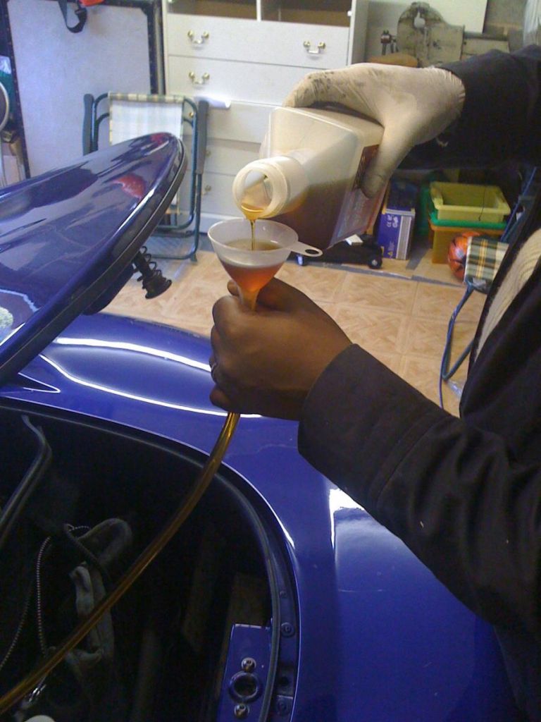

2. Now I now that some folks use this hole to refill the gearbox, however I decided to use the inlet hole at the top of the casing (by the gear linkage). I used a pipe and a funnel that worked a treat.
3. Just over 2L later, the oil dripped out of the top hole. I replaced the bolt, the undertray and the wheel and removed the jack.

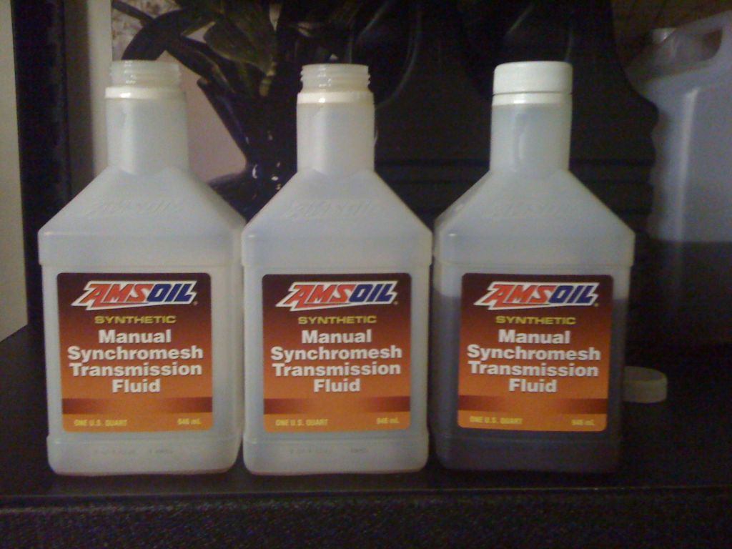

4. I went for the Amsoil transmission synthetic oil. As you can see, two bottles and a bit was good enough to fill the gearbox.

kumatai69
Posted
Hi,
excellent photo`s to follow BUT
can you show me a photo of where you filled the oil from when the job can be started
cheers mark
ps when are you going for the cooler :)
mambosasa
Posted
Hi,
cheers mark
Hey Mark,
I used the breather pipe on top of the gearbox, by the gear linkage. It's usually covered by a little funny shaped rubber cap. As long as you undo the top bolt, then the oil should flow quite easily.
The other option is to use the same bolt to fill up with by using a hose and a funnel.
Ta.
Bis.
wemorgan
Posted
What size key is needed to remove the drain/fill plugs? Thanks
mambosasa
Posted
Hi Wemorgan,
Its not a key - you can use your ratchet bar direct. Just plug it direct into the hole.
