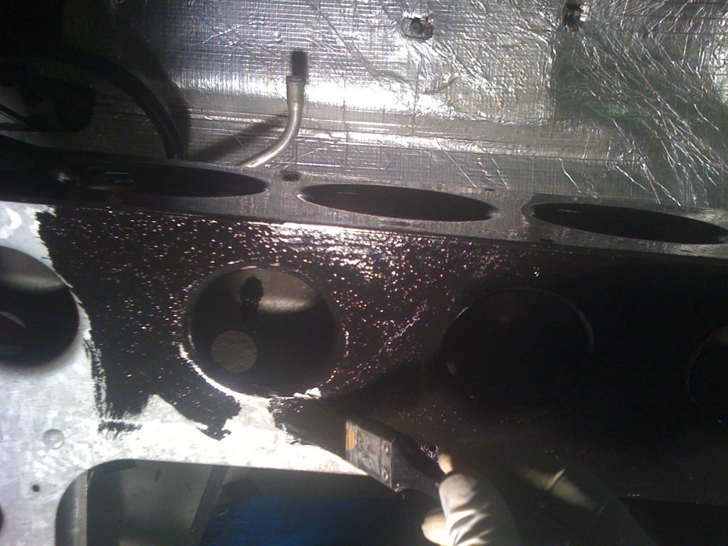

So I purchased a tin of POR15, in black and armed with a brush I attacked it with all my might!
Prior to any painting, I spent some time cleaning the sub-frame with brake disc cleaner and removed all debris and oil from the surface. I then gave the whole thing a good going over with a wire brush.
It wasn't perfect, but it was clean and free from the oil.

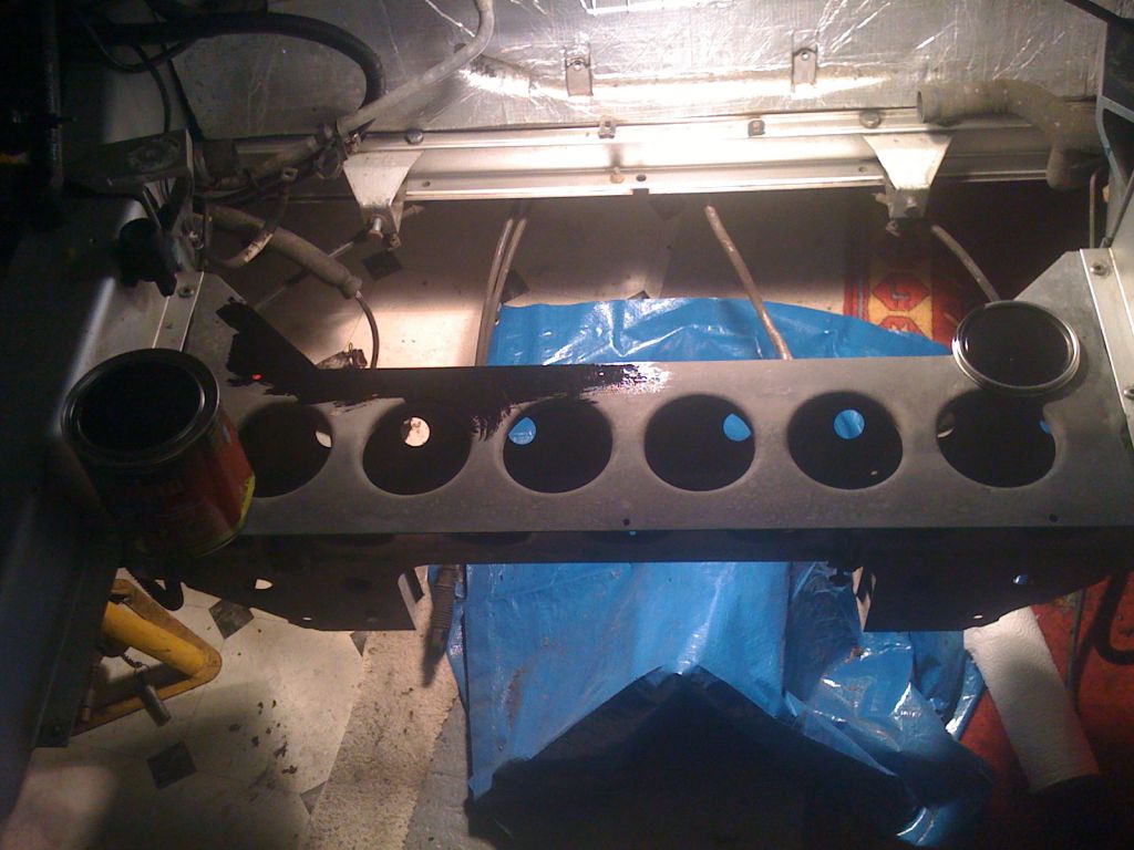

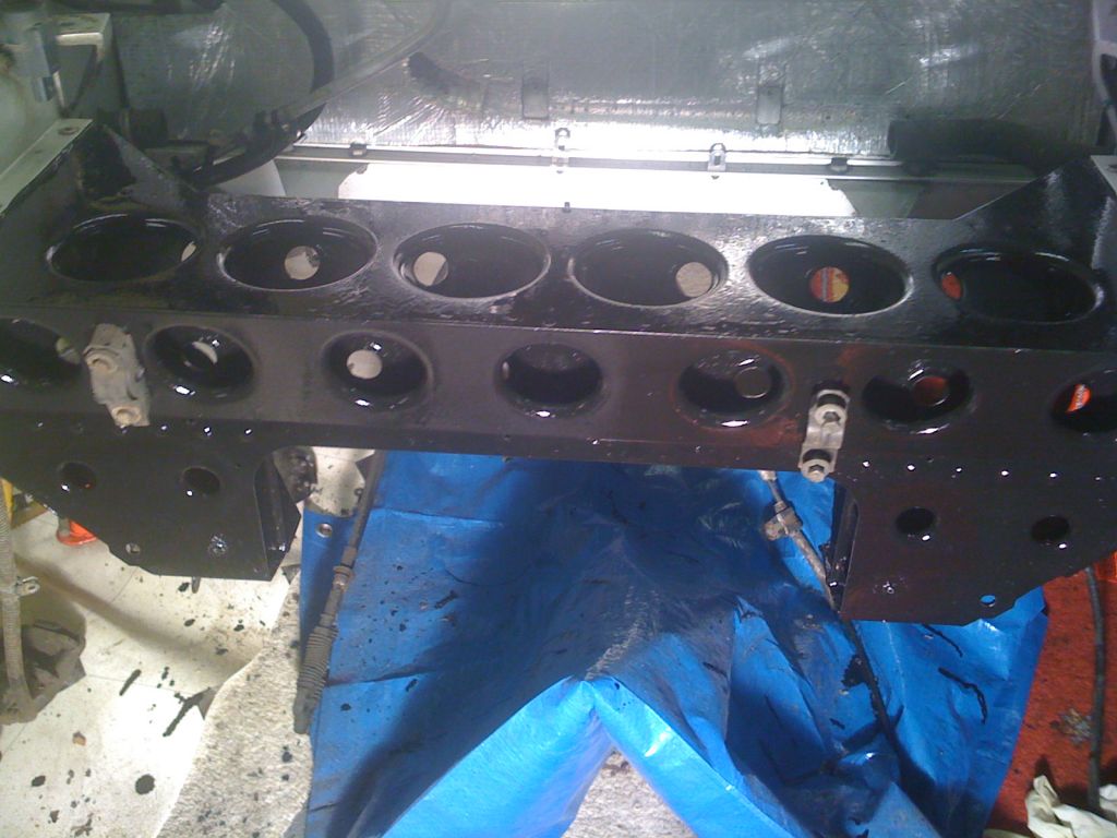

The start...

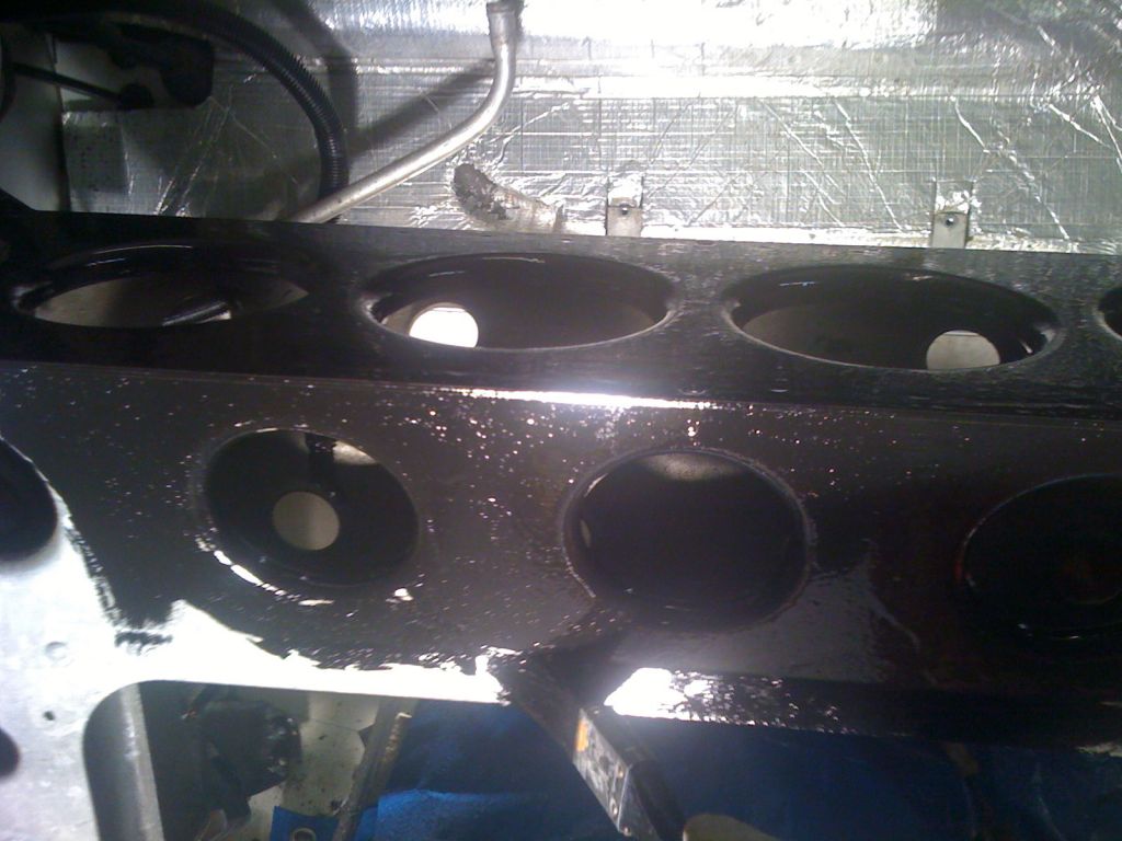

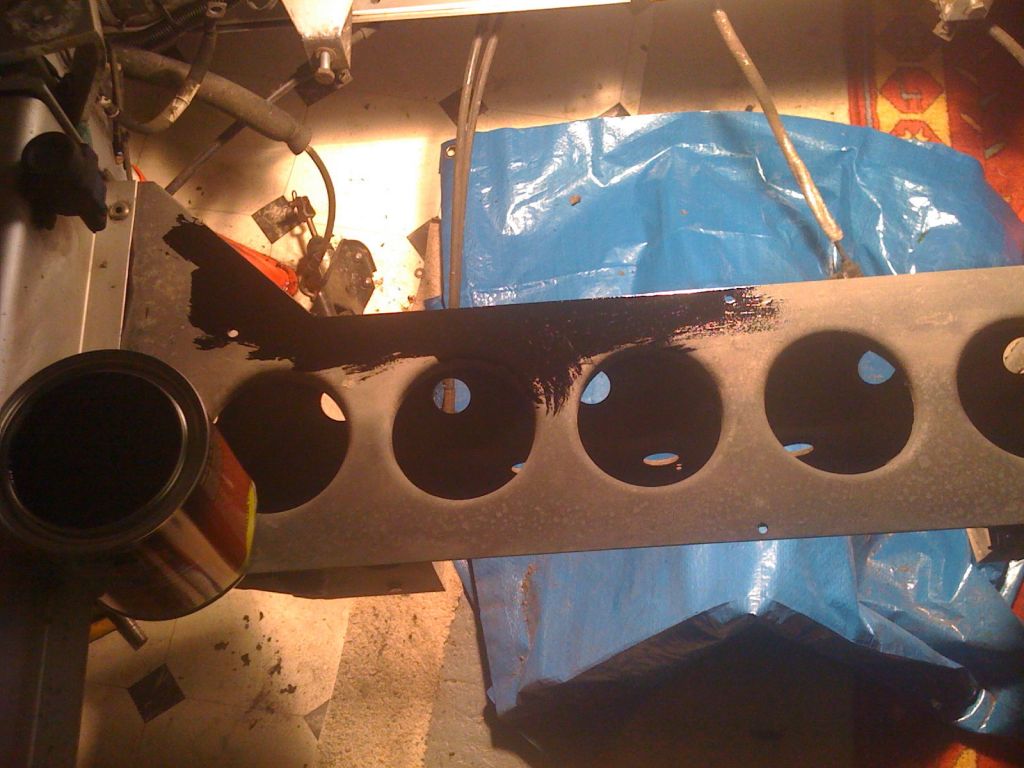

Took my time trying not to drip too much and getting into every corner...
Going on nicely...

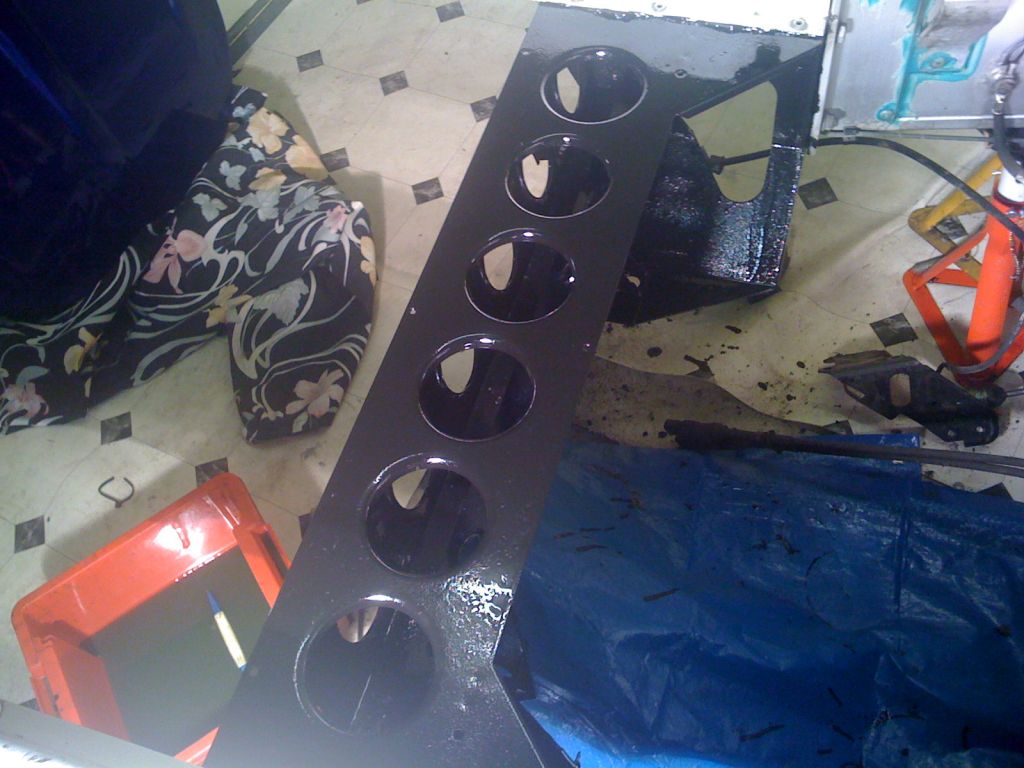

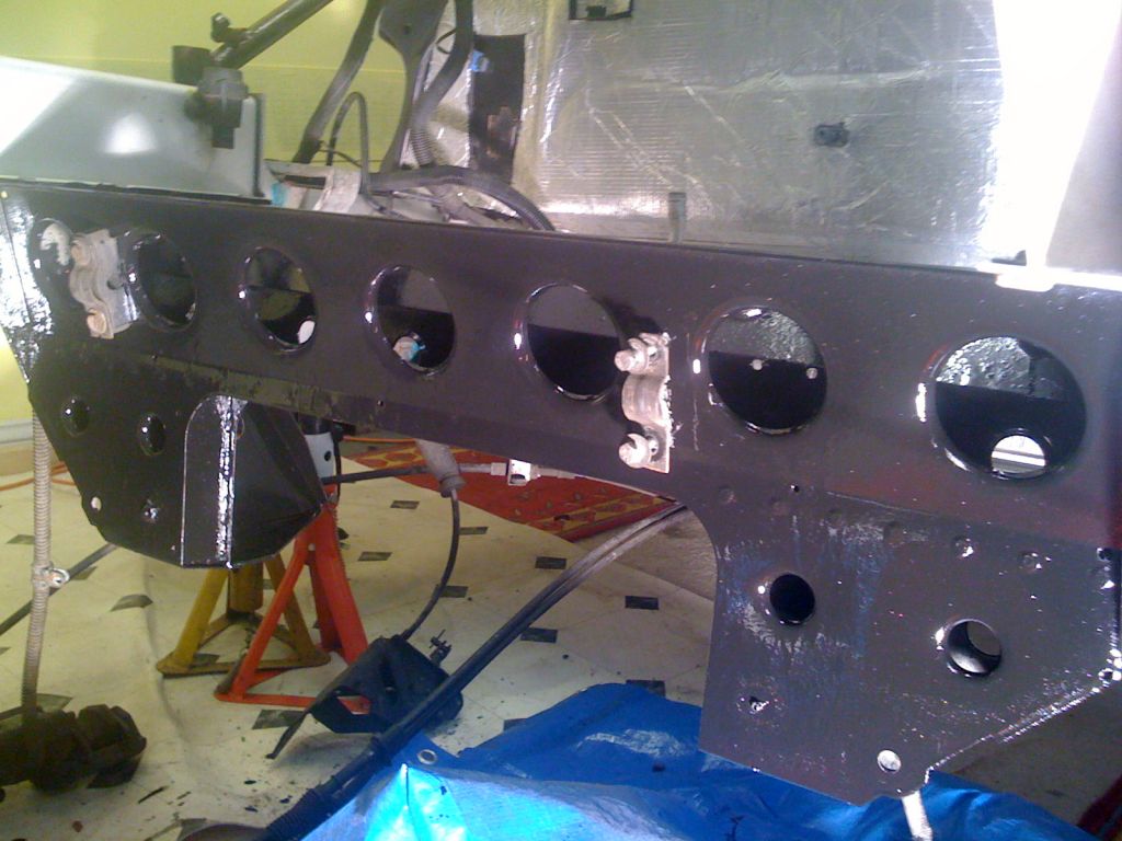

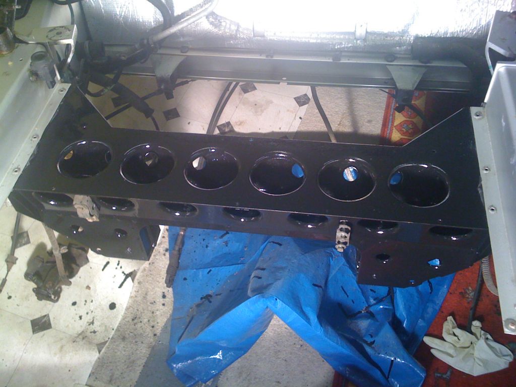

After 30 minutes or so of painting, the first coat is complete and looking as I hoped. It is suggested that you paint two coats, however if it dries okay, I may just touch it up and leave it as that.
I am quite pleased with this.
Job done! :D
