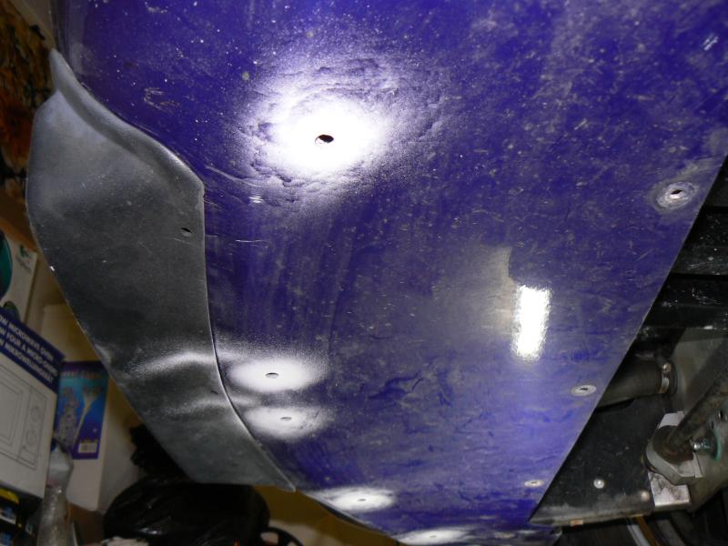

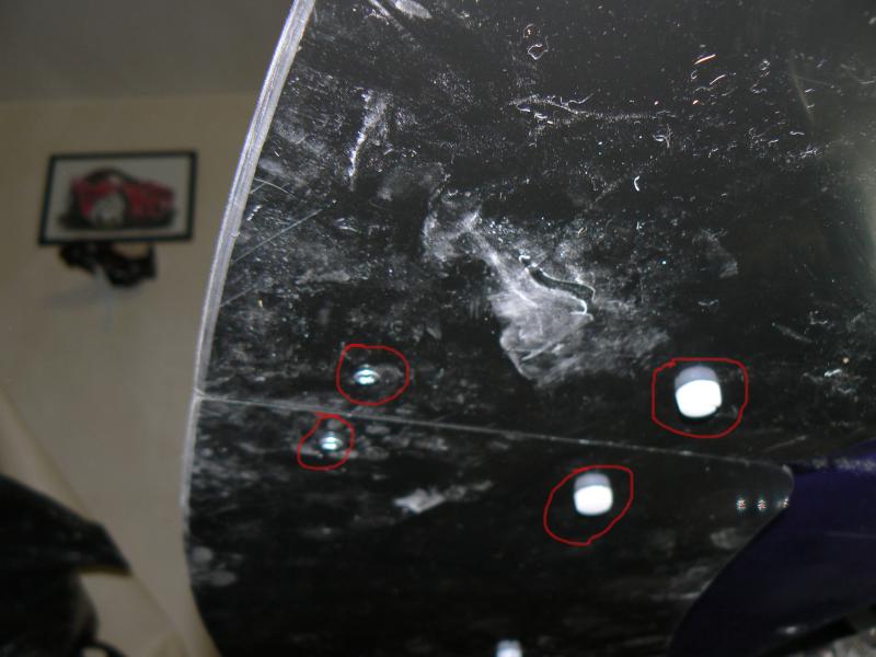

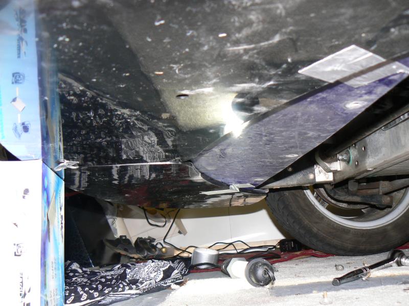

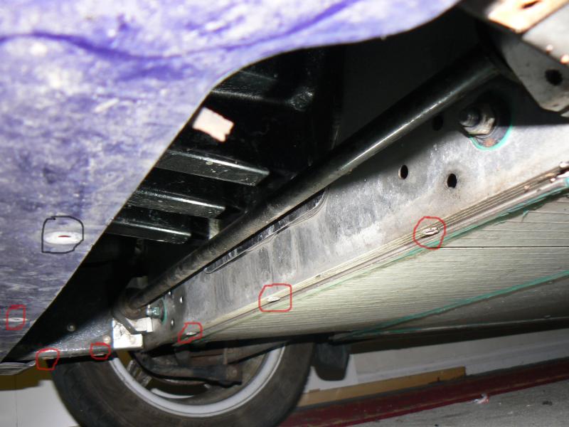

3. Then, I removed the plate under the front of the car. About 11 bolts to remove. I had an issue with one of the clips inside the clam moved and dropped in. It was an absolute bugger to get it out, tighten it then find a way of replacing it. post-590-1211888917.jpg4. I then placed the splitter under the car, whilst ensuring that it is correctly alligned and secured it in place with a support (Box) and tape. post-590-1211889165.jpg5. Marked all the holes with a marker 6. Drilled. I used the smallest drill bit I had first, then enlarged the hole with a dremmel.post-590-1211889220.jpg6. Bolted the splitter into place. The recommendations are that the receiving nuts are bonded onto the clam. I chose not to do this as if the plastic bolts break, I would have to access the underside anyway.Note that I screwed two screws into the underside of the number plate plinth. This is to stop the spliter from deflecting too much downwards at high speeds. This will do for not until I come up with a better solution. Metal cable perhaps?post-590-1211889413.jpg7. I put everything back as original ( full of fun and games due to rust), then dropped the car back down. Replace the number plate, then tried to get out of the garage.I just managed to without hitting the floor as there is a step into my garage.

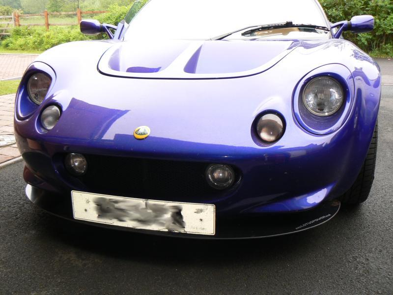

7. I put everything back as original ( full of fun and games due to rust), then dropped the car back down. Replace the number plate, then tried to get out of the garage.I just managed to without hitting the floor as there is a step into my garage.post-590-1211889871.jpg
