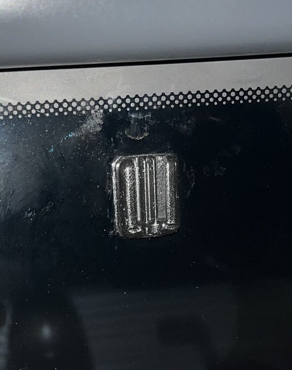

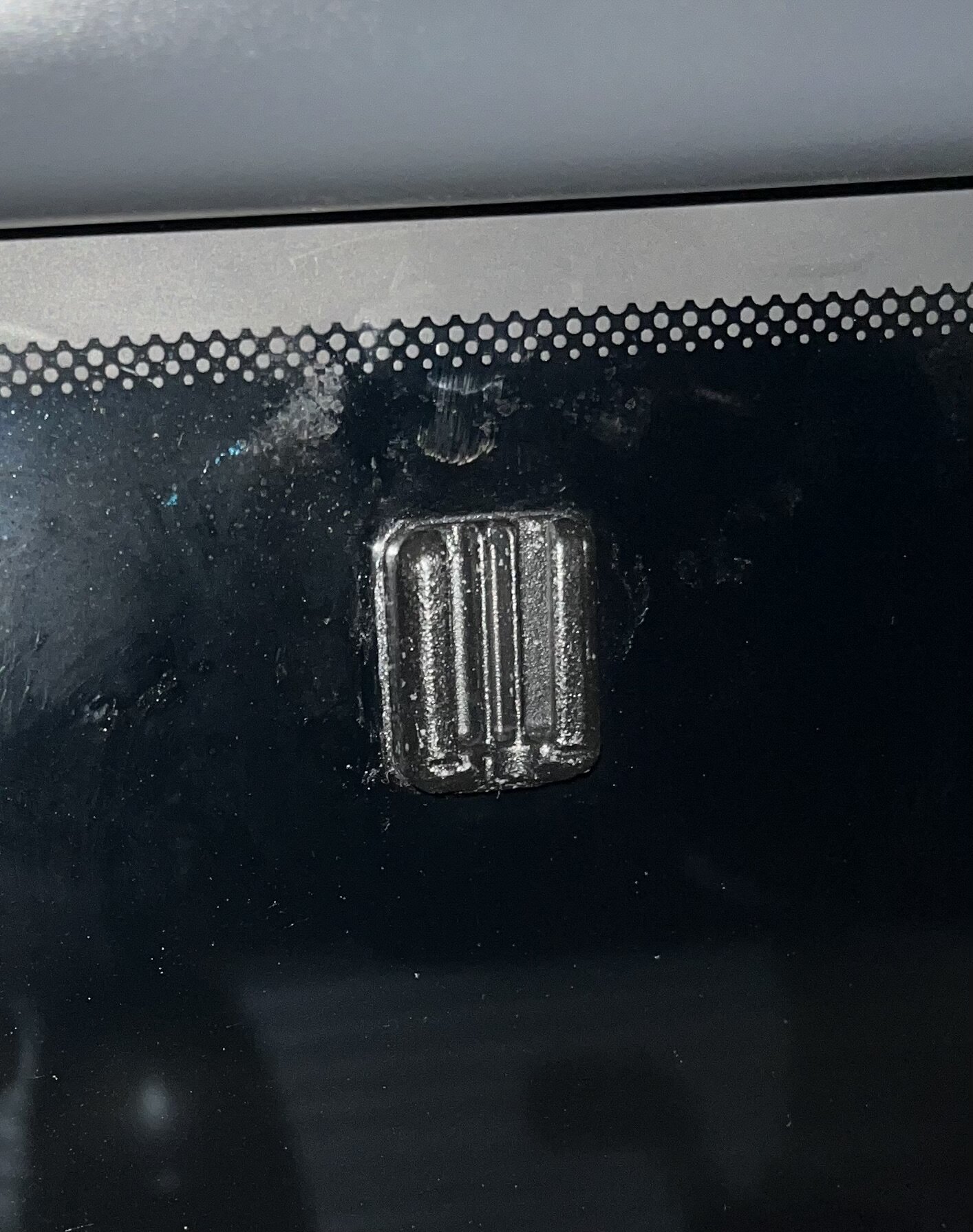

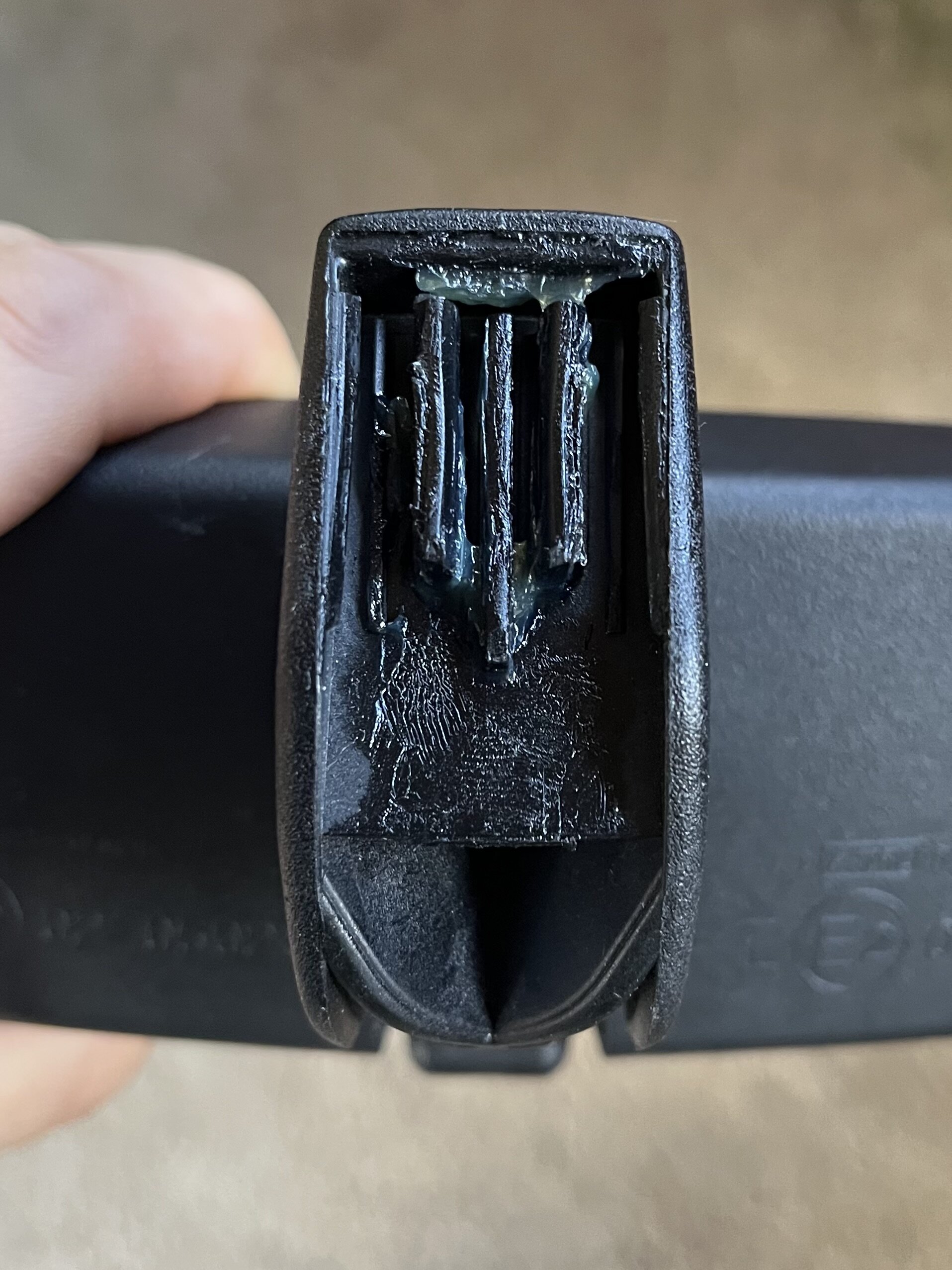

I taken some pictures of the windscreen mount and the back of the mirror for you. I still can’t work out how it fits together!  I’ve tried everything to reattach the mirror to the windscreen with no success.
I’m not 100% sure something hasn’t broken off as I’d have thought there would have been some kind of clip to hold everything in place.
Lotus fitted a new mirror when I bought the car. The back of the mirror is heavily greased so it may simply be a tight fit.
You definitely need to slide the mirror up to remove it
I hope this helps.

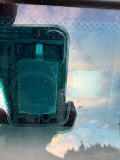

Thanks for that input Guido that's great info. When i look at my mount from the outside of the screen i can see a small metal bit that looks like a clip. As I slide the mirror down I can see the clip close slightly almost like i need to push on it to release the rest of the mirror. Picture below is from the outside looking in. you can see the metal clip. I cant see how i would push on the clip as there is almost zero gap between the screen and the back of the mount.mirror.jpg.fee0134c80a91721ffcdbe218c9090e7.jpg

Perfect Jonathan this is exactly what I needed. So I do need to press the metal 'finger' to release the shoe. I'll have another look tomorrow. Thank you so much.
