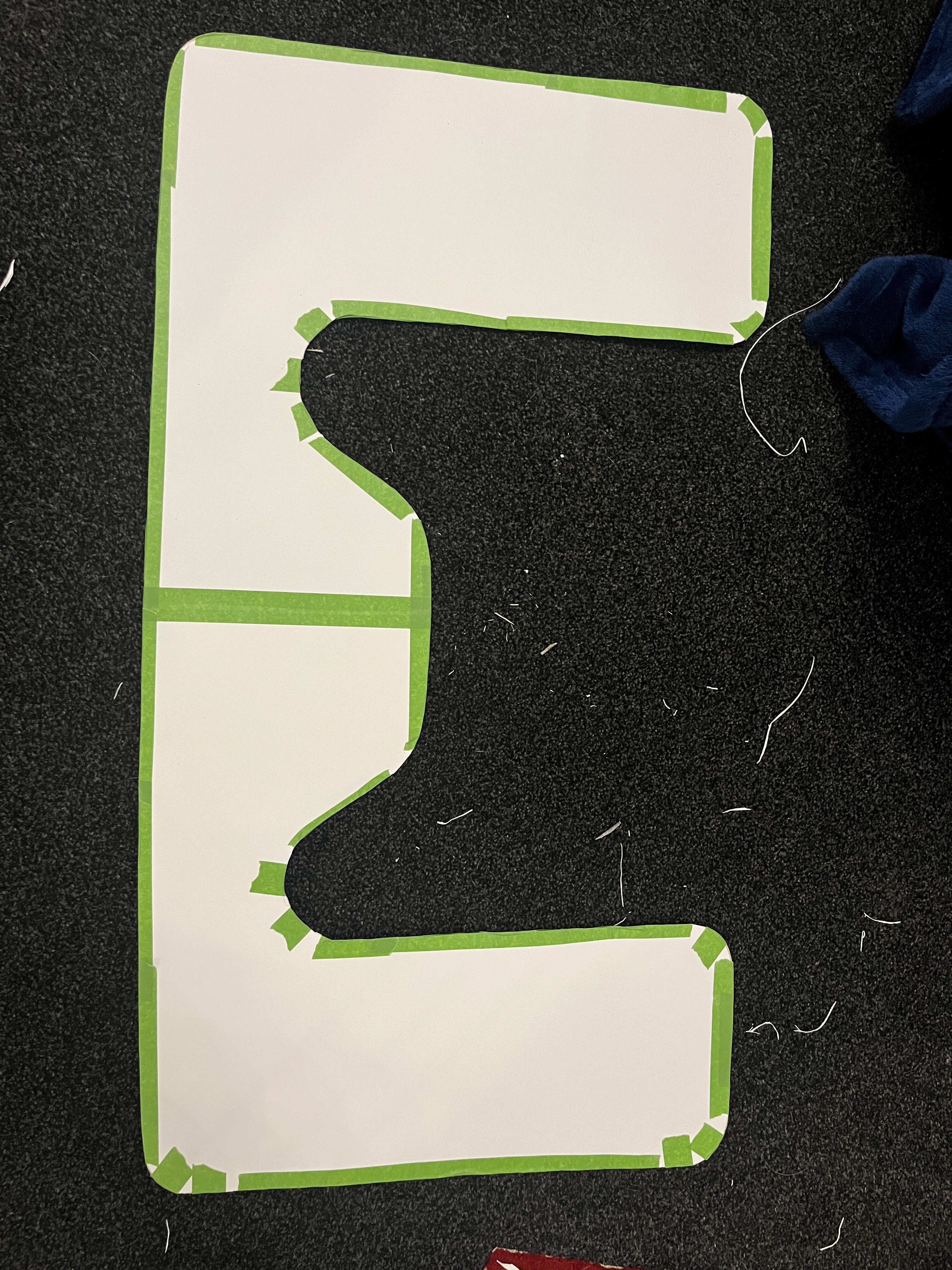

Lee,  head lining fell out of my s1 Exige!  I have some fabric and glue left over and  live close to you if you want to fix yourself. Should be much easier on your Exige as you can remove the roof.
I made a template, cut thin card to shape, covered the card with the fabric, glued it in place.  S1,headlining is flat(ish).

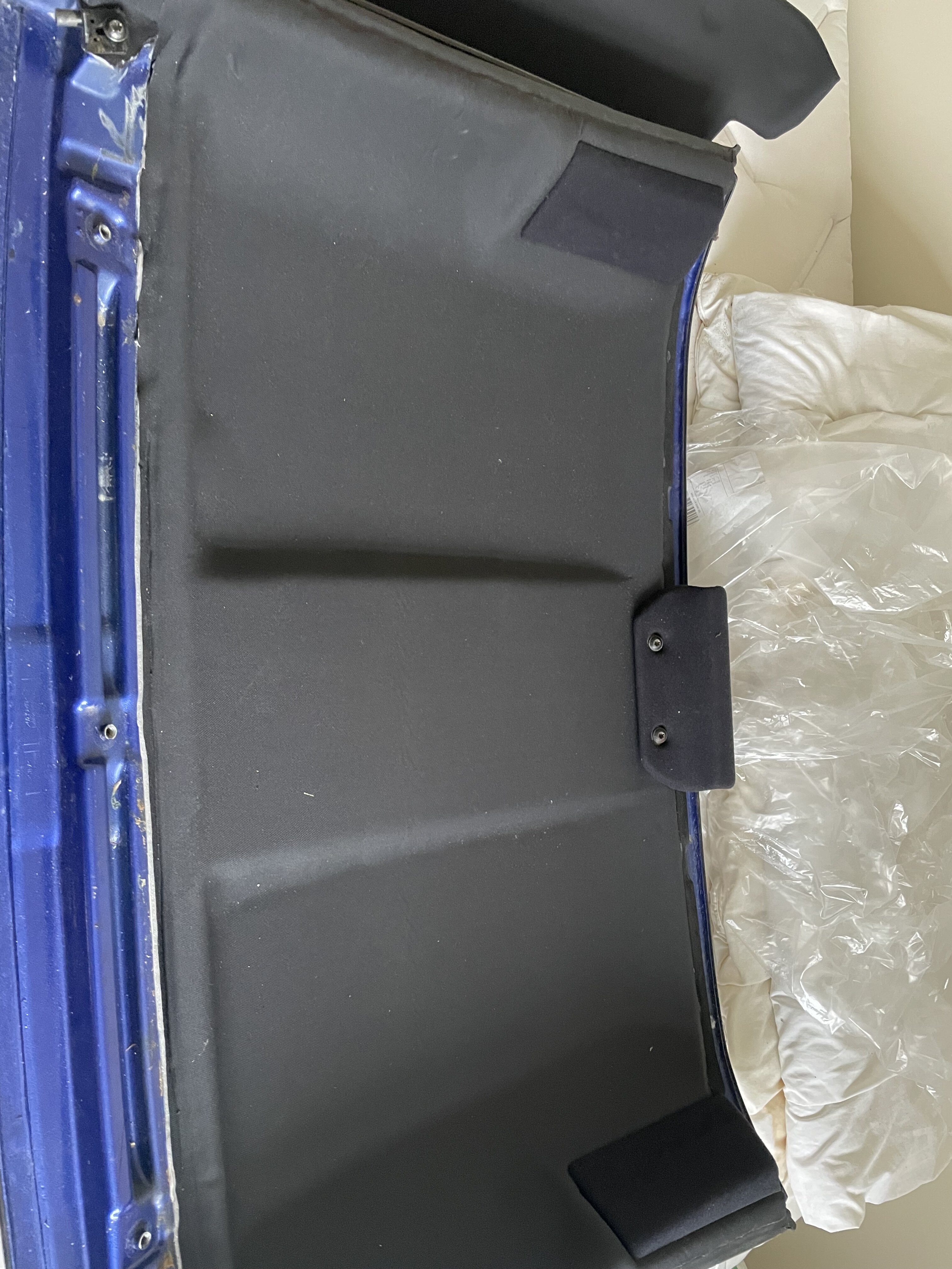

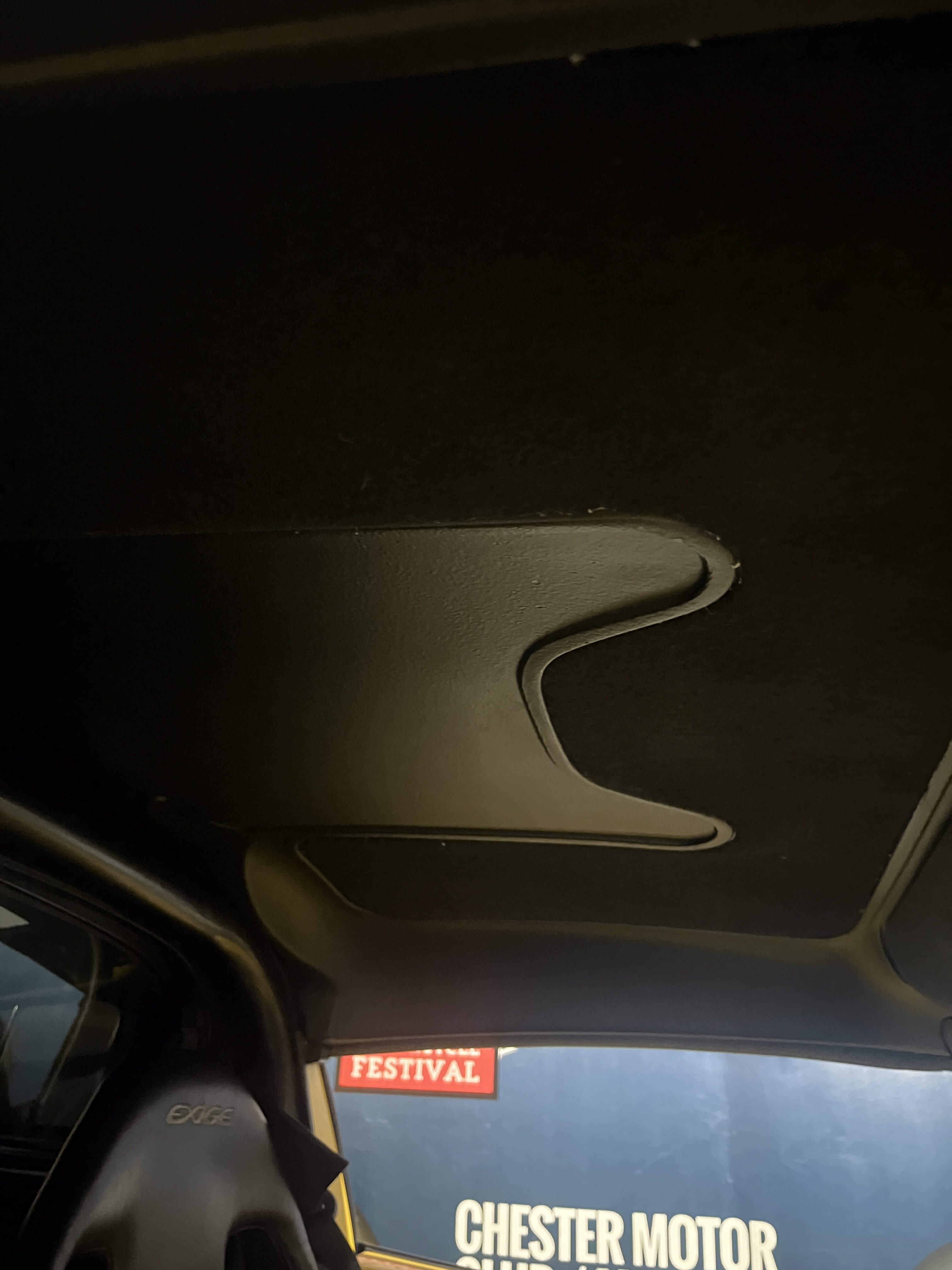

Not sure the S2 is easier looking at that, working upside down in the car is hard but the shape was not too bad and it’s flat.
Finished and card liner/template.

That looks really good, nice job.
