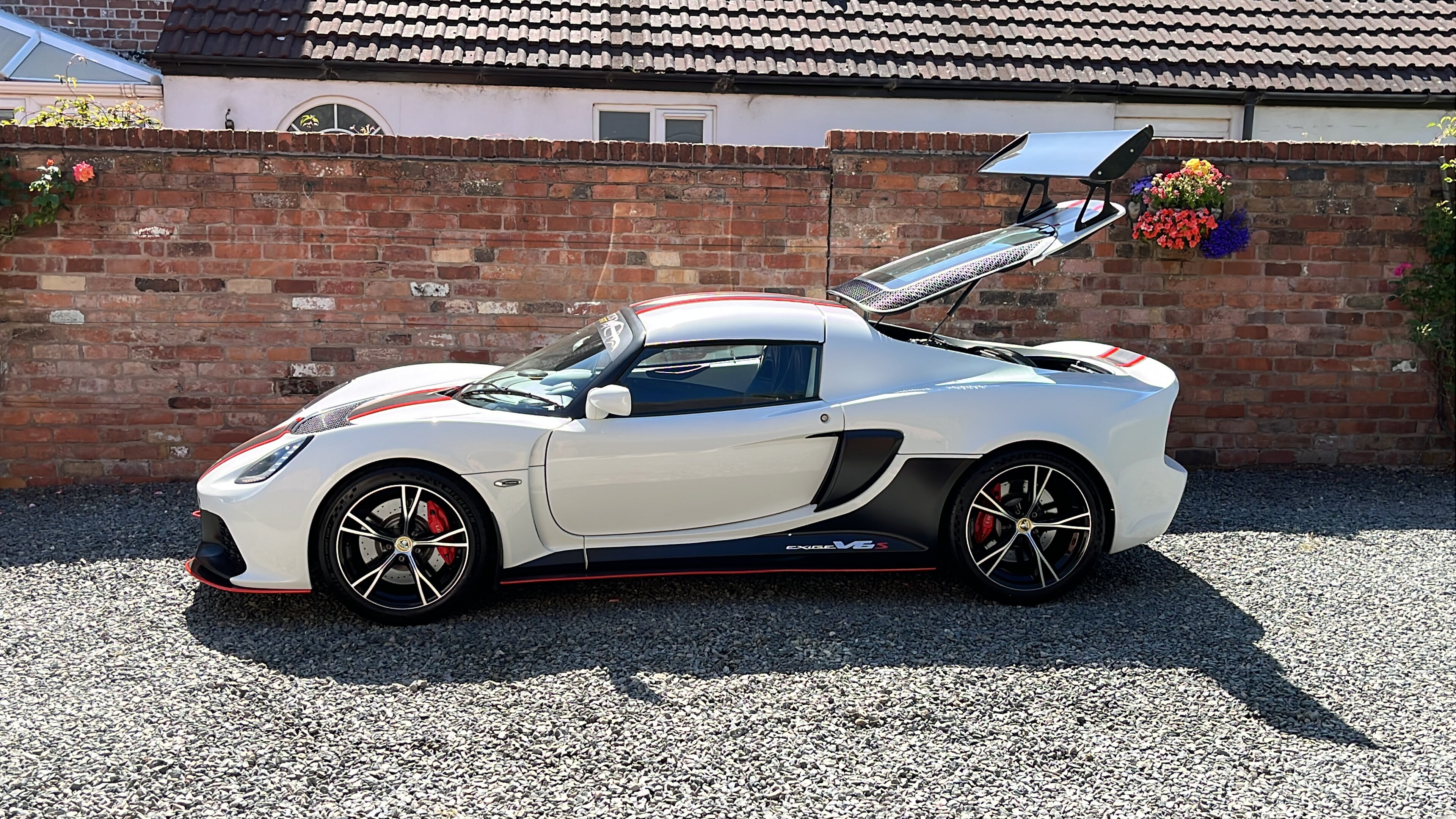

279CB76B-3E22-4398-83E7-BDC60C504016.thumb.jpeg.015c0006b03e45b3671e4814b6748739.jpegI never realised how difficult it would be to get new tyres!!!  As my rears are totally shot, I have got my hands on a set of part worn (hardly used) Cup2 and put them on a spare set of alloys I acquired!!
I quite like the diamond cut alloys vs my black wheels. At least i have bought myself some time to track down some decent tyres. I might even get my black alloys powder coated.
Edited by Guido
