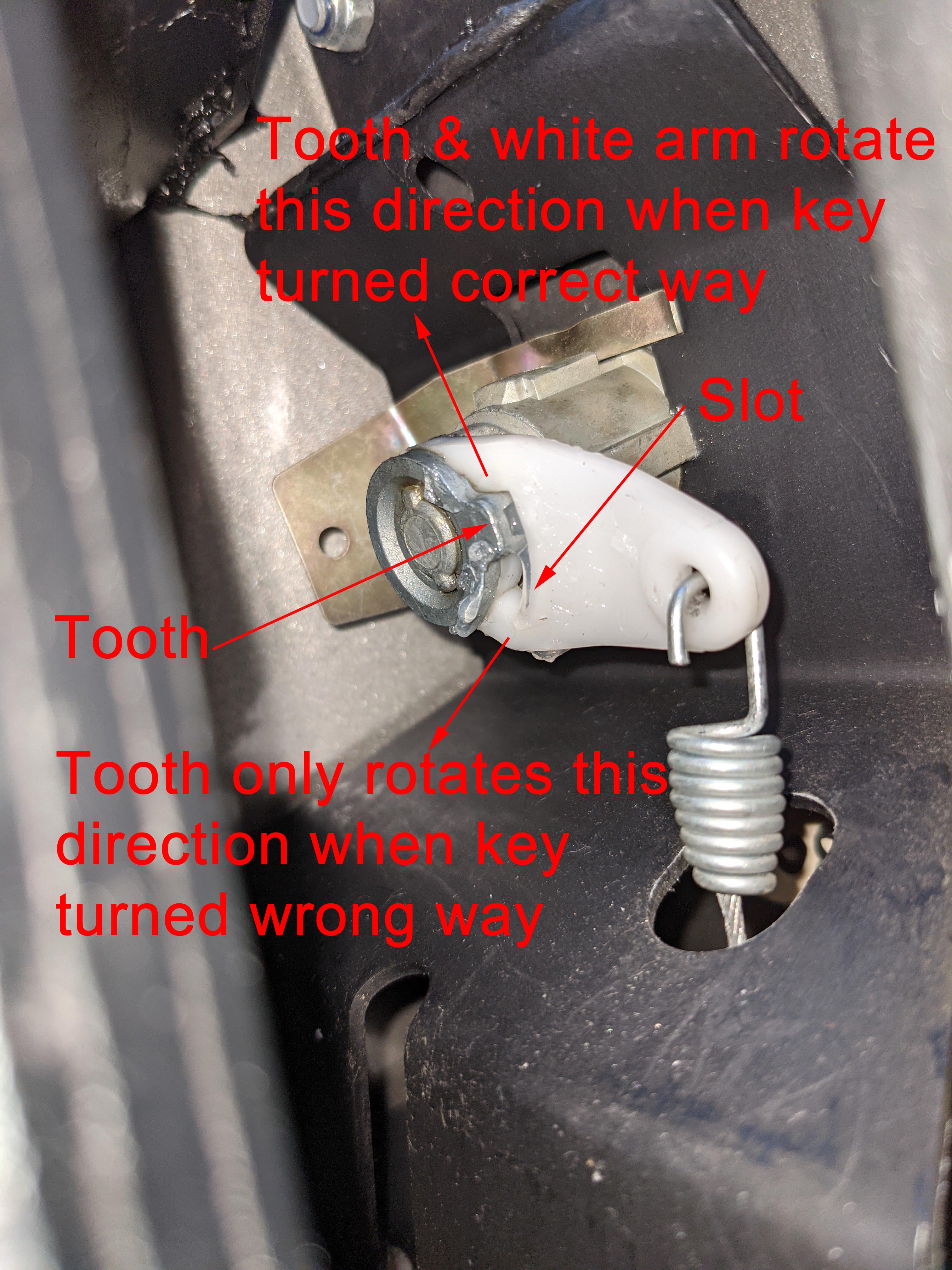

Update:
By looking at how the catch mechanism works on another S2 with the engine cover open (thanks Mike), I eventually worked out how to get mine open.
The spring had come off the white arm at the end of the lock barrel - that's the spring that pulls the short cable connected to the catch release. Having hooked it back on, I managed to get it to come off again by turning the key the wrong way in the lock. It looks like normally that would not rotate the arm - the tooth on the lock barrel moves along the slot in the arm, and the arm shouldn't turn. On mine, the tooth was sticking to the arm and turning it the wrong way towards the spring - which then pushed the spring hook out of the end of the arm.
I cleaned up the slot and worked some silicon grease in there - now the arm won't rotate when the key is turned the wrong way, and the spring is staying put.
Posted
Top job 👍
Thanks for the photo and explanation.  It's always satisfying to work through and resolve these little puzzles. Or in your case  "get yourself out of a sticking situation" 😉
