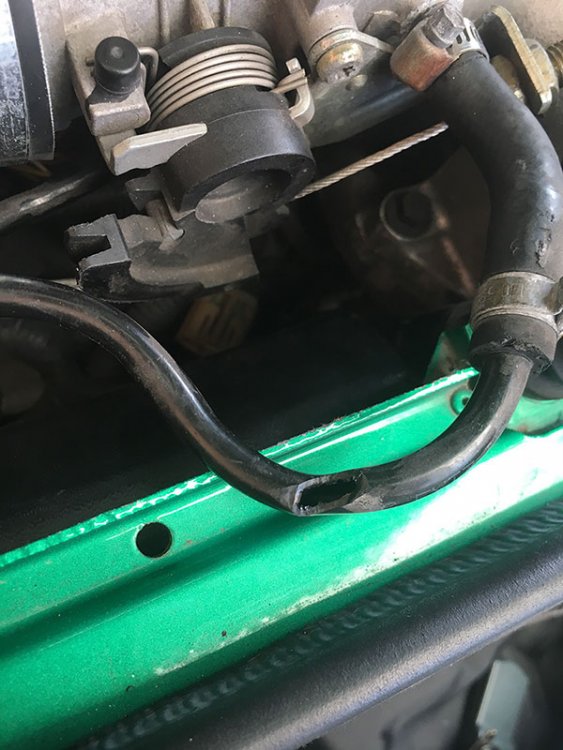

Hi all, this obviously didn't ring a bell with anyone but thought I'd post an update in case anyone comes up against a similar issue in future...
Managed to locate the source of the problem yesterday...
This hose had been rubbing against the side of the engine bay and had worn right through, creating a hole in it which was sucking in air. Must have been doing it for a long time (I've only had the car a few months) but only recently got to the point where it was noticable.
Due to where it was located it was essentially sucking itself to the side of the engine bay at idle (so wasn't making a noise) but under load it was obviously drawing in air through the hole and making the hissing sound.
A bit of tape over the hole has removed the noise completely, so now just need to replace the hose! Relieved it wasn't anything mechanical - now just need to locate the source of the rattle which is still present (must have been unrelated).
I guess it just wouldn't be Lotus-ownership if there wasn't some noise or another to diagnose...
