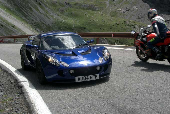

I have have considered selling my Exige because I have had my holiday and toured Europe and Wales this year and I won't get hardly any use out of her untill next year. I like the Idea of next years Euro tour to be in a TVR T350.
So if you want a year old S2 Exige (1st Reg 1/3/04) with 18,000 miles on the clock which would cost £ 36,000 to spec new for £ 26,999.00 Give me a call. Saving of £9,000.00
Magnetic Blue Paint, Full Touring Pack, Air Con, Extra Oil filters as per proformance pack. Removable Momo Steering Wheel, Push Button Start, Aces Change Up Lights, Fitted Fire Ex. Full Lotus Service History. Roof Mod to stop the Ratttle By Nick Whales.
Pics in Garage: http://www.midlandslotus.co.uk/forum/index...CODE=12&CID=136
See Picture taken a couple of Weeks Ago on the Stelvio Pass
