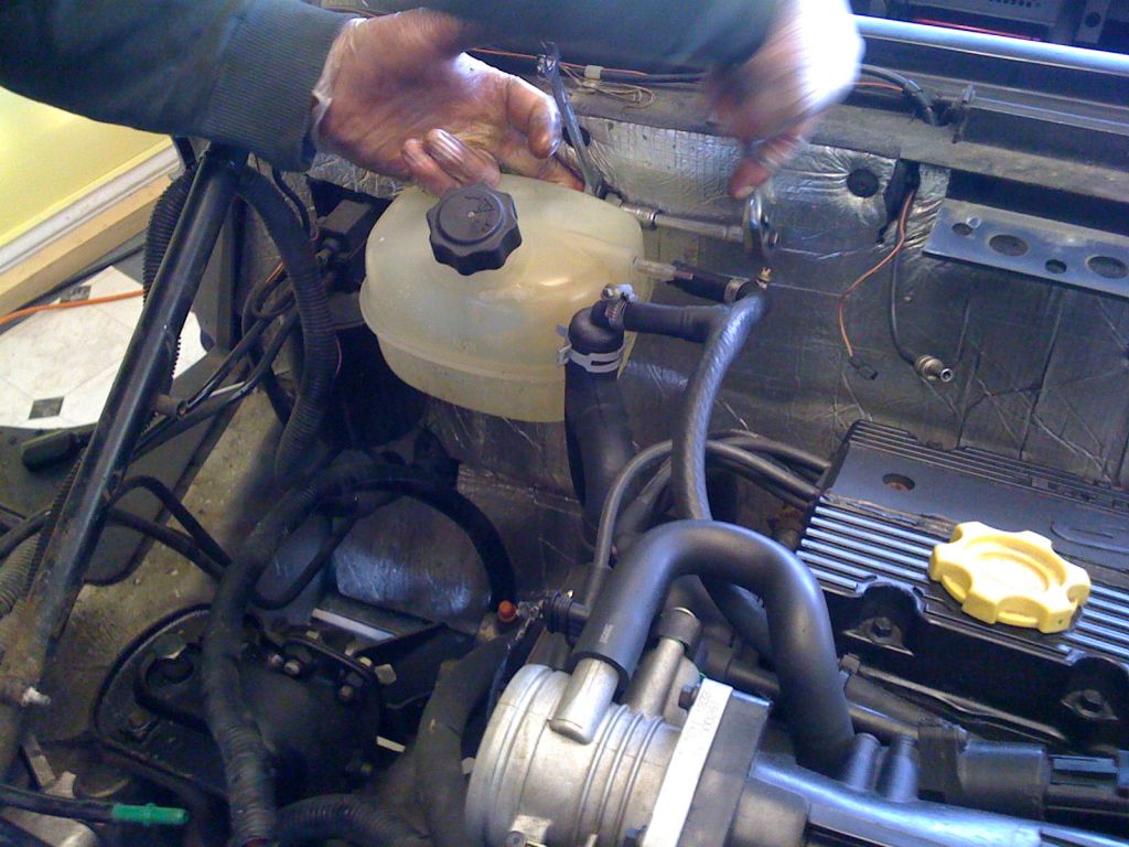

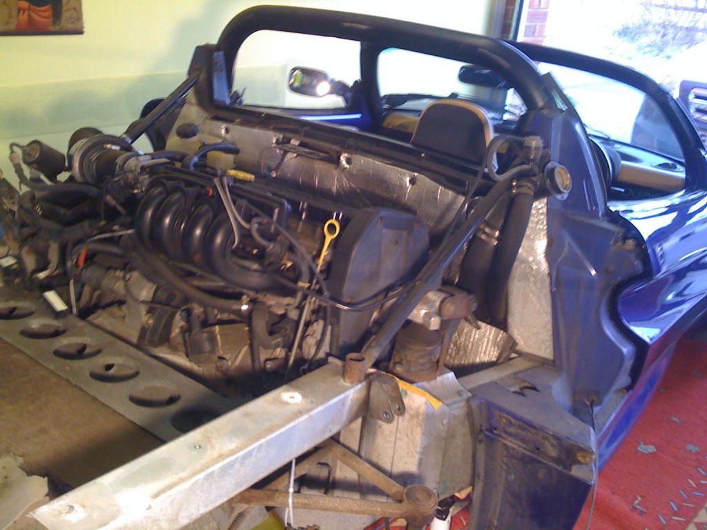

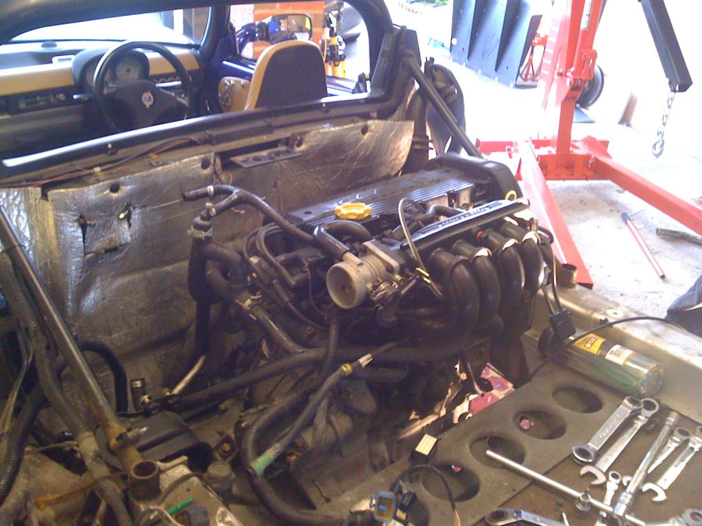

With the engine removal, its all about ensuring that all the pipes and cables are detached.
- We had to un-do the water pipes and drain the system into buckets.
- Clip the fuel line and unplug
- Un-clip the gear linkage
- Removed all the wiring
- Undo all the engine mounts bolts
Tip: Phil suggested that we remove the manifold before lifting to ease the removal

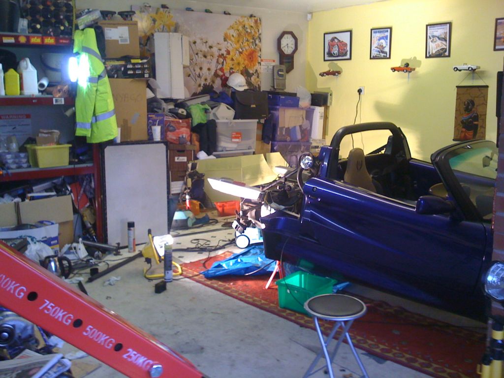

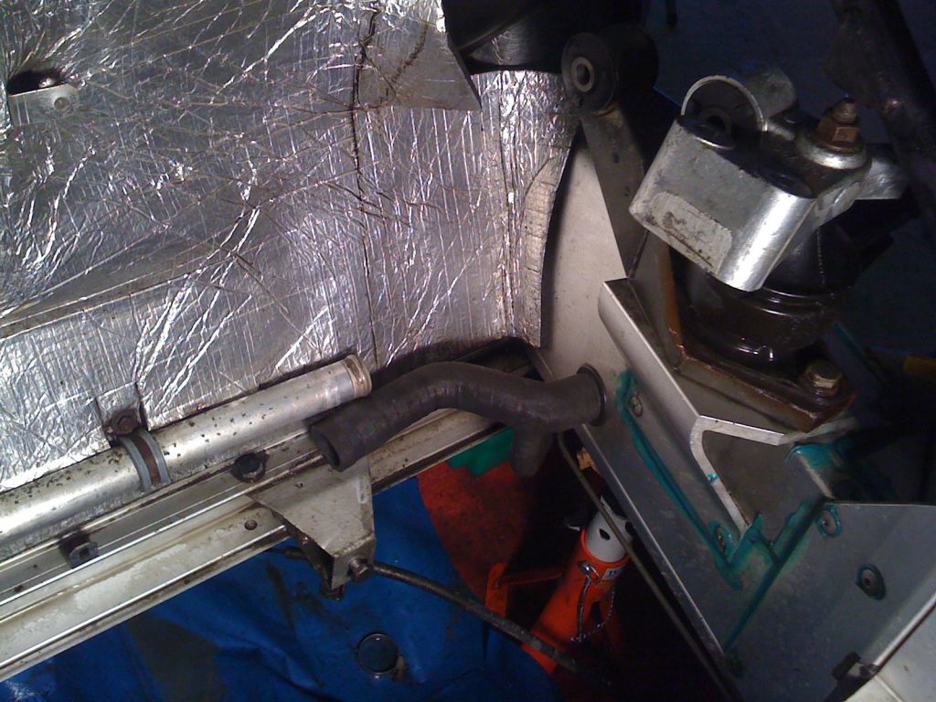

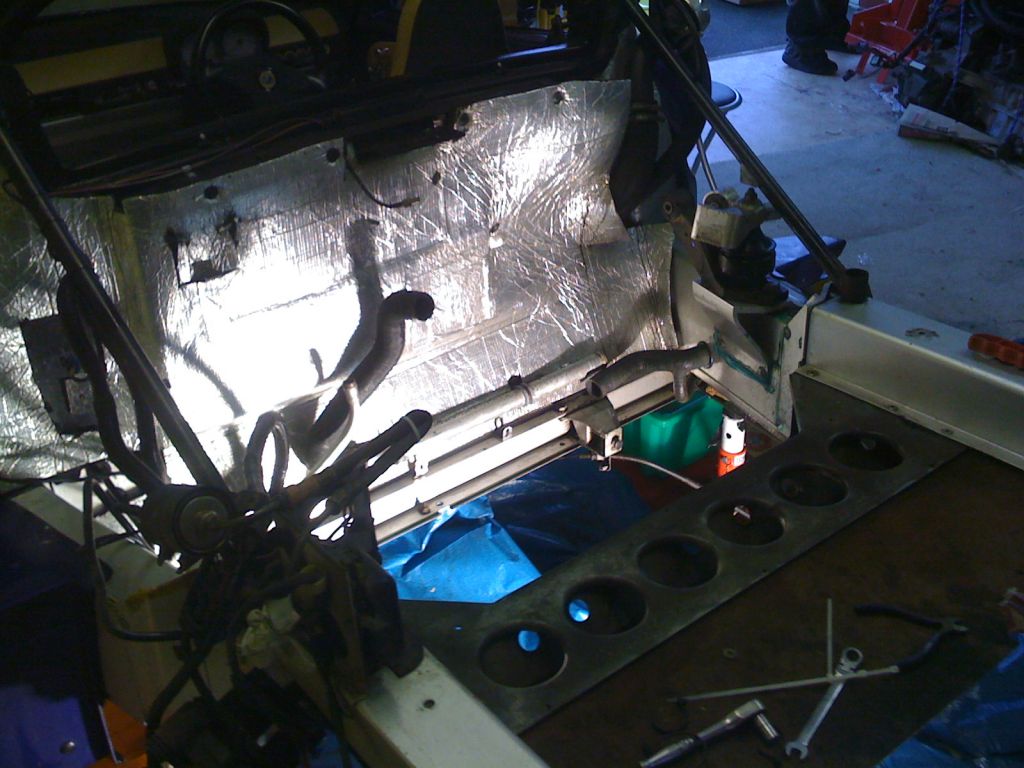

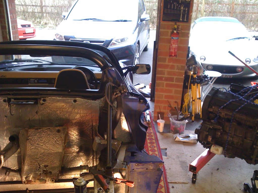

Disconnections...

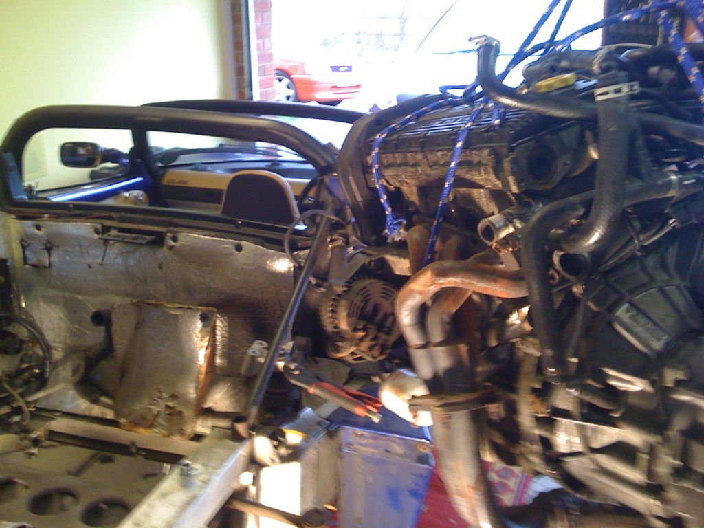

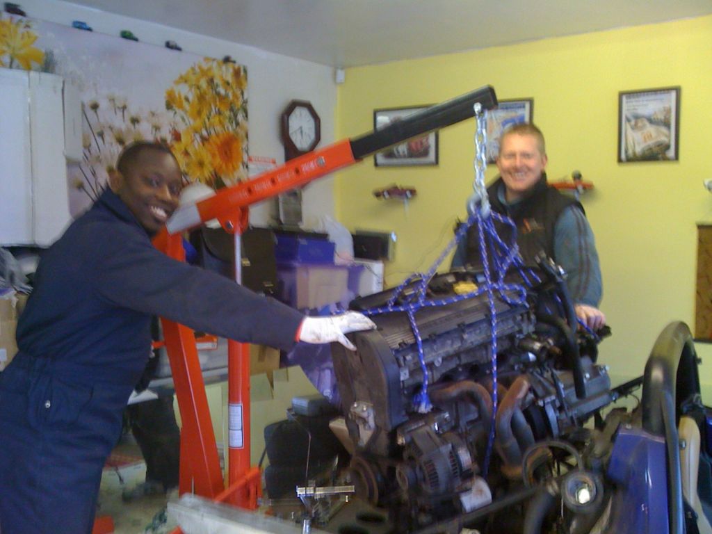

She is ready to go!

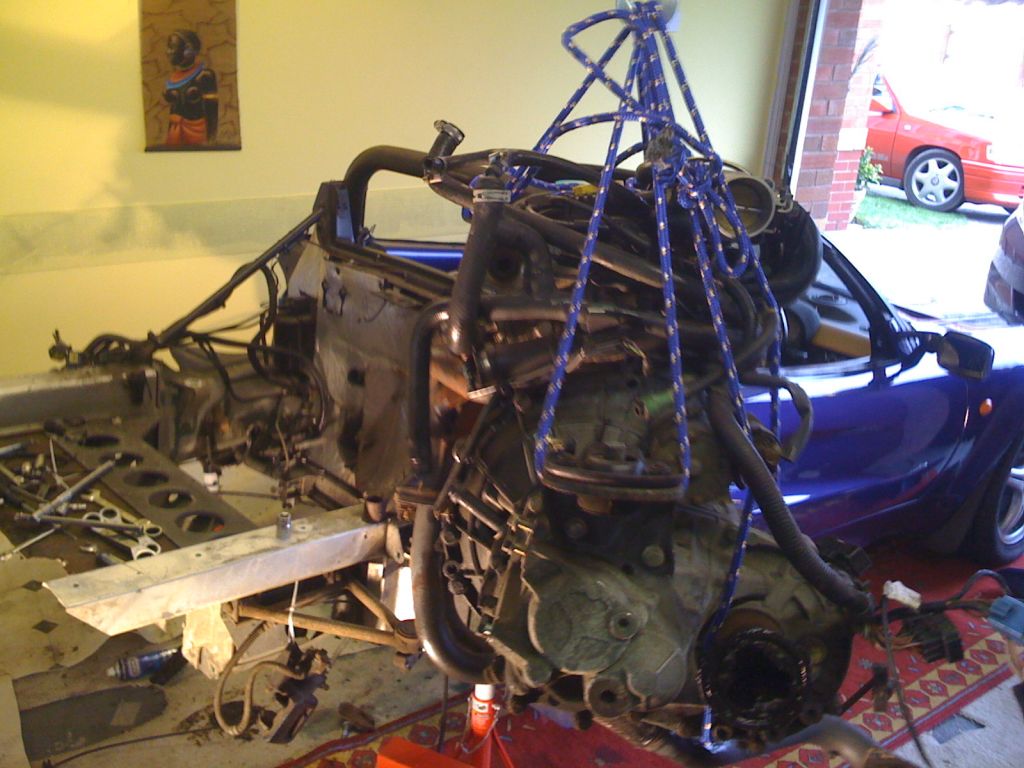

Here she comes...

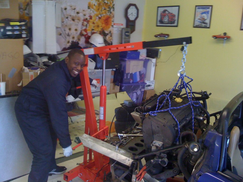

Men at work!

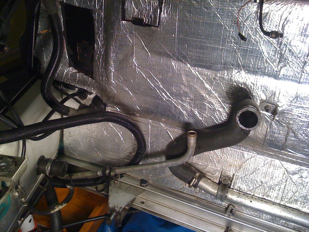

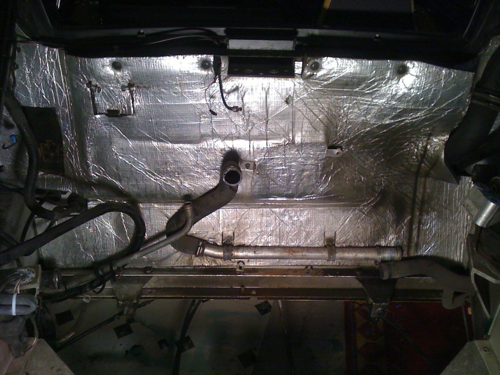

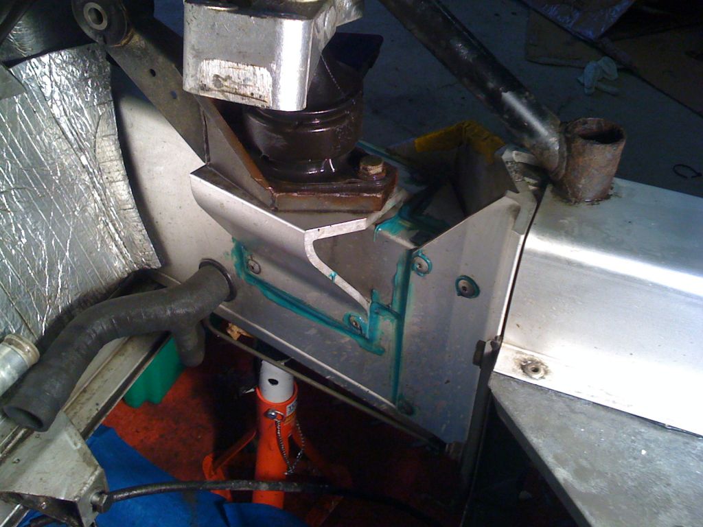

She is clear...

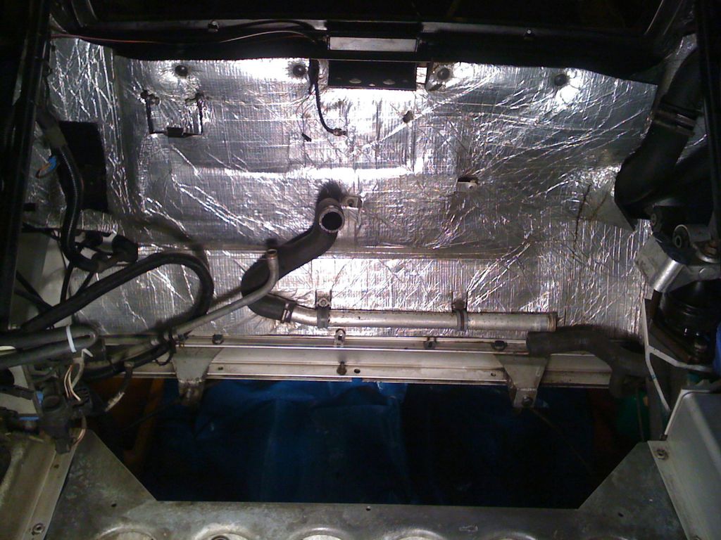

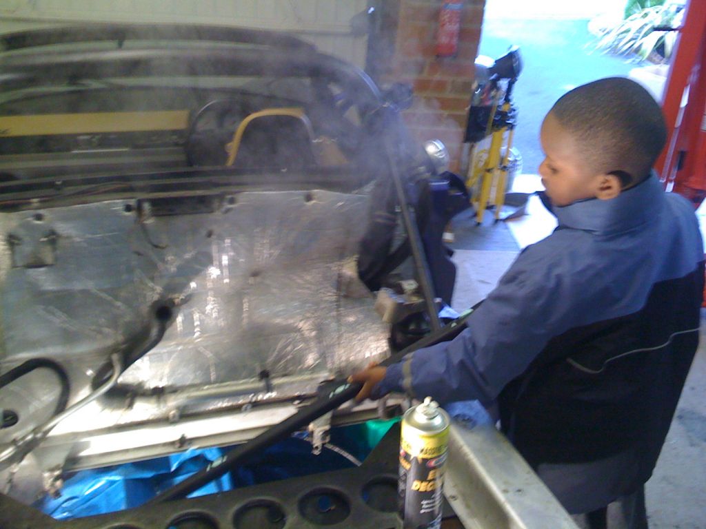

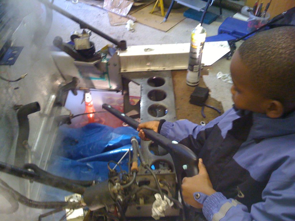

The engine bay is pretty dirty...

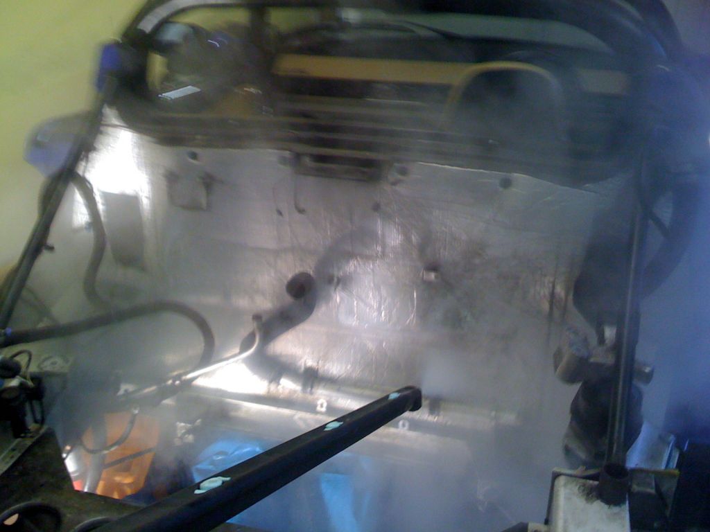

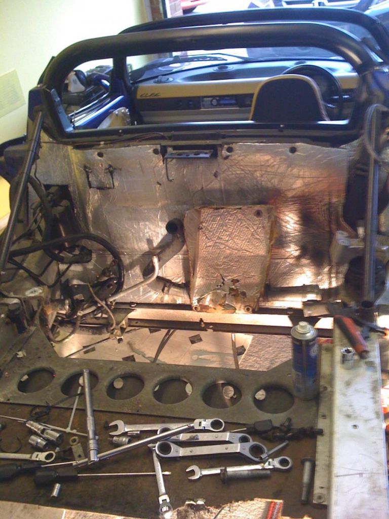

My little boy Reece got hold of the steam cleaner and started working hard! Good to see...
Nice and clean! Good work Son!
Considering that the car is ten years old, she hasn't do too badly.

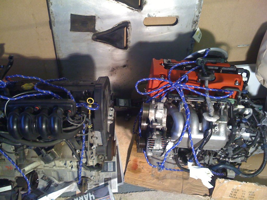

The new and the old!!!
