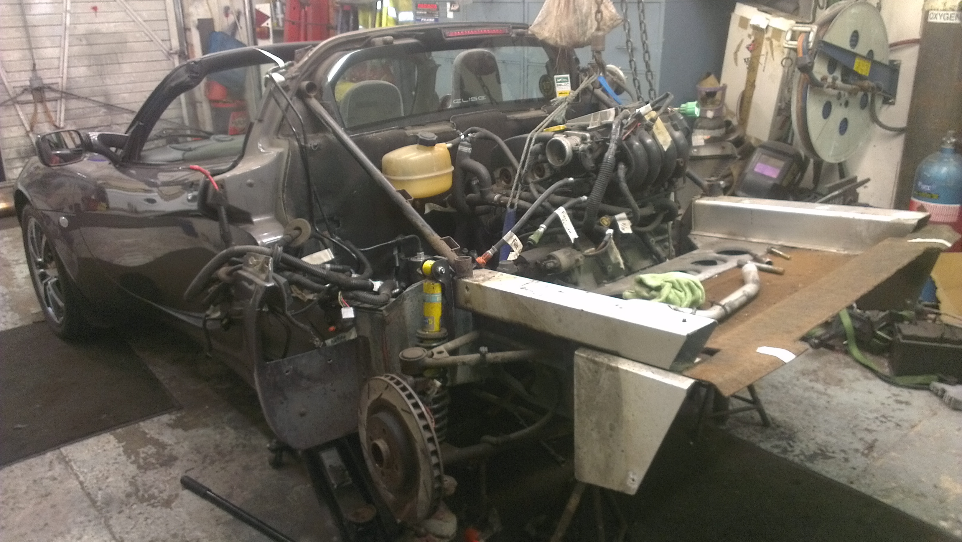

After marking up all of the electrical conections and removing the exhaust, gear shift cables, clutch slave cylinder and throttle cable the engine was finally rready for lifting out, I had a bit of trouble removing the o/s engine mount and the bottom gearbox mount as they were siezed in but luckily a bit of heat from the old oxy/propane soon sorted this smile.png I have a lifting beam in my garage and a 1.5t block and tackle, so lifting the engine out was a doddle!
