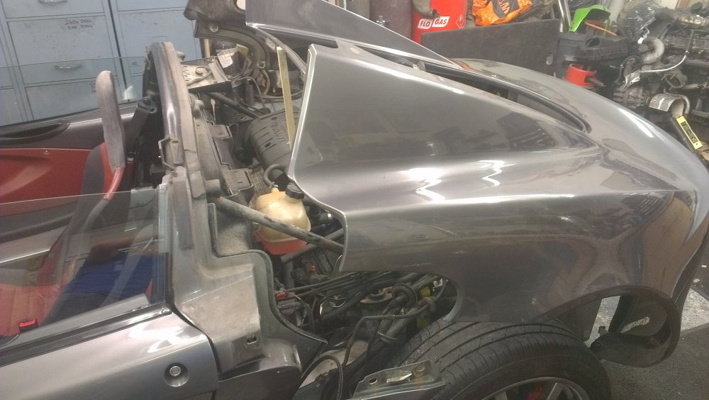

I removed the rear clam, I thought this would be quite a daunting task, but it was real quite straight forward othe than a couple of siezed bolts. I started following the guide on seloc but after 10 mins I soon realised that thier guide was based on a S1 so was'nt all that rellevant. I'm not going to start writing a step by step guide on how to remove the clam as It was over a month ago when I took it off! After taking the clam off I made a start on removing the exhaust then onto disconecting the wiring loom, I used masking tape to label up all of the conections as I came to disconect them. After a short while the engine was ready for lifting out.

Woohoo! And we are off. Keep the updates going.
