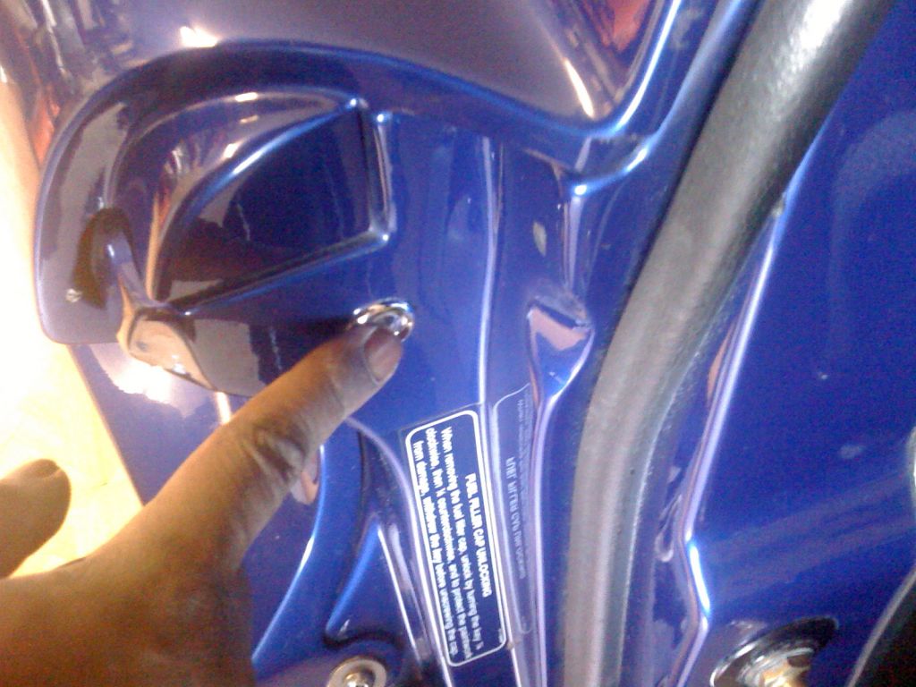

Before I started any work, I had to decide the location of the button. There are several options in this, but the one that I thought to be best for what I was looking to do was to place the button on the door jam on the driver side. This would mean that the button could stay 'hot' at all times, but would require the door to be opened before gaining access.

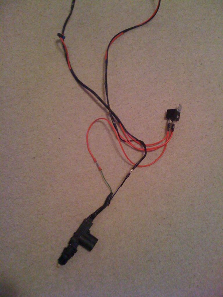

Wiring harness.
This was pretty straight forward as its essentially two circuits, separated by a relay. One for the actuator and the other to the switch.

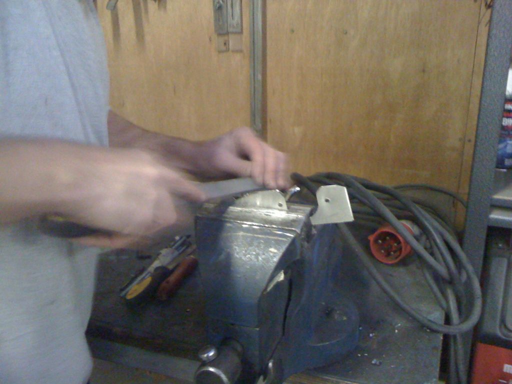

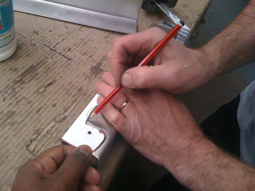

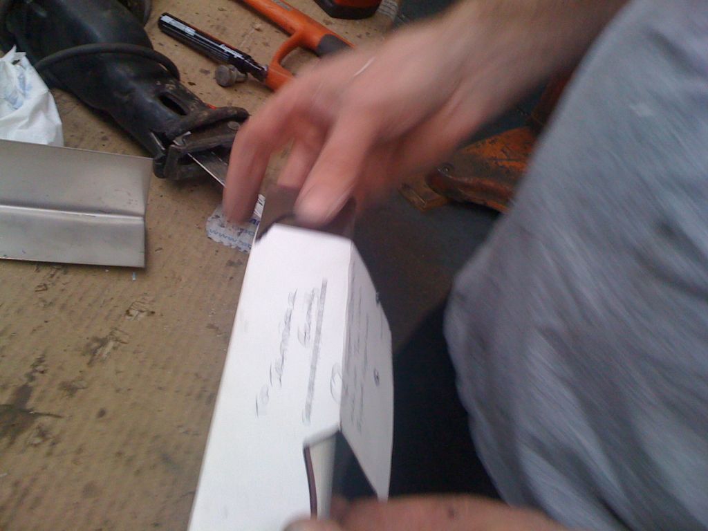

Now, I was initially going to use a bit of aluminium I have in the garage, however after a quick chat with a friend of mine, he was up to helping me out with fashioning something in his workshop.

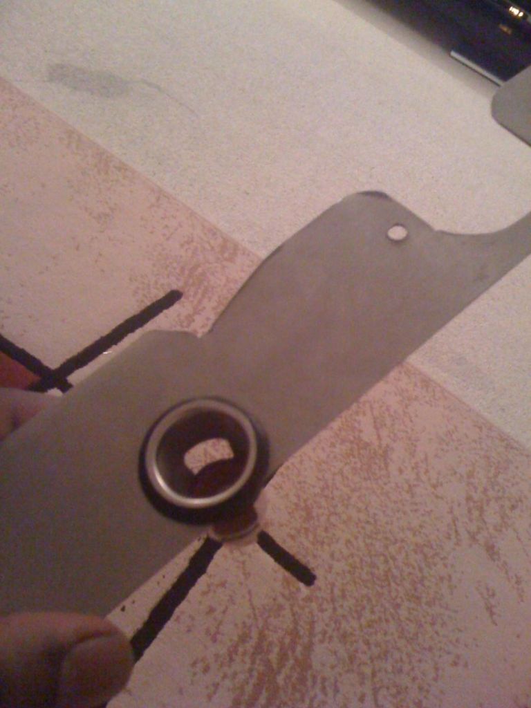

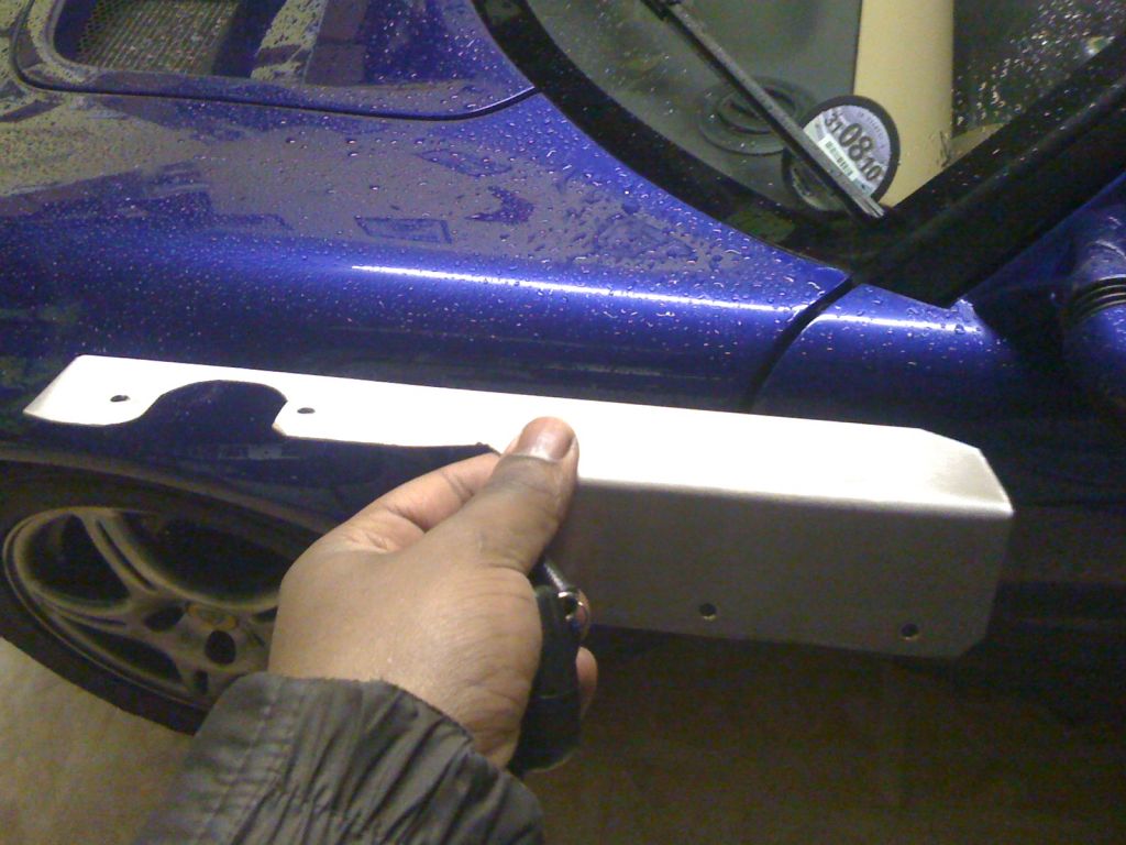

So, by using a Christmas card, I templated my design and measured it up to ensure that the holes and shape worked as I anticipated.
Measuring up against the aluminium...
The making...
I am pretty happy with that!

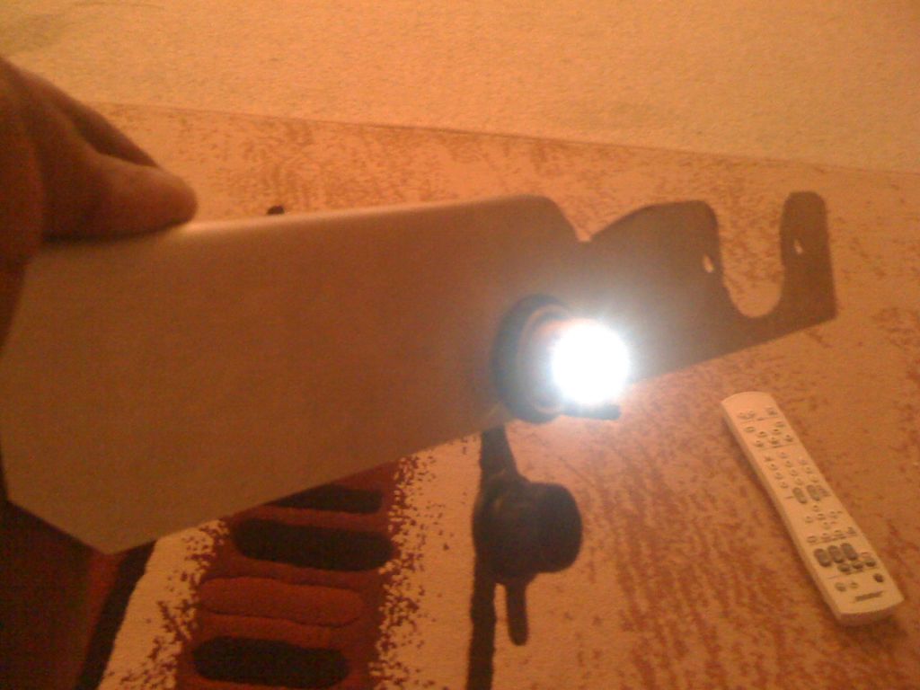

Now, me being me, I couldn't just leave it there. I decided to add a power socket and an LED rechargeable torch for the boot and when you need to see in dark places sad.gif
So...
And...

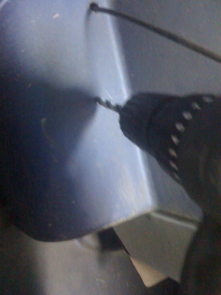

Drill the hole to the boot...

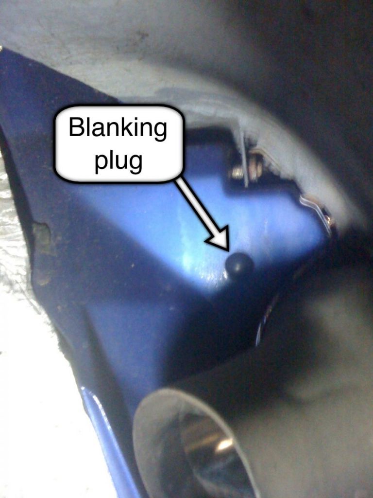

Removed the blanking plug to the cabin...

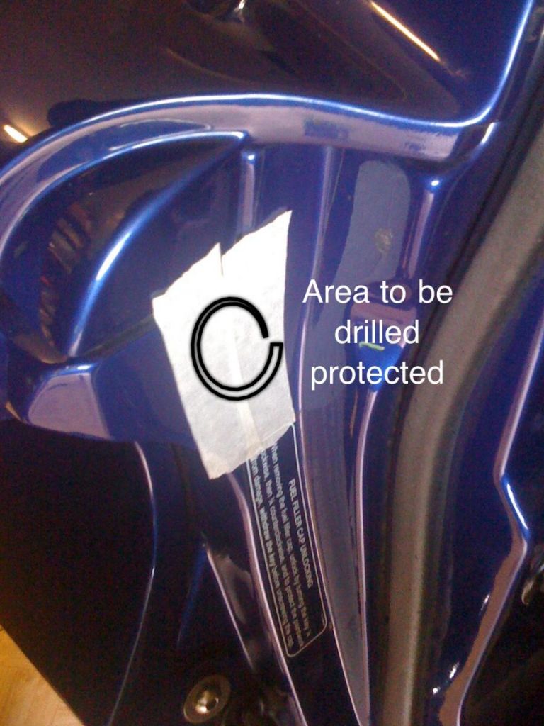

Masked the area to be drilled...

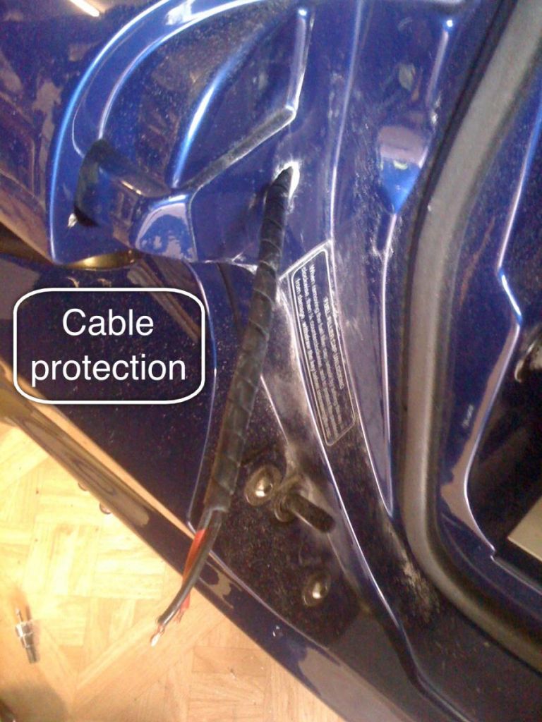

Pushed the cable for the switch through. Note the hard protective cover over the cable.

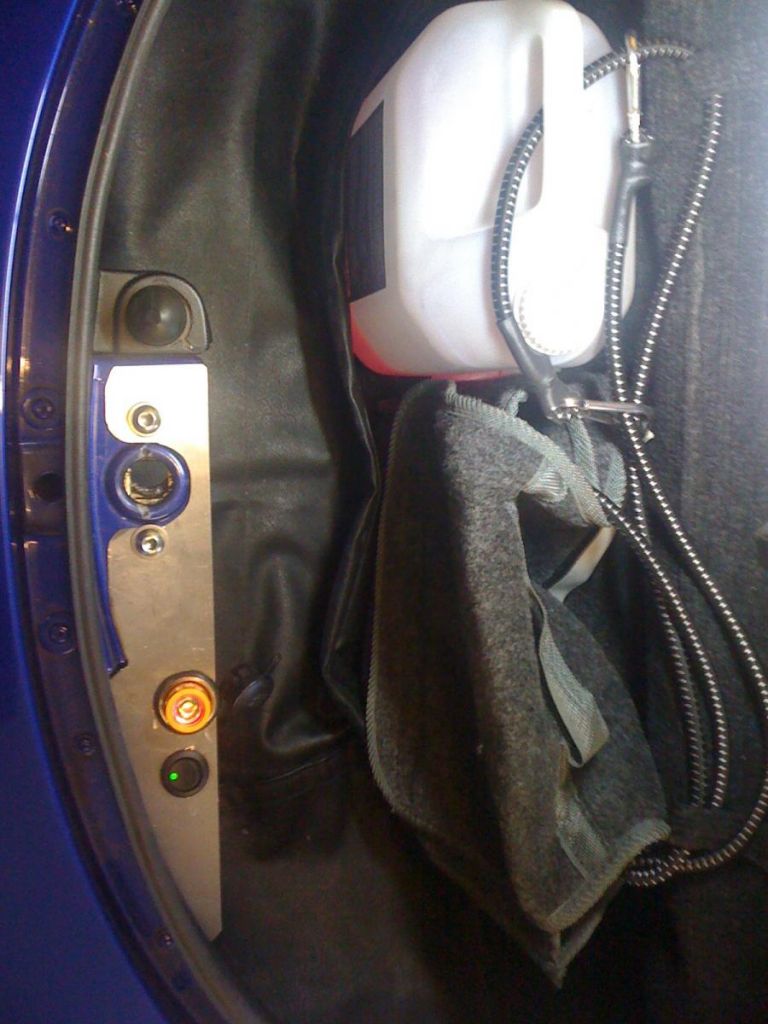

Then installed the setup in the boot, including the isolating switch for the charger. I am quite happy with that.

You can choose to go with a single circuit, activated by a single push switch, however I went with two circuits, one for switching and the other for power supply to the actuator. The two circuits are separated by a relay. It is very straight forward really.
