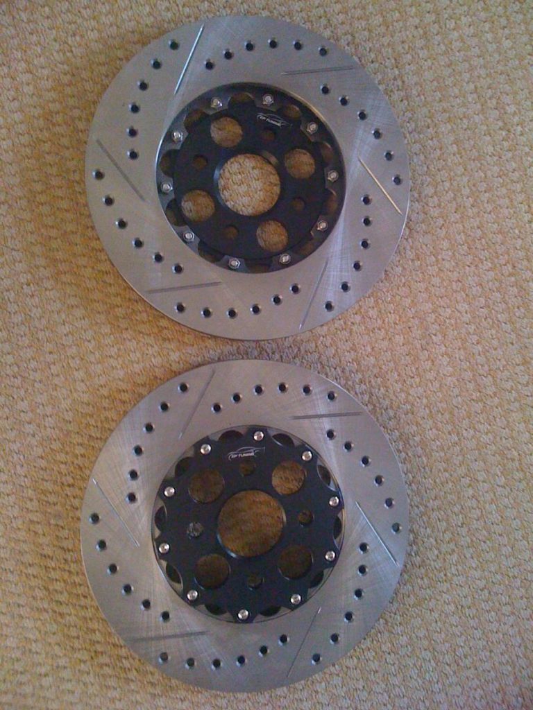

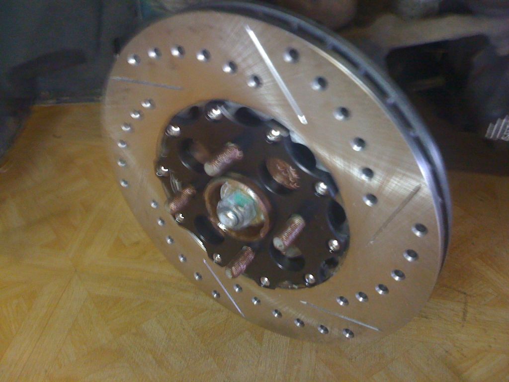

These are the brakes bought. They look pretty nice - as brake discs go.

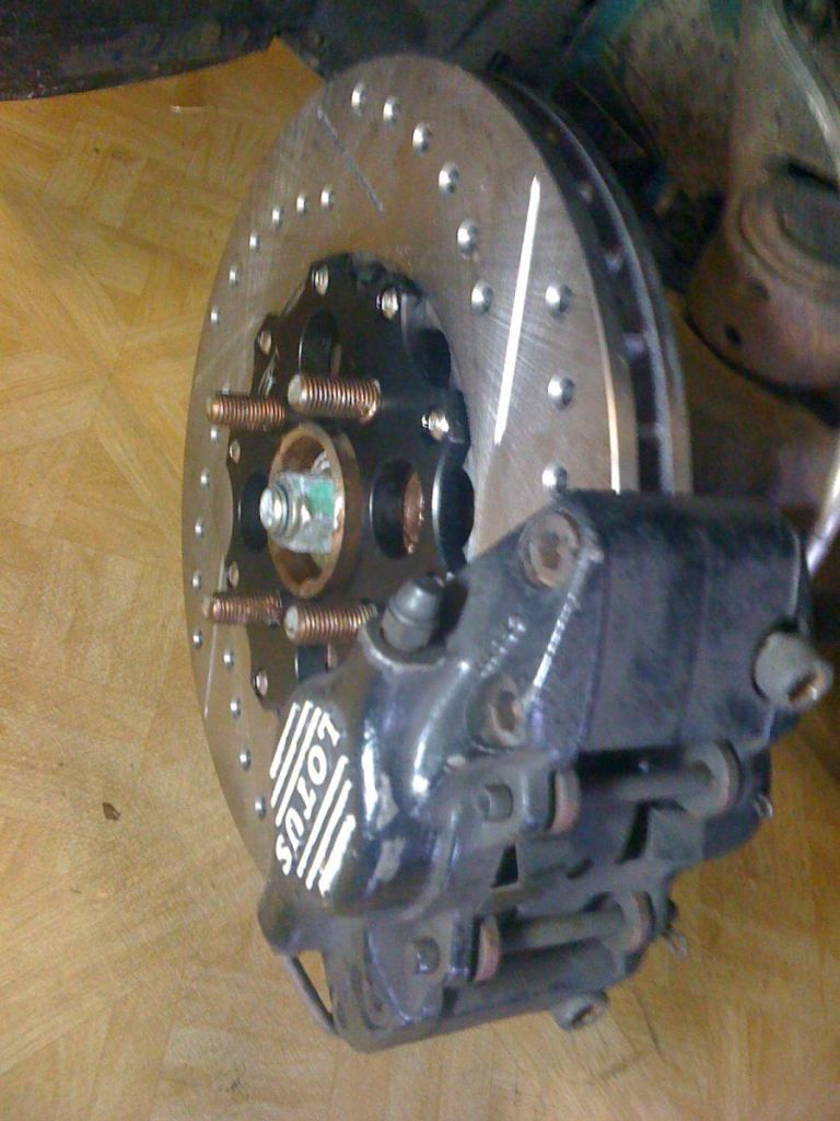

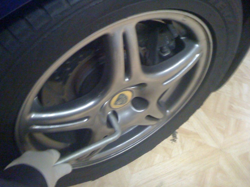

Go the car jacked up and removed the wheel...

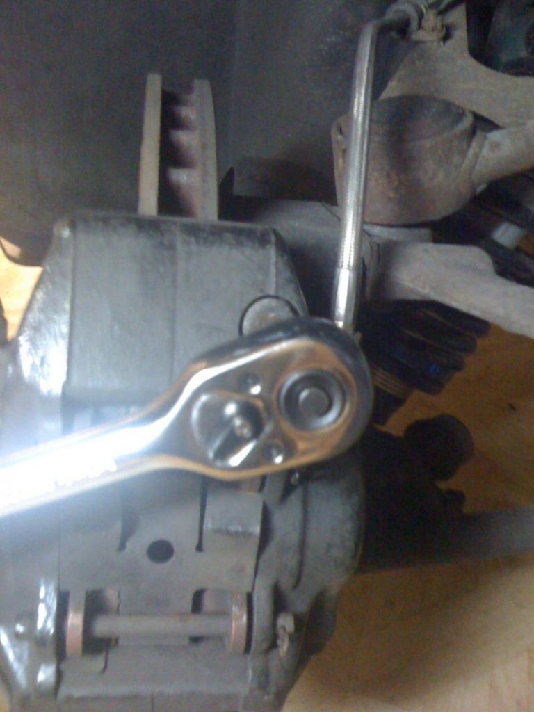

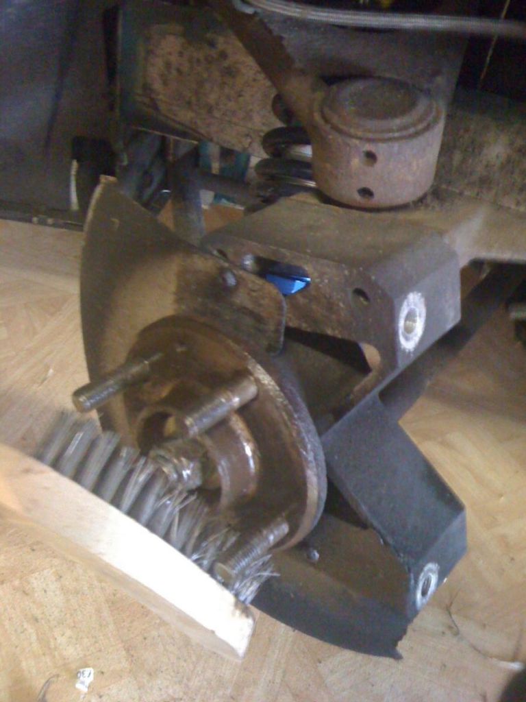

I then removed brake calliper of the hub. Just to Alan key headed bolts and done...

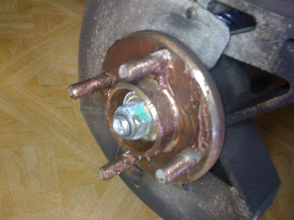

Cleaned up the wheel hub with a wire brush and some degreaser...

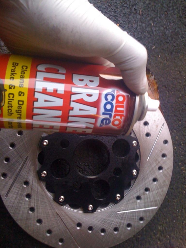

Cleaned up the discs with some brake disc cleaner ( a pound from pound land :( )
Good amount of copper grease on the hub...

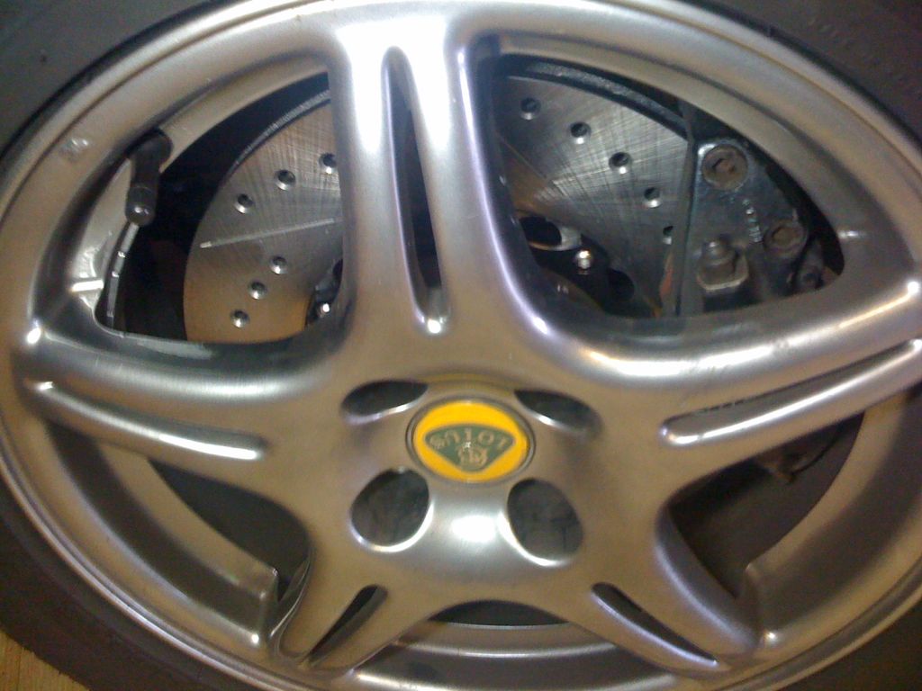

Nice shiny brakes on. Make sure that the disc goes all the way in. A rubber mallet is very effective in tapping into place...
Calliper back on, with the two bolts back on. I used a bit of thread lock for extra safety...
Looking good.
I repeated the process on the other side. I am happy with that, but will have to wait for some dry weather before getting them bedded in properly.
