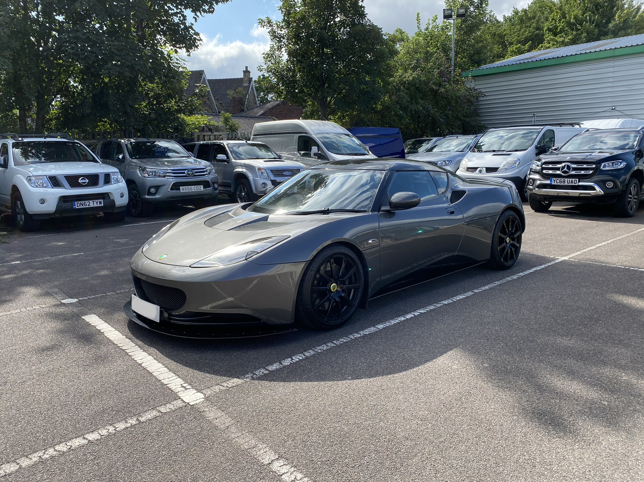

jimn Posted January 12, 2022 Share Posted January 12, 2022 I made some out of dibond. I don’t know if that’s what you are looking for and without digging out the invoice I can’t remember exactly how much they cost but it was definitely a fraction of what the cost to buy. (here’s a bad pic with a silly splitter I made while I was at it) Link to comment Share on other sites More sharing options...

Weekend Warrior Posted January 14, 2022 Author Share Posted January 14, 2022 On 12/01/2022 at 01:10, jimn said: I made some out of dibond. I don’t know if that’s what you are looking for and without digging out the invoice I can’t remember exactly how much they cost but it was definitely a fraction of what the cost to buy. (here’s a bad pic with a silly splitter I made while I was at it) That looks quite good 👍,do you have any other pictures ? Id be interested to know roughly how much it cost ,also how you went about making a template and finally how you fited them to the car . Thanks Steve Link to comment Share on other sites More sharing options...
jimn Posted January 14, 2022 Share Posted January 14, 2022 3 minutes ago, Weekend Warrior said: That looks quite good 👍,do you have any other pictures ? Id be interested to know roughly how much it cost ,also how you went about making a template and finally how you fited them to the car . Thanks Steve I’ve just had a look £43.50 plus £14 shipping for 2 pieces of black dibond from “G J Plastics” (1840 x 260) I then bought some speakers spikes the same thread as some of the bolts under the sill and put the spikes in, offered the board up where I thought it needed to be and pushed to mark the holes I needed to drill.. I actually took them off before trimming or final positioning as I didn’t think they worked with the splitter I was making but I’m sure you can have a go for £50.. (I can’t remember the thread size but the speaker spikes are like this): https://www.ebay.co.uk/itm/4-x-Speaker-spikes-steel-isolation-M8-thread-42mm-black-plated-/261490880632?mkcid=16&mkevt=1&_trksid=p2349624.m46890.l49286&mkrid=710-127635-2958-0 Link to comment Share on other sites More sharing options...
