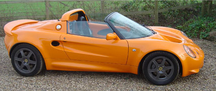

ur right Dunc, Black wheels look ace , I just wish I'd had the balls to go for an orange one like in ur picture - looks bloody great I think............... :P

Cheers Buddy,
Would like to see a pic when you get them done.

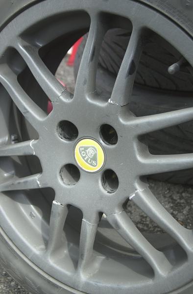

Hmm, some dodgy reports on SELOC about getting them done, Liam has had several crack on the car (on track even!!)
So be sure to get them done somewhere reputable if you are going to do it.

Powder coating can lead to failure if done incorrectly, the length of time at a certain temperature is only a small part of the story, the fact it gets there is more important. It is possible to do it properly but the temperatures used are quite low relatively, the average powder coating place can't do it properly, look for a proper wheel refurbisher or similar.
This is what happened to Liams wheel during a trackday in France, this was the 2nd or 3rd one to go.
