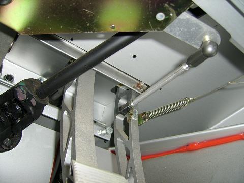

Some sort of connector that attacheds the thing that attaches the lever bar to the throttle pedal broke and now slides up and down making it impossible to control the throttle. Unfortunately I cleaned it out and can't see what actually held it together - is it a nut and bolt or a pop rivet? Could someone take a look for me? It's not in the S2 technical manual dagnnamit!

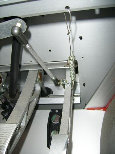

Hope these pics help Rob.
If not let me know and I will get more if you tell me where you need more detail.
Carl

Cheers Mark & Carl - it's that damn rivet! it's gonna be hard to replace. I don't think a standard length one will do it....
