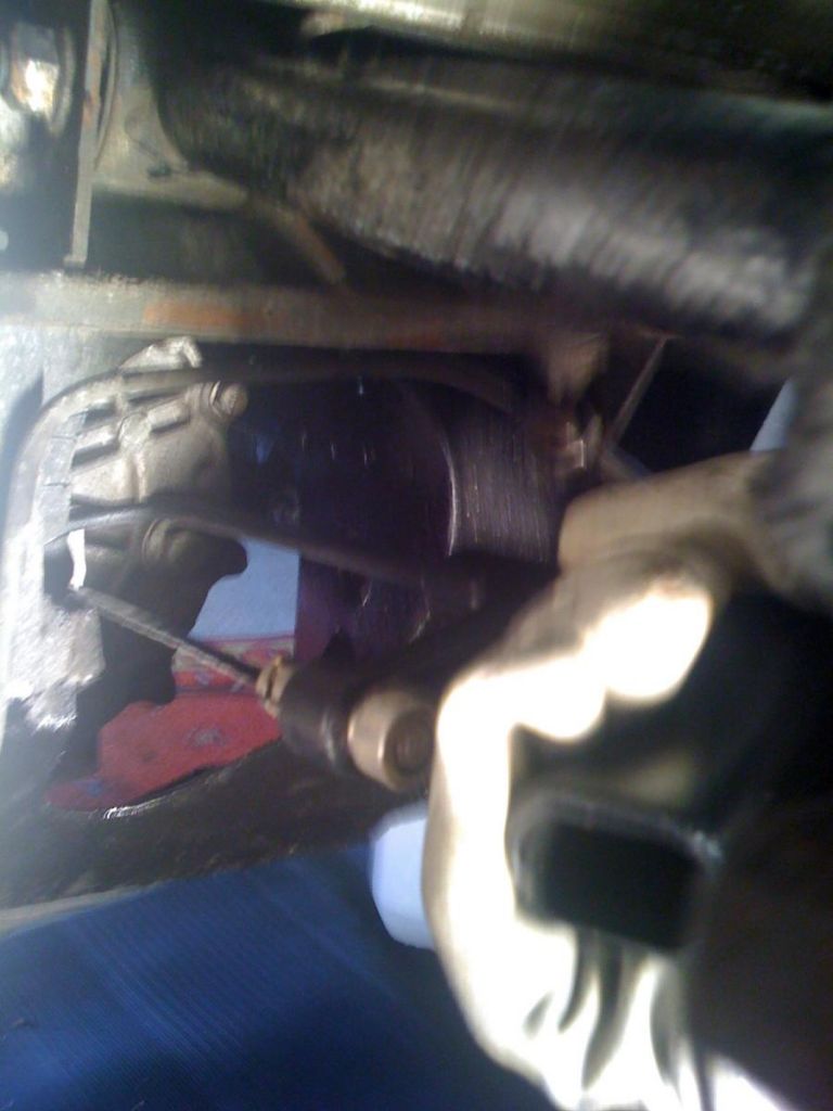

Firstly, I cut a series of cuts a long the area required to be removed...
It should be noted that the reason that I did this was because I did not really want to use a Dremmel on it. If you do, it would be just a matter of cutting out the section as you would expect.

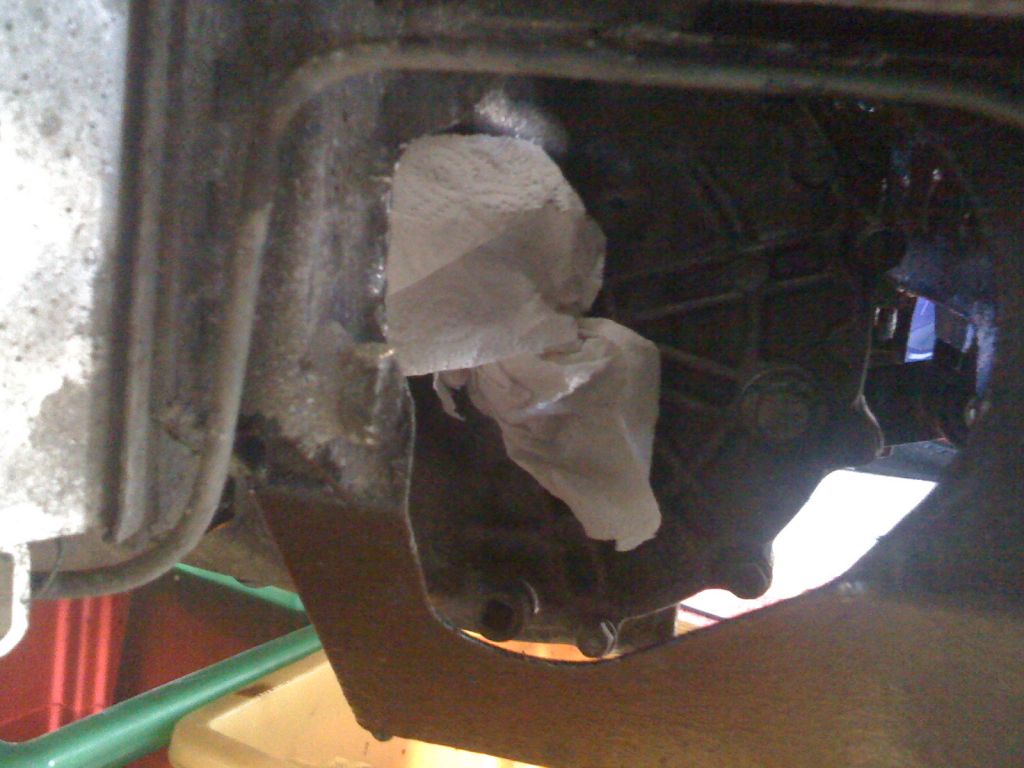

With my method, once I had a number of slits, I then used a pair of players to bend them back and forth until they broke off. Once this was done, I used a file to smooth out the area...
As simple as that. Job done! :D
